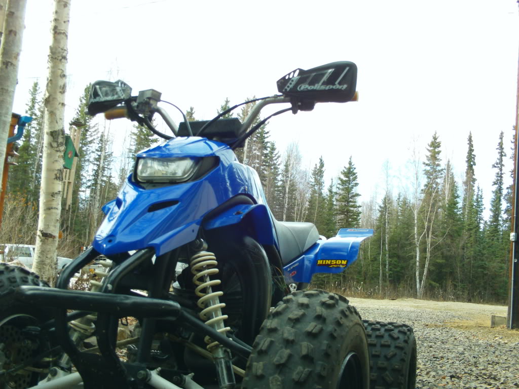

I got the FMF gold Series pipe off this project blaster..and its a bit rusted up... its more then likely a stupid question... but can i get the rust off and get it either shiny again.. or even better since im going to make this blaster black base... could i repaint the exhaust with some sort of high heat safe black paint to black it out???
