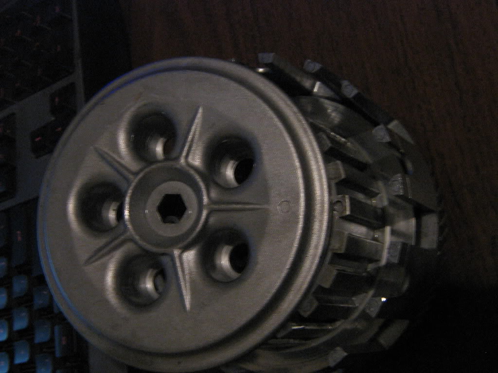

alright found these directions from quicker than you, will try tomorrow morning after work:
1. loosen the outer center nut on the pressure plate almost all the way off
2. hold the clutch lever (the part that the cable hooks onto in the motor) and gently push it towards the front of your bike to relieve the spring tension
3. Now with a small phillips turn the center shaft in which ever direction it takes to align the pointer marks up as you are applying a little pressure to lever shouldn't take many turns you will feel it move. [usually clockwise]
4. When it is aligned, let the lever go it will go off the arrow due to spring tension that's ok. Keep your screw driver on there and take your wrench 10mm and tighten the center nut down snug while holding the center rod tight so it doesn't move. (I used blue locktight also)
5. Now take a socket and tighten it down good but becareful you dont overtighten it and snap it just a good snug tight is perfect. 5 ft lbs is what the manual says. 6. Put the cover back on, make sure your spring for the kick gear is in the hole when you do this or you'll be replacing some more parts down the road (experience talking here!).
7. attach the cable back up and adjust that just until you feel the springs on the pressure plate start to hit, then back off 1/8 turn and try that, ya may need to play with the adjustment on the handle bar lever as it warms up.
