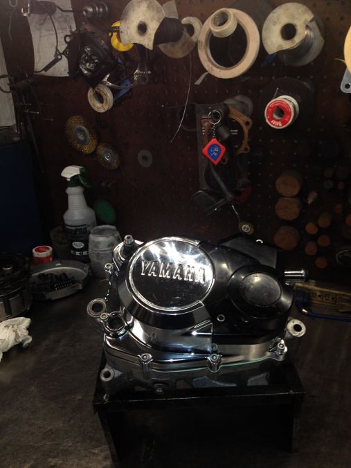

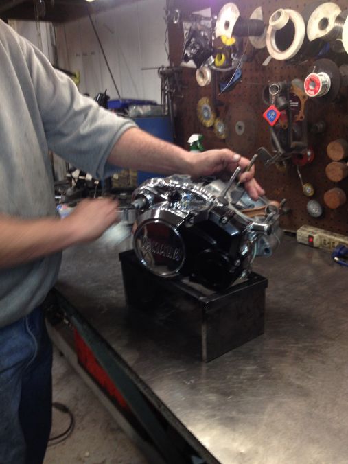

look what i got texted to me today :)
someone working on a shiny azz blastersaurus bottom end ???
