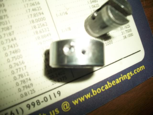

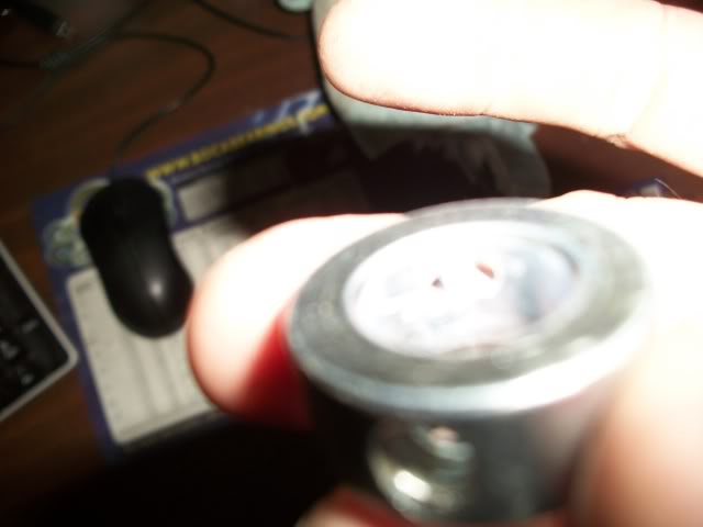

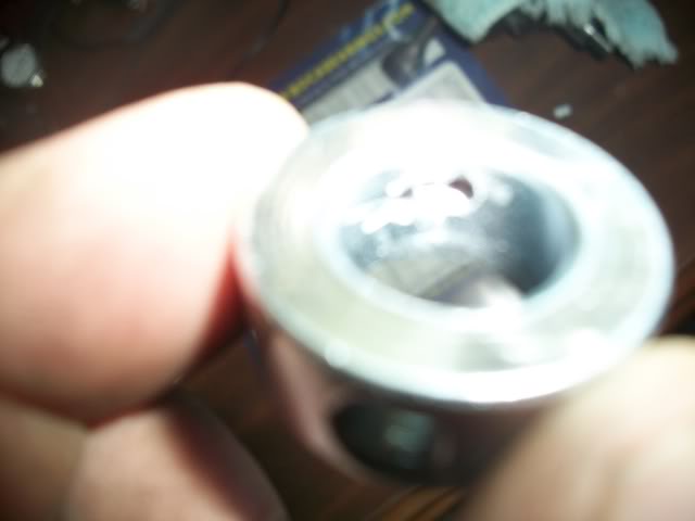

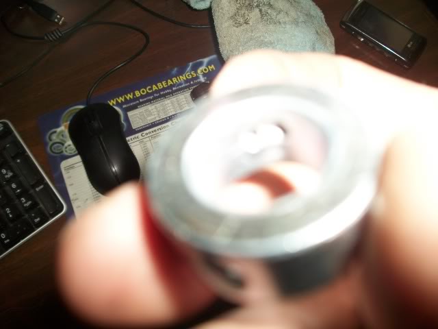

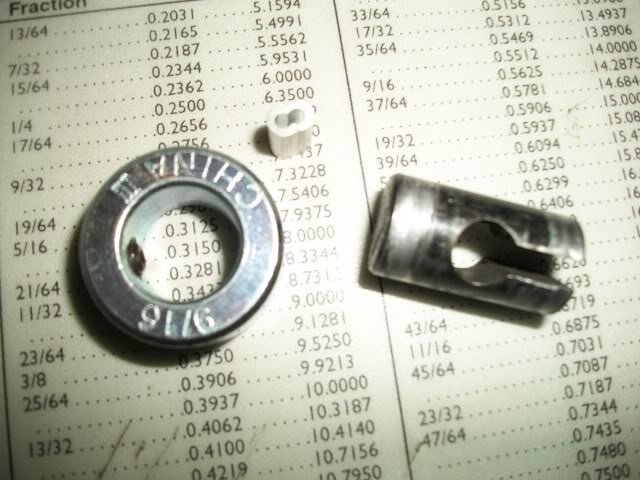

Well. I went to the local hardware store and got a 1/2 i,d collar and drilled some wholes in it for the cable.
I cut the cable long and ran it thru and used a pincher for the cable.
I also bought (i forget the exact name) a collar type bolt for the pivot area.
Now, you want to turn the adjustment for the rear brake all the way in, as to make sure if you dont get it right, you can use that adjustment to tighten it up and work right, cable tenstion.
here are a few pictures. i will post more for you.
I first was gonna use the orginal piece, but realized it would not work.
