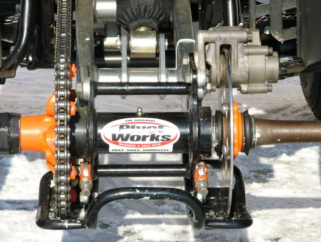

does anyone see a problem with me drilling some holes in the bearing spacer, that the axle goes thru, to allow grease to get in there, to keep water out, i just received my new bearings and seals today, and added a grease fitting to the axle carrier, and remember reading that you should remove the inner bearing seal to allow the grease from the zerk to get into the bearing from inside, but it looks like this spacer may limit this, so had a brainfart to drill some holes in it??? good idea or not????
The spacer rides against the inner bearing race. So when you drill for the grease zerk it will just go into the bearing if you pull out the inner seals. Works good.

The largest damage to the bearings is water getting in, so the largest help of the grease fitting is pushing any water out.
If you only ride in dry areas, I wouldn't bother with the grease fitting. Save the mess of a pound of grease in the tube.
New seals and bearings will last several years even in the wet. I really like the idea of greasing the swingarm pivots however.

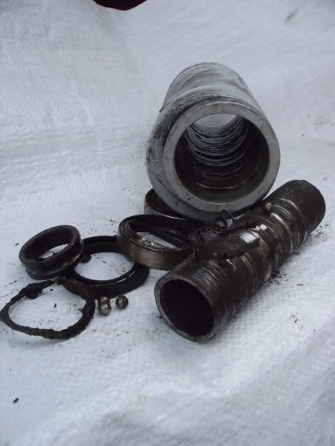

This baby was noisy and was packed full of grease, it was amongrel to take apart because the balls were jamming the tube.
Replace yours before they explode.
