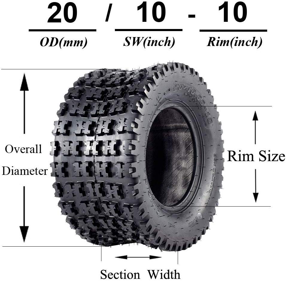

These set me back about $93 for the pair and were shipped to my door in about three days from Amazon.
Let me start off by saying they were a pain to seat the bead.
The first tire I had to spray brake cleaner inside the tire, around the bead, light it on fire, and then keep spraying until there was enough gas inside the tire to seat the bead.
The second tire I just manhandled and used my air gun with the trigger taped.
First impressions, I like the tread pattern a lot. The tread goes all the way around the tire and tapers slightly into the sidewall, so you got a lot of mechanical grip regardless of how tipped over you are.
Also, they list the metric equivalent size on the tire (not that it's that important).
These are also 4-Ply, so they seem fairly strong.
