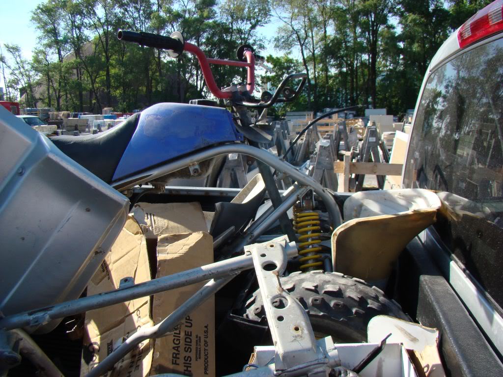

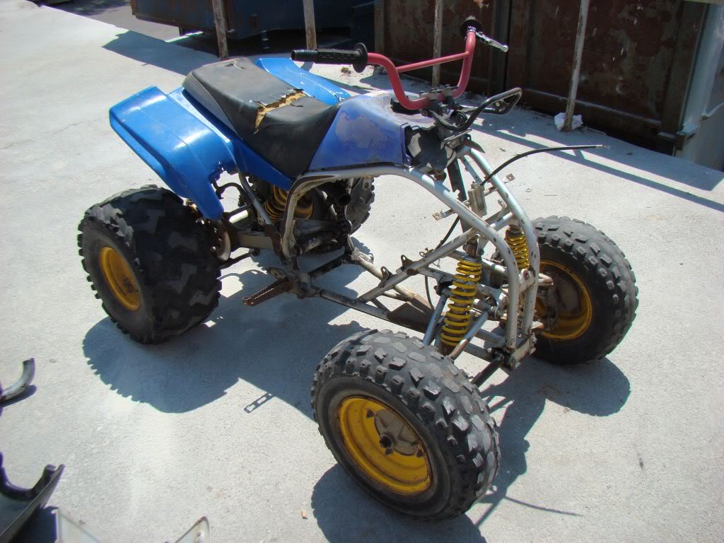

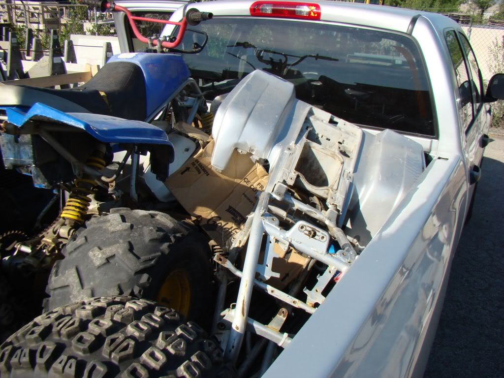

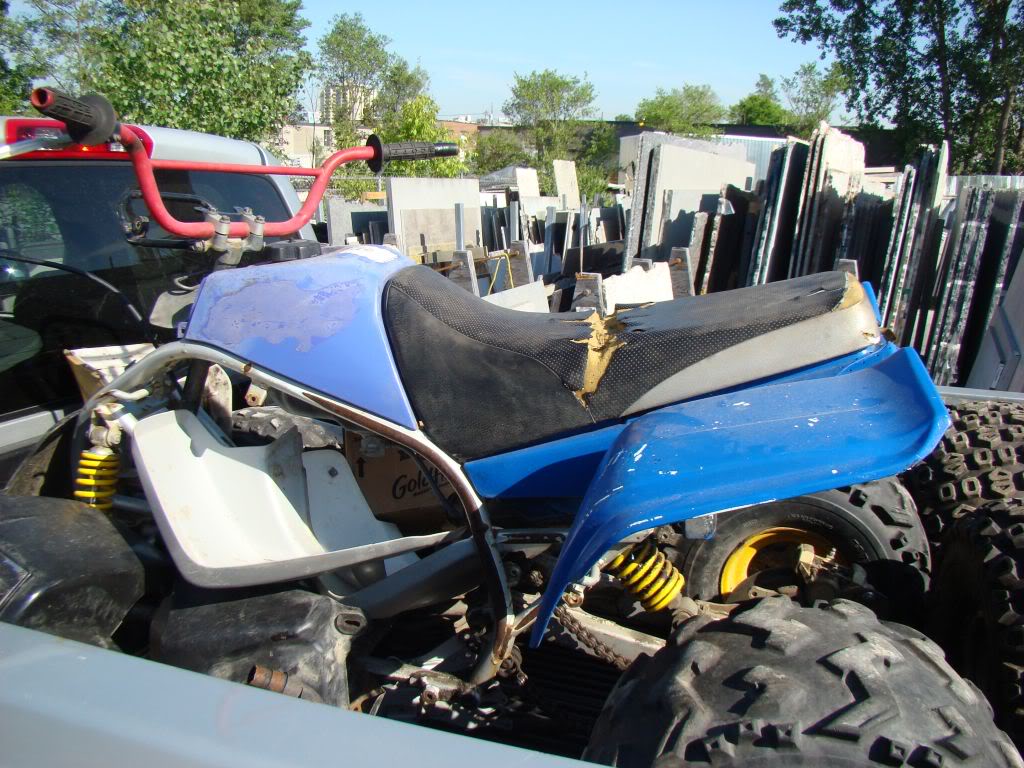

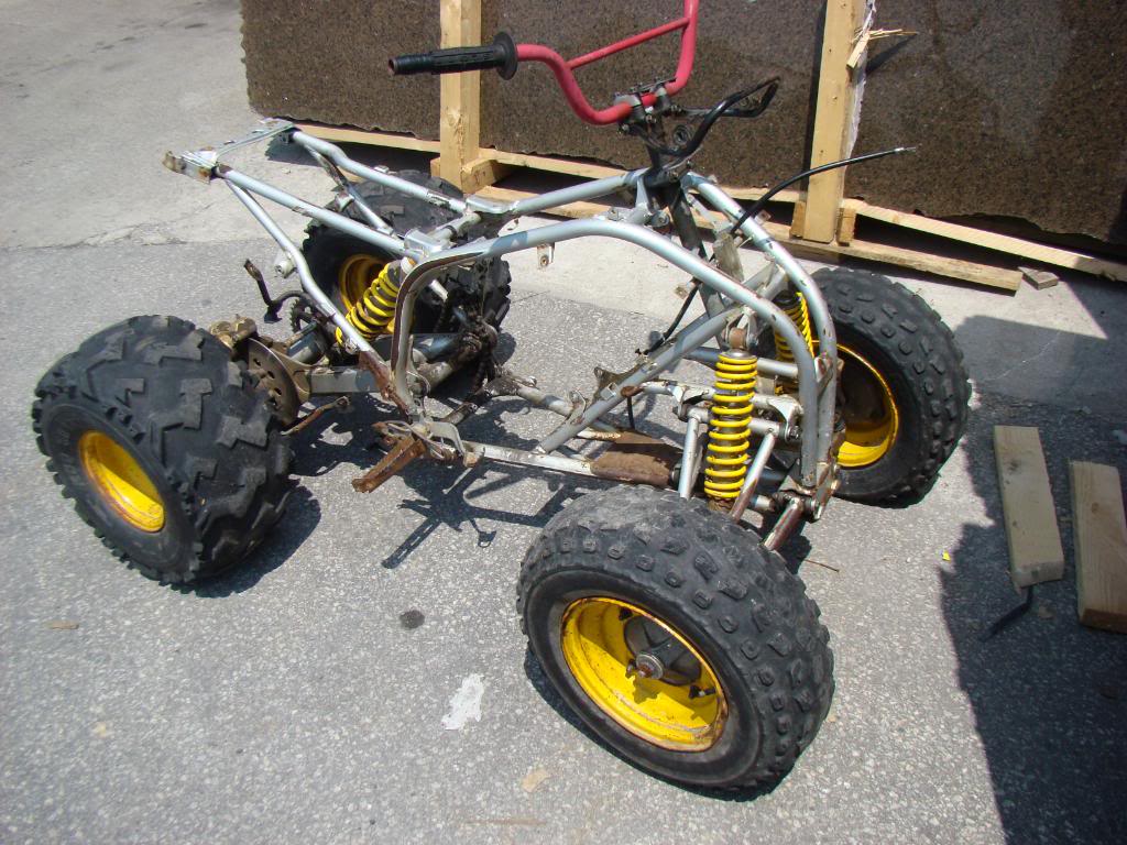

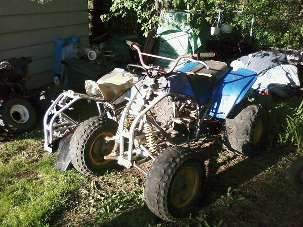

Our story begins with a Kijiji posting and the following pics.

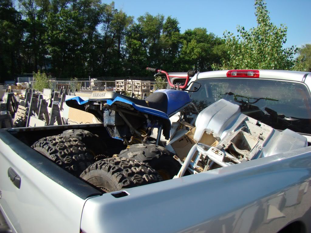

I drove up an hour or so from home to check things out armed with some cash. I'm trying to remember how much he was asking for it but I can't right now...I think it was $800
The guy had way too many projects on the go including a Banshee, jetboat, 90s mustang and a racing lawnmower, so after some negotiating I walked away with all the Blaster parts he could find.

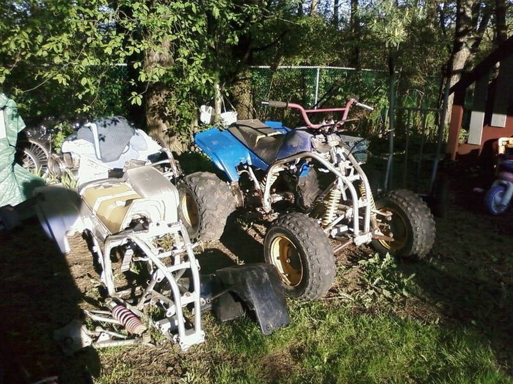

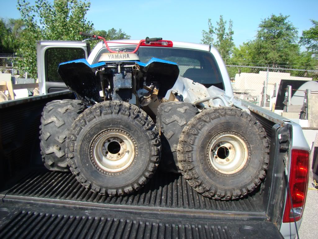

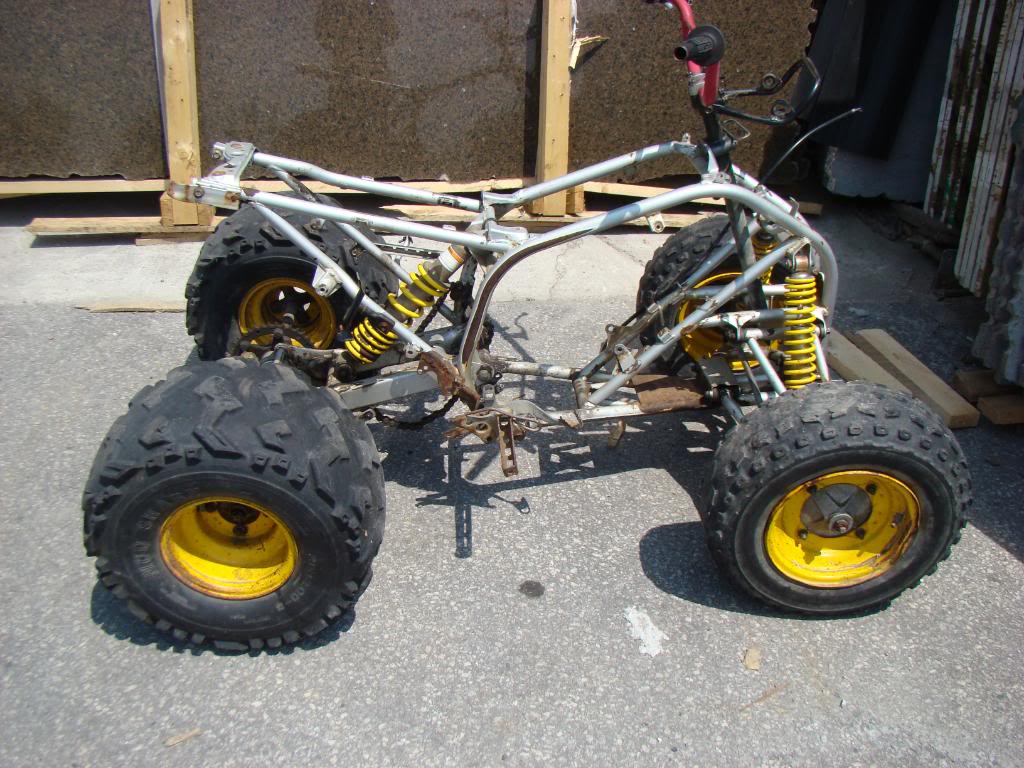

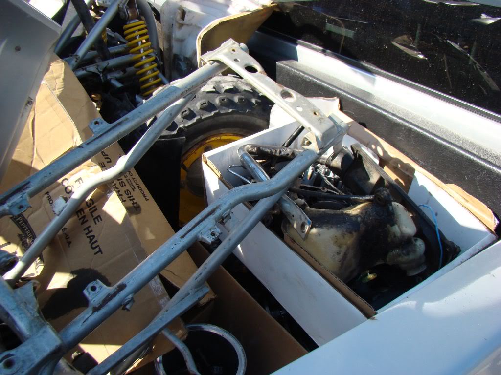

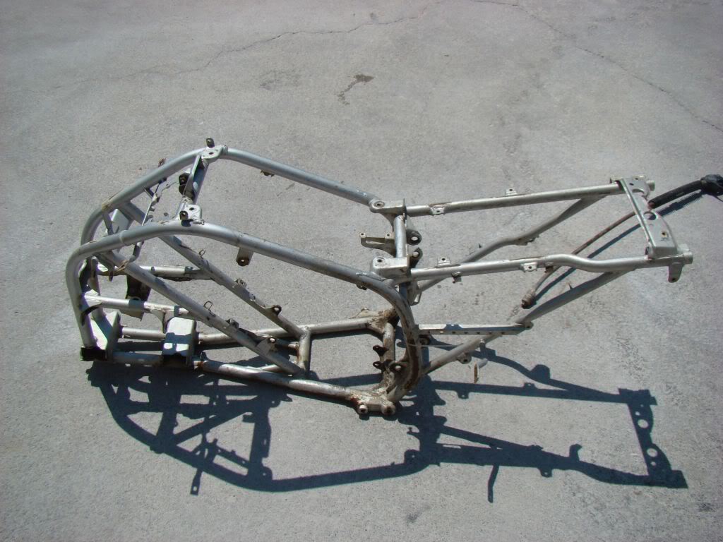

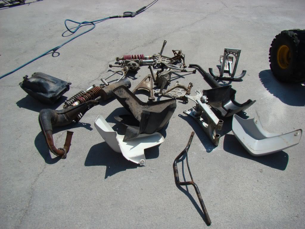

The next day I took everything out to get a better look at what we have to work with.
Again, at this point I have NO idea what I'm looking at, so this forum and pictures come in handy. I also bought a PDF Yamaha service manual...but it's not quite what I was looking for

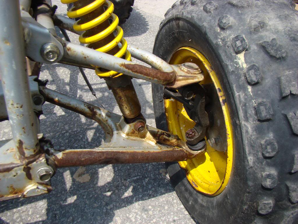

I was told that this Blaster was a few steps away from running condition

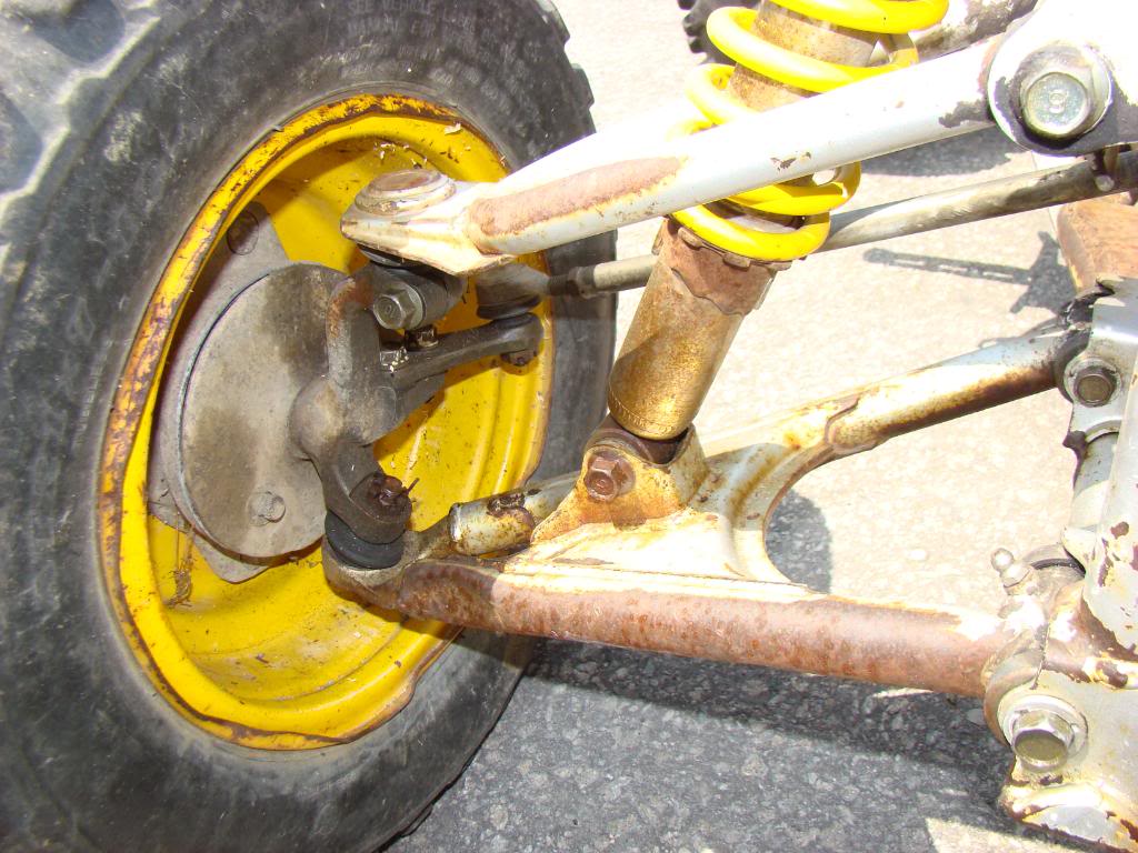

I got quite a bit of extra parts

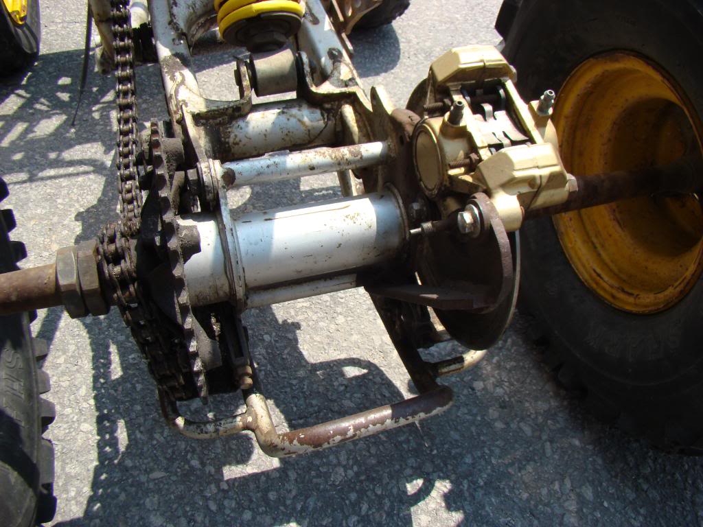

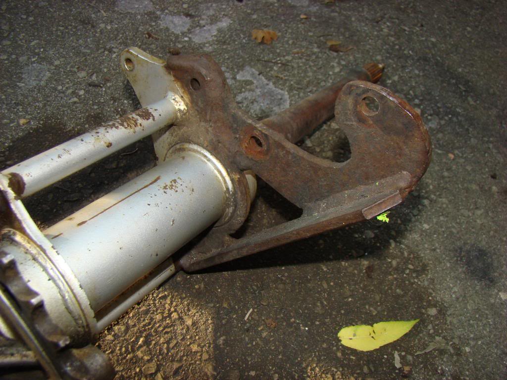

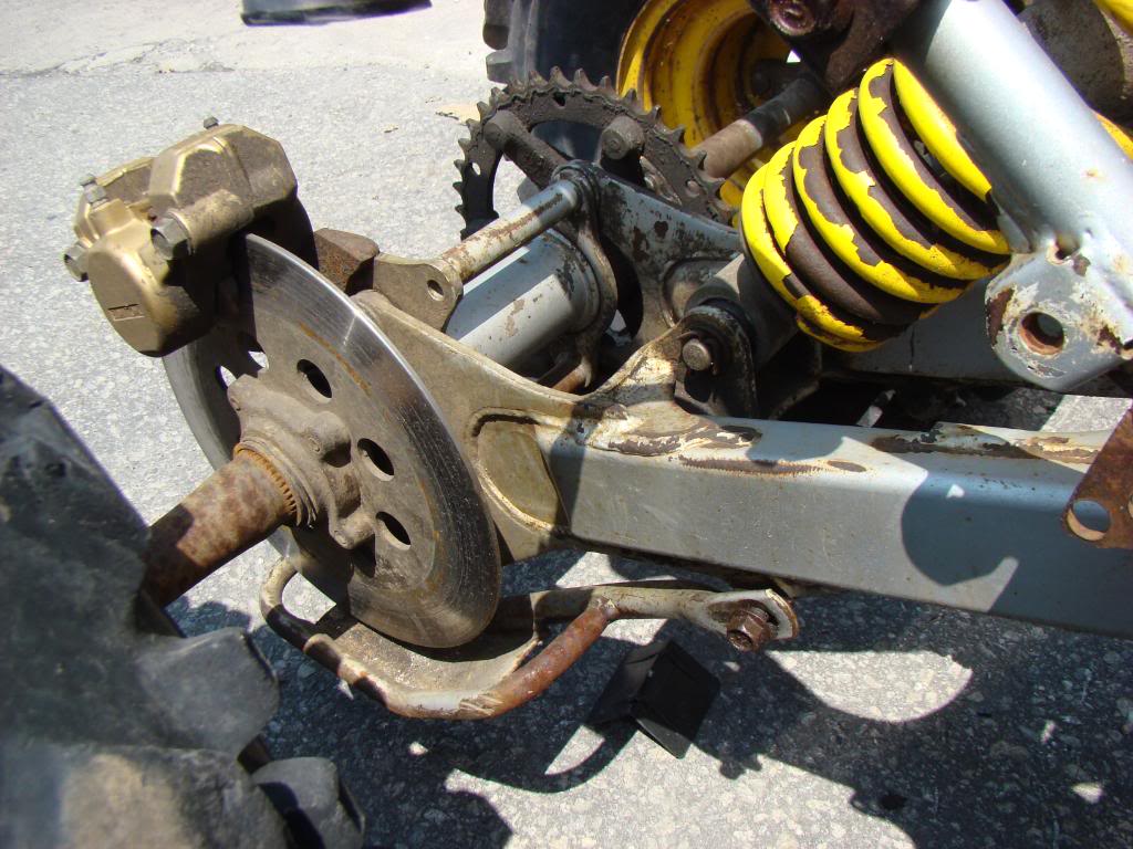

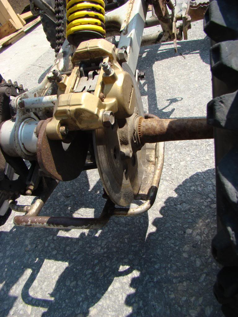

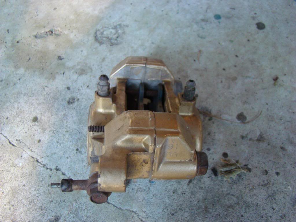

I soon found out that this was not a factory brake setup, and it was also seized.
Not sure it this is worth rebuilding or using at all...not going to worry about it now

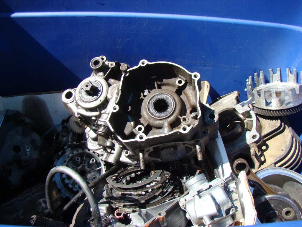

Now having said that, I ended up buying a 3rd Blaster worth of parts minus the frame a few months after I bought this one, and the 3rd one came with a complete "running" engine that has a crack around the gear selector.
The kid I bought it from bought a blaster with a blown engine for the frame/ownership. I picked everything up for $300 including some plastics in decent shape.
I'm hoping that I'll be able to get that engine welded up (I'm taking it to a place tomorrow) and then I'll have some time to build the 2nd Blaster for a bit more fun.
On the 2nd build I might do something more fun seeing as that engine is in 100 pieces.

Sounds like a plan! You'll learn quickly. A Blaster is only so complicated, and there's enough info on here to answer most of your questions in no time. In your situation, I'd check over the disassembled engine thoroughly and then just decide how much $$ you want to spend on the build.
Two tips for you when doing that engine: 1) Don't re-use crankshaft bearings. Especially if you don't know where they've been or how long they've been outside the engine. Buy and install a new set. 2) Don't cheap out on gaskets, seals, or on a new piston. Stick with OEM Yamaha gaskets and seals and go for a Wiseco piston. That's all most guys on here run and I'm one of them. You won't have any air leaks or broken pistons if you go this route.
Hope this helps! :D

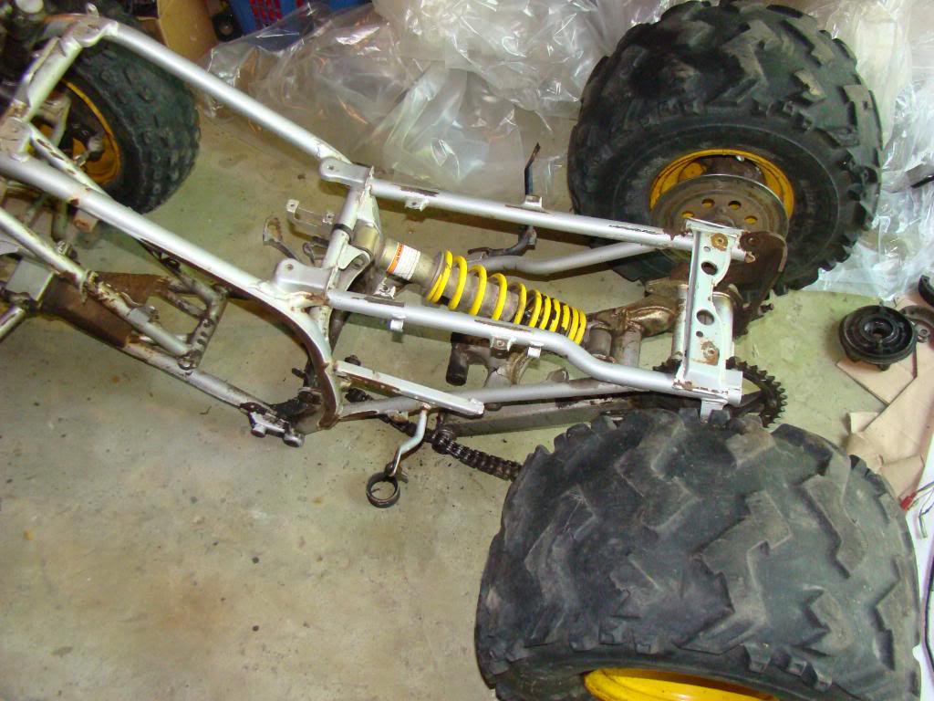

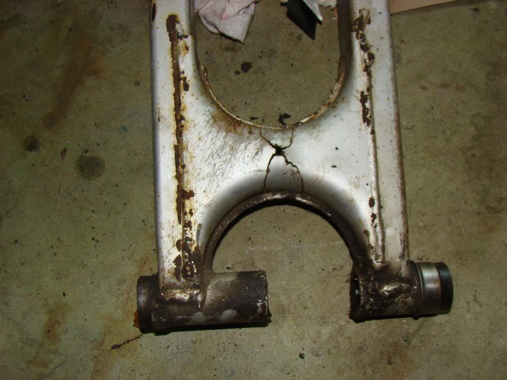

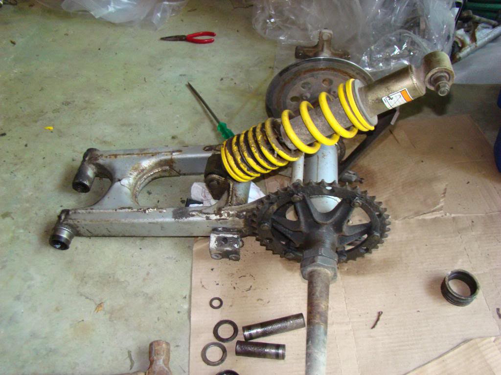

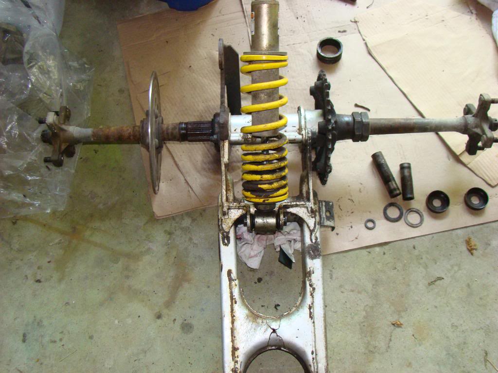

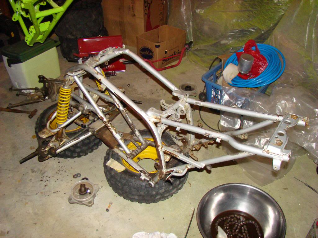

After looking things over some I dove right in and started to take apart what was left of the little guy.

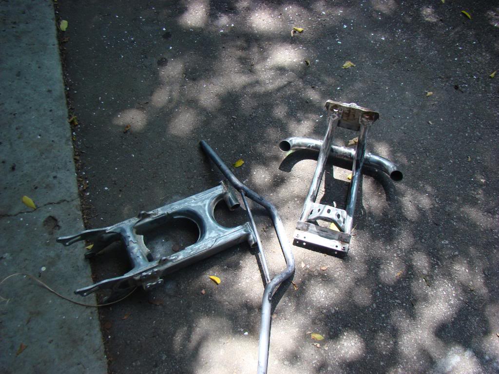

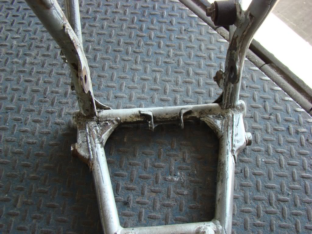

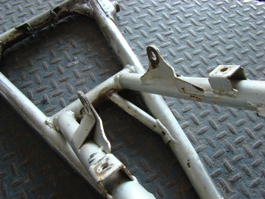

Turns out the swing arm was cracked, good thing in the pile of parts there was a spare.

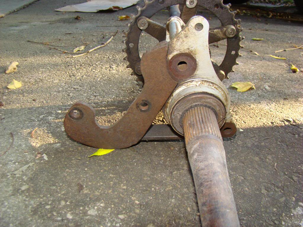

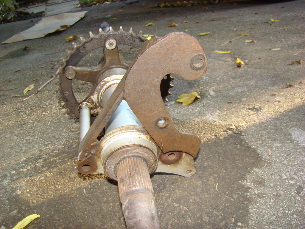

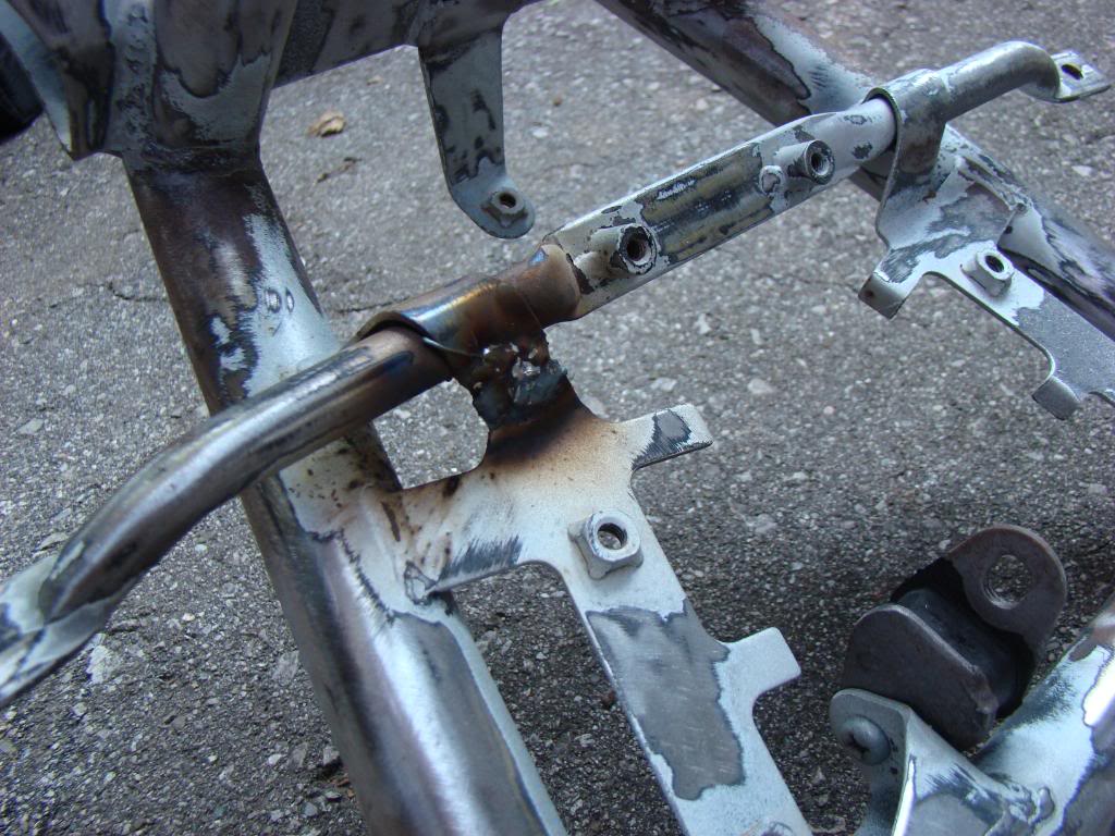

A welded on bracket for that weird rear brake
I plan on reusing this axle for the 2nd blaster, so eventually that bracket will get removed.

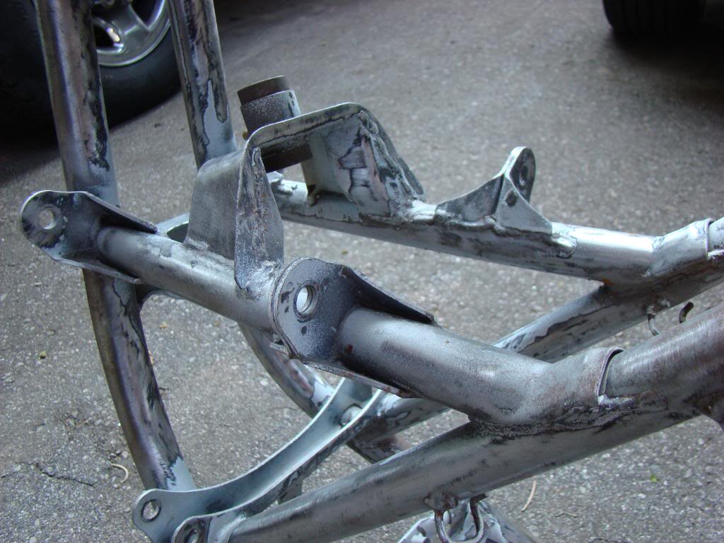

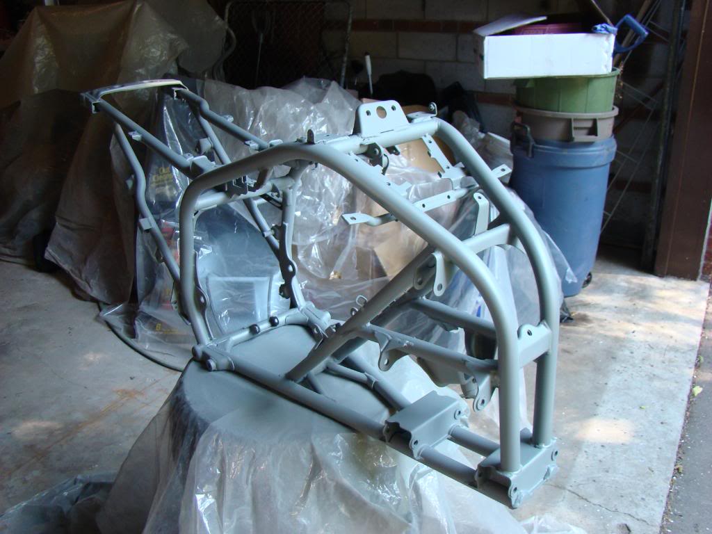

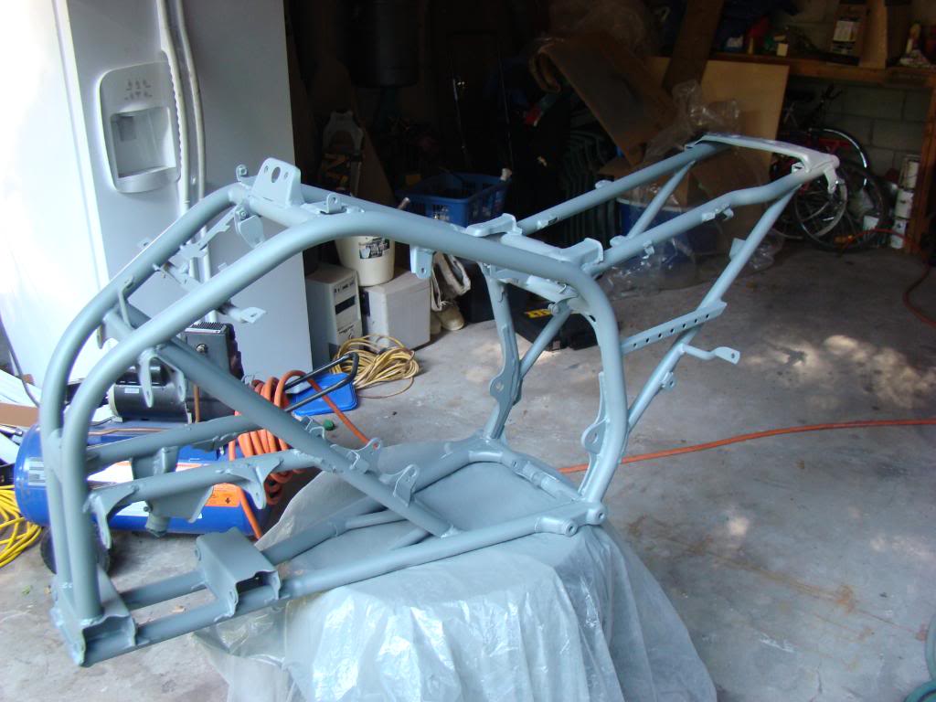

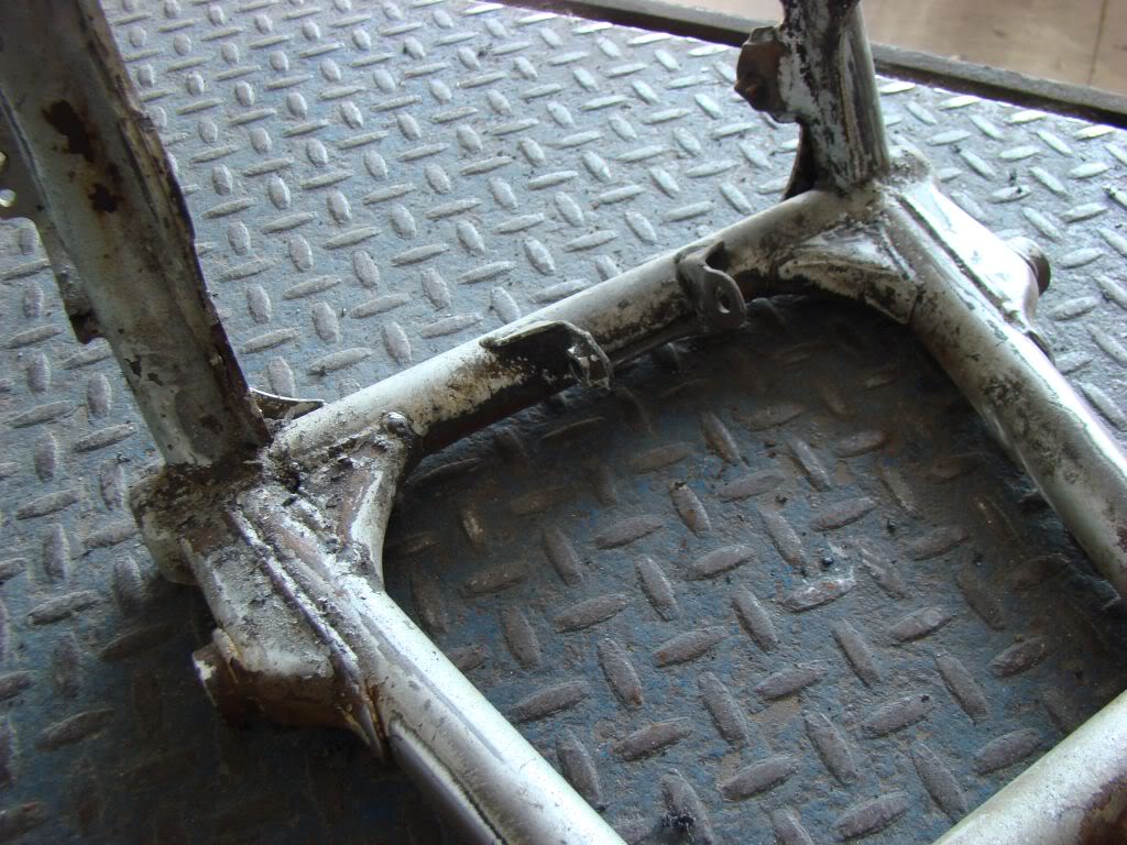

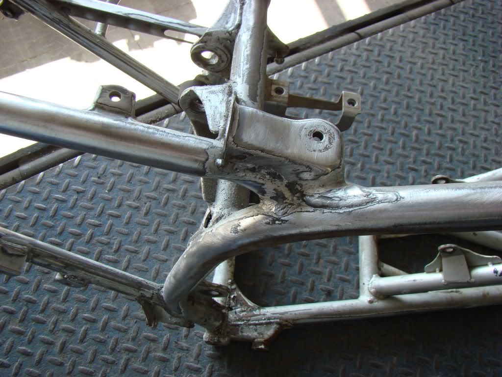

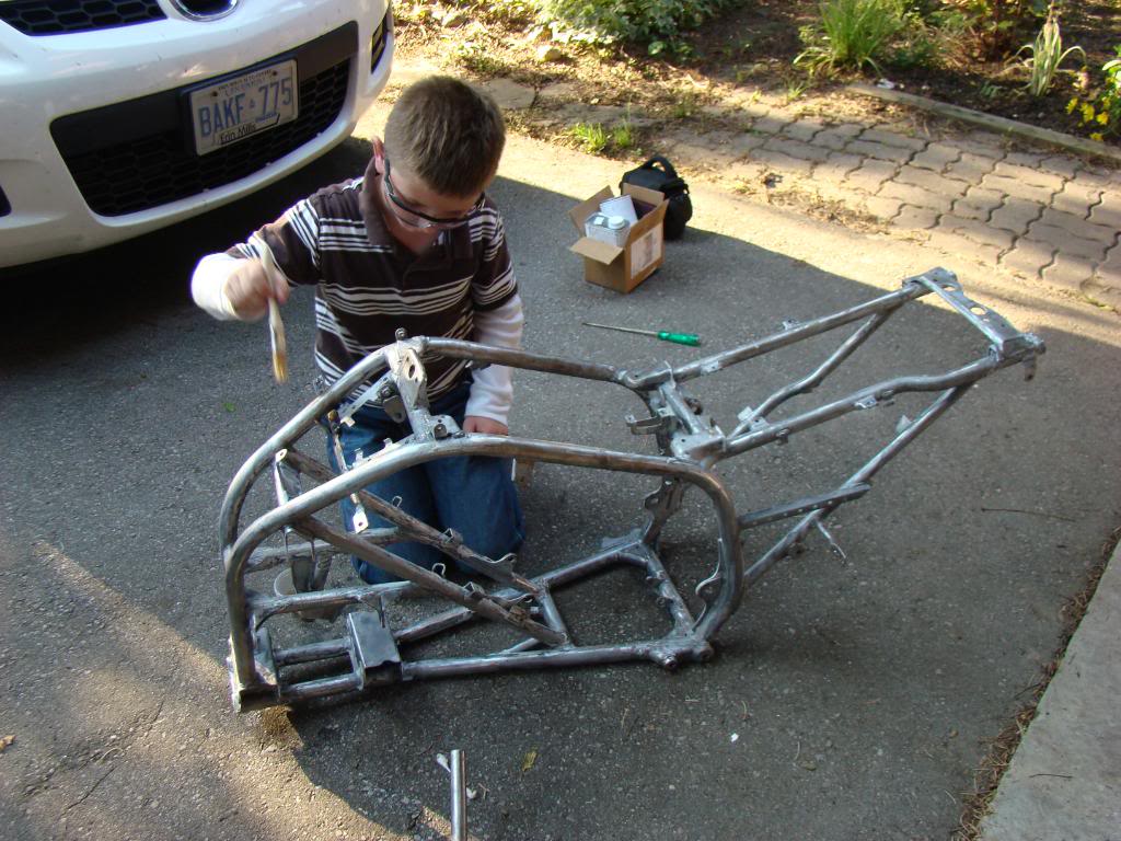

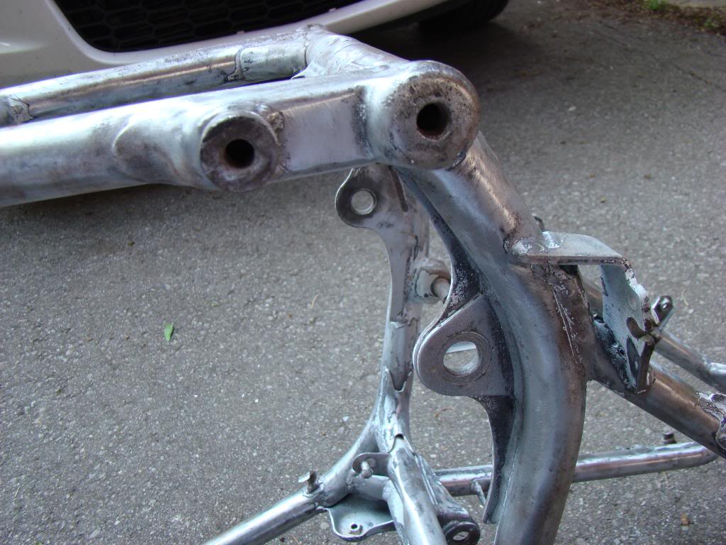

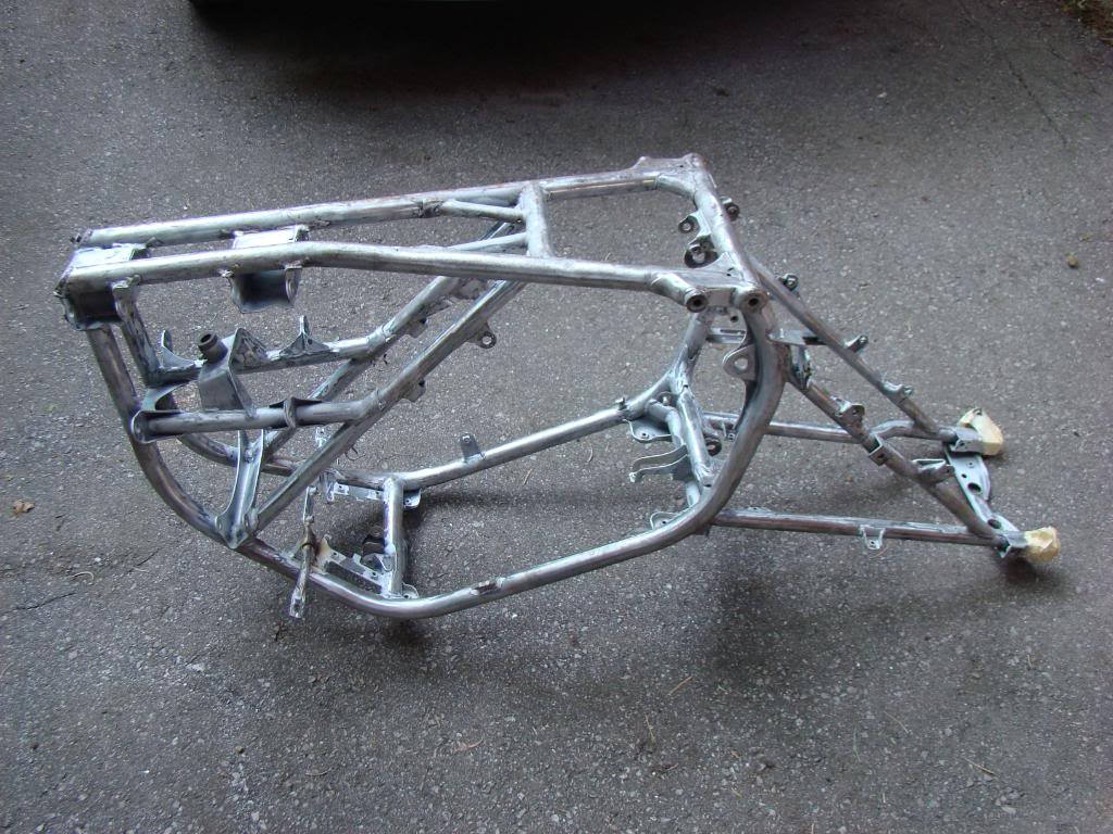

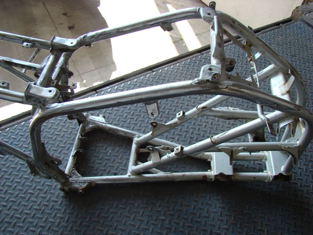

I started cleaning and sanding the 2nd frame up getting it ready for paint while I took the 1st machine apart. (semi-spoiler shot in the 1st pic of the above post)
The 2nd frame had a minor crack that needed to be welded.

Like I mentioned before, I'm using that 3M disc to sand the frame, and whatever else I can't reach with that disc I'm sand blasting using crushed glass.
BTW, a tip I came across after I found those 3M discs. They start out pretty large, but as they wear down they obviously get smaller, so you can plan to sand your tighter spots after the disc wears down some. I usually keep a smaller one as well as a full size on hand. I use these things a LOT!

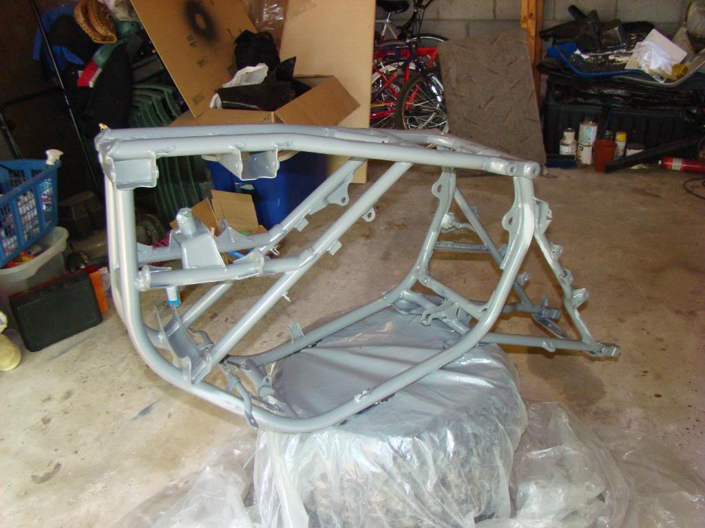

Here's some of the other parts I cleaned up.
All the bare metal was treated with POR15 Metal Ready. It's basically an acid that etches the metal and kills the remaining rust.
Here's my helper applying the metal ready.

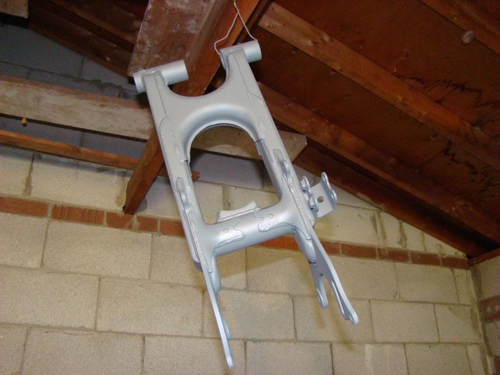

I'm using PPG etching primer also. Very good stuff...unlike the made in China HVLP gun I'll be shooting it with :D
A coat of primer
I have more progress pics I need to post, but my ass gets up at 5am so this will be it for tonight's posting.
The swing arm primered up

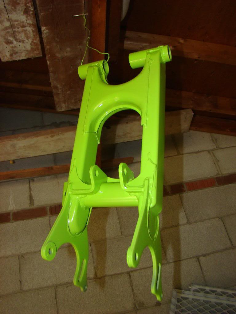

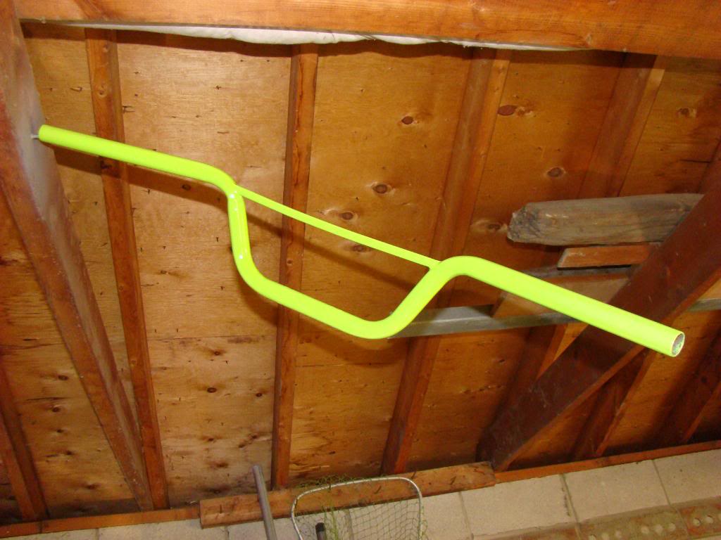

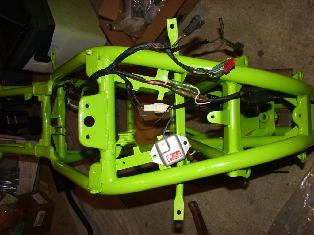

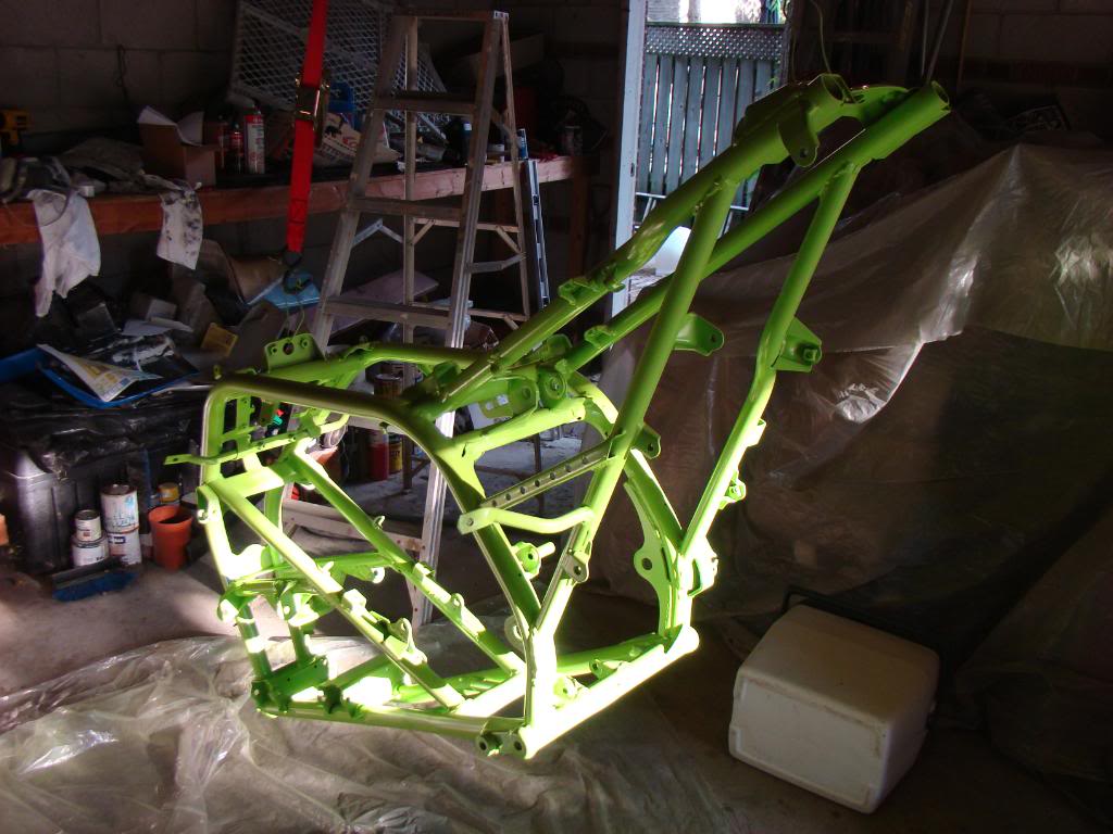

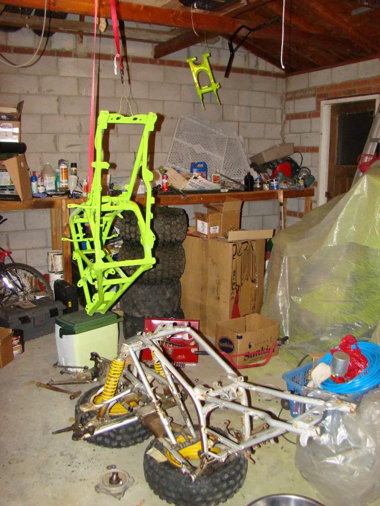

Mr. Monkey was VERY SPECIFIC about his choice in paint color and since we got a peek at it a few posts ago here's the final product on the swing arm
handle bars

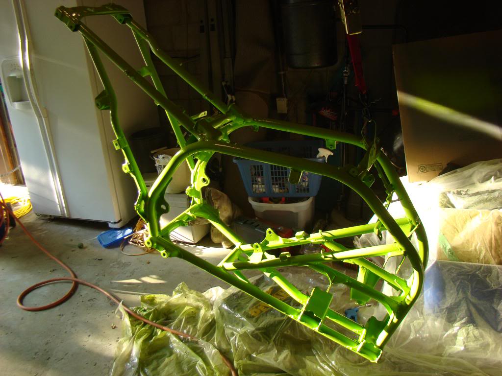

and the frame
The new and the old
