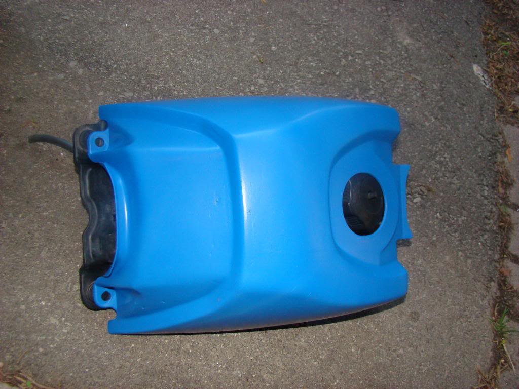

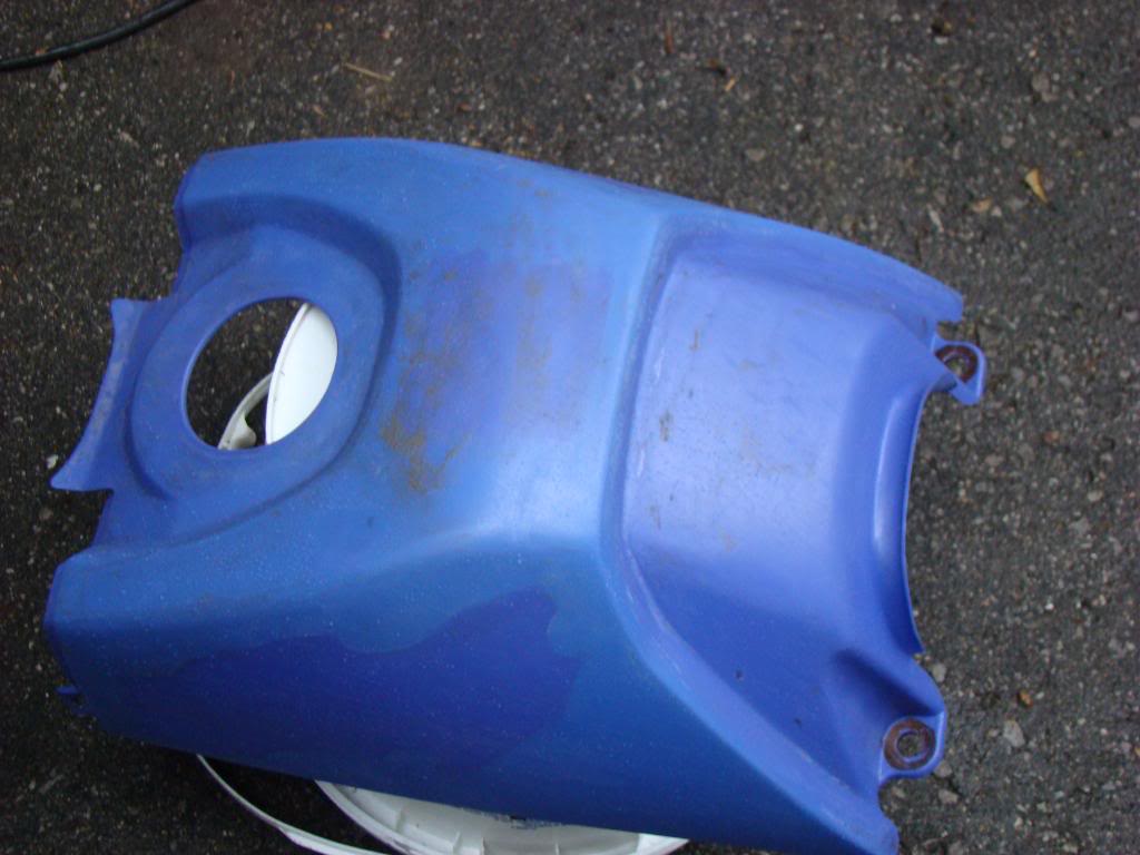

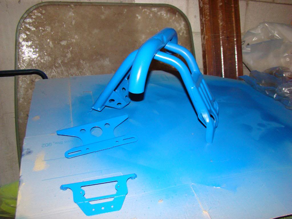

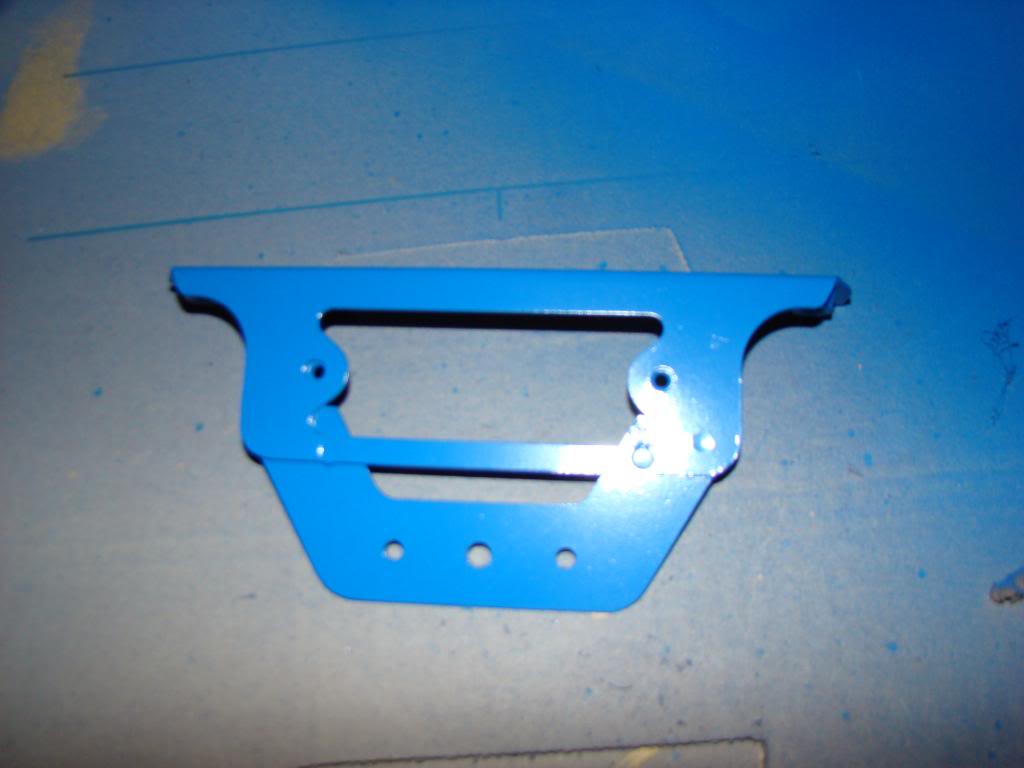

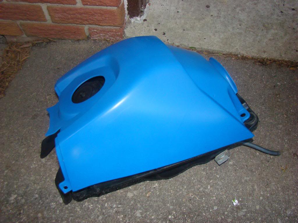

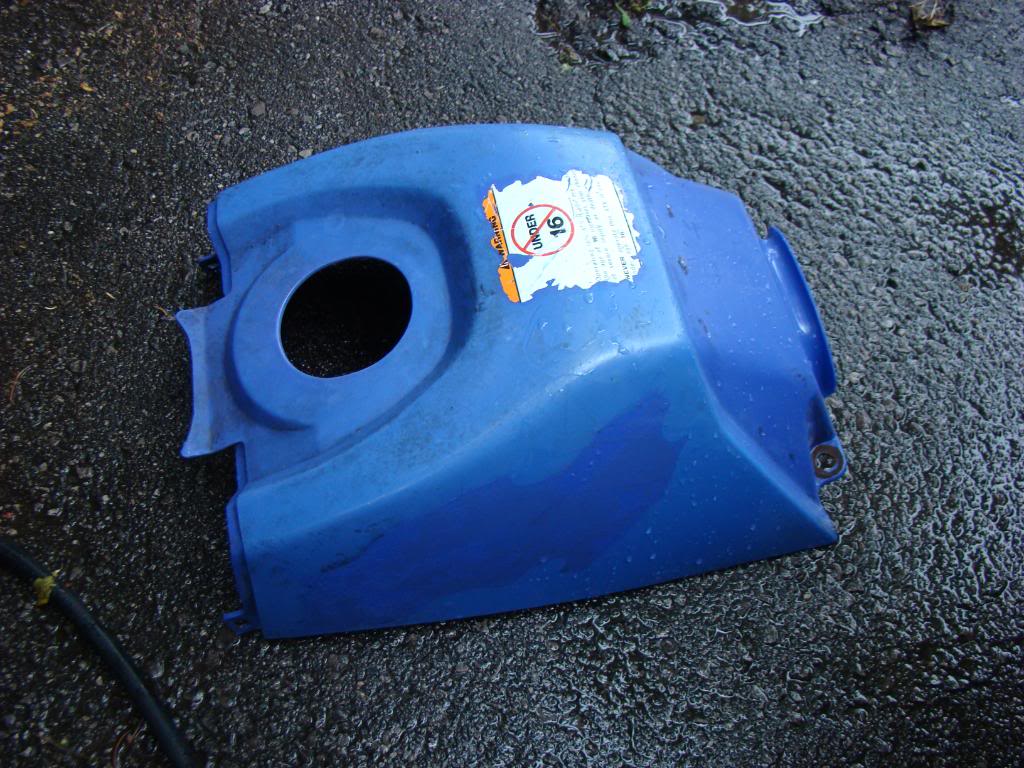

The other color chosen was this blue, and since the plastics are being rattle canned in this Krylon Fusion color, it was decided that there should be some blue accents also.
old gas tank cover
Kryloned

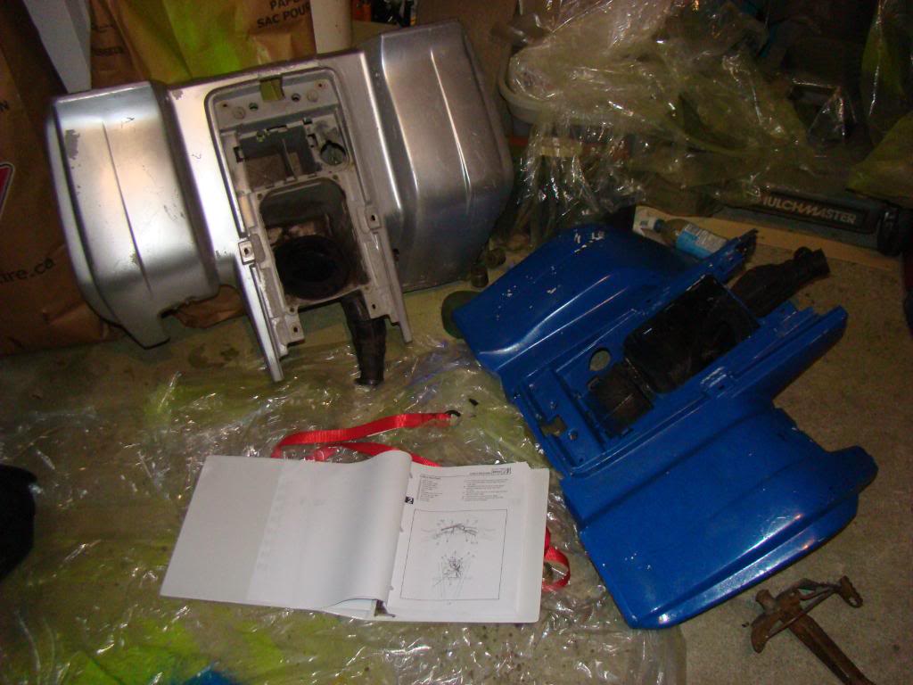

The rear plastics that came with the first batch are in pretty rough shape and have already been rattle canned.
From the information I have read here, it sounds as there is no real solid fix for plastics correct?
Epoxy? Resin? PL Premium?
old gas tank cover
Kryloned
That blue is a really nice coulor as well.
I would go green frame with blue a arms and swingarm and green carrier.
Great spraying as well , Every time i try spray things allways comes out bad Lol

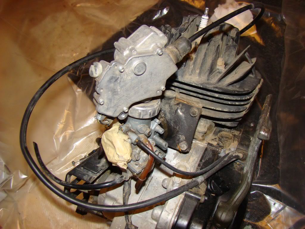

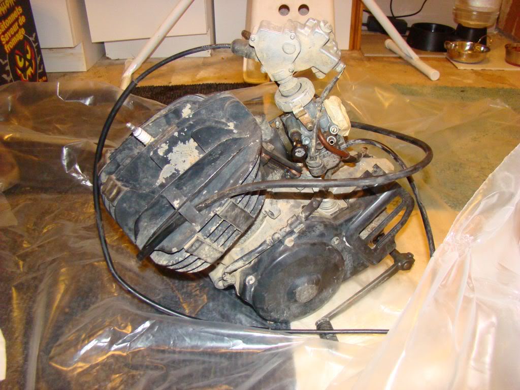

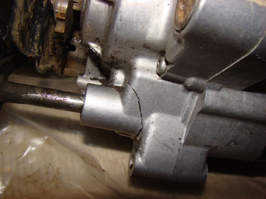

Here's the engine out of the 2nd lot of parts.

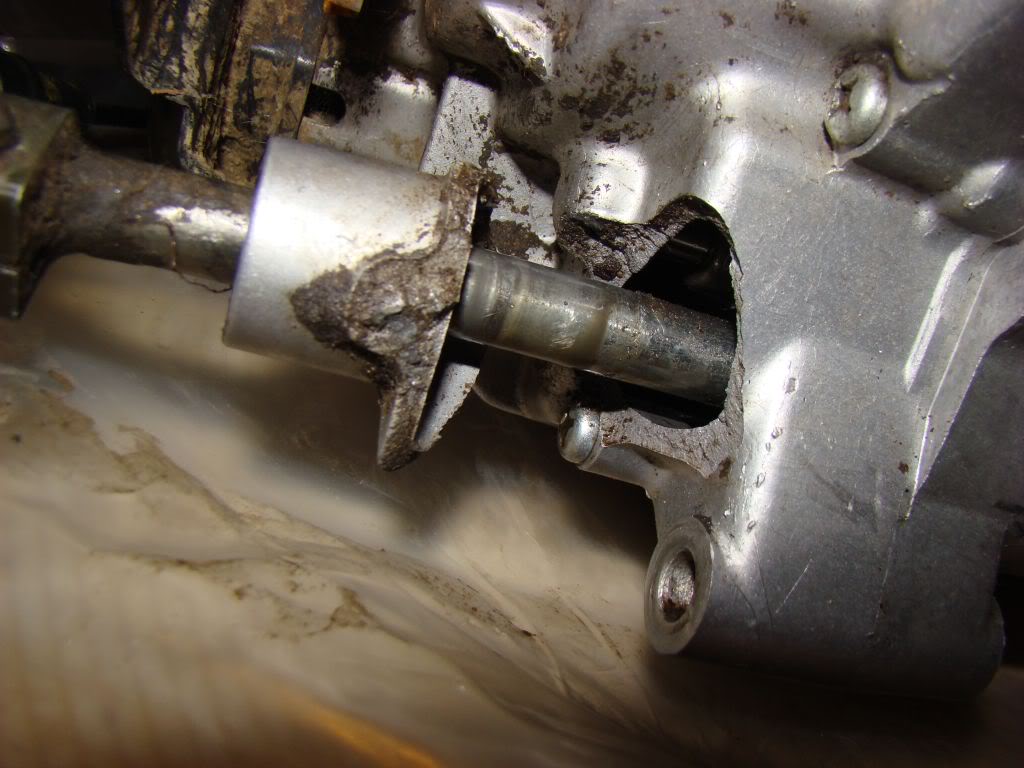

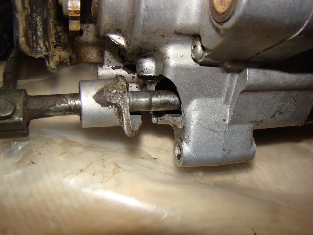

There is a crack all around the end of the casing where the gear shifter comes out which I'm hoping i can get welded. First guy I talked to was a moron, the next guy was recommended by someone I know and after talking to him it sounds a lot more promising.
The rest of the engine looks to be complete and in decent shape.
AWESOME JOB SO FAR!!!!Especially if this is your first build!!
Anyhoo youve bought a bunch of parts i see why not just replace the case halve with another?Im sure in all the odds and ends you got theres a spare case halve?
Id advise against welding if you can just replace the case halve.Splitting the cases is not a big deal.You could have that thing swapped and back together in a few short hours.
did you clean all the old paint off?
i stripped all the old paint off the frame and anything else that was rusted down to bare metal. other pieces that only needed a color change or had light surface rust, i sanded down lightly so the new paint would stick.
the case halves that i do have as spares aren't good. the one in good condition is the wrong side. the next best one has a hairline crack and some bad bearings.
why would you advise against welding?
i am trying to avoid dissassembling things unless i absolutely have to.
the minute i crack this thing open i need a new gasket set no? then a case half and the list starts from there. I don't like spending $$ if I don't have to.
The trouble with repairing that area is alignment.... You have to be VERY careful to notch out a handful of areas for filler without mssing up the factory "break line" ina few places to make sure that the piece stays where it was supposed to be. THEN you have to go back and V out the areas left after there are a few weld spots to hole it in place. Take some time and patience and most welding shop don't do that sort of thing so they don't want to mess with it.
Budget_blaster, why would you throw away a set of cases that can be repaired? One day blaster cases will be rare and people will be kicking themselves for not repairing the repairable. Remember, they haven't made any new ones since 2006....

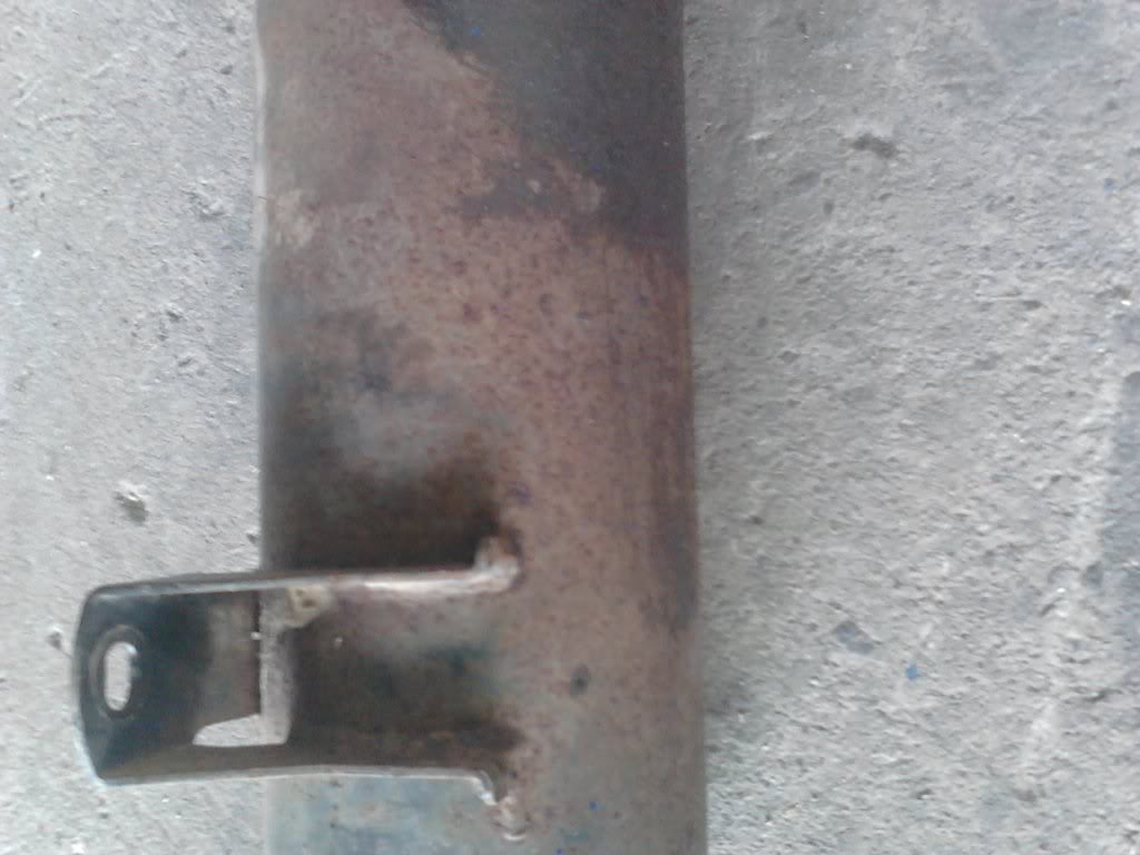

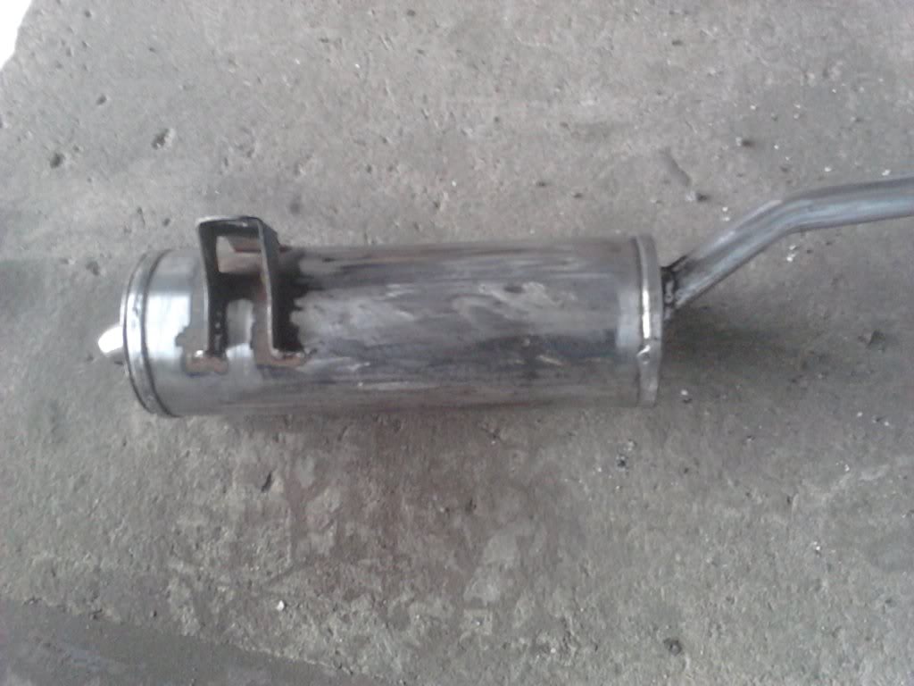

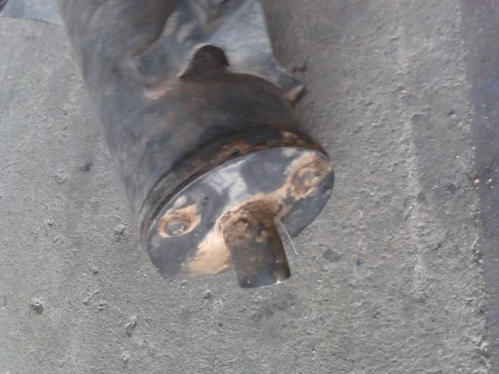

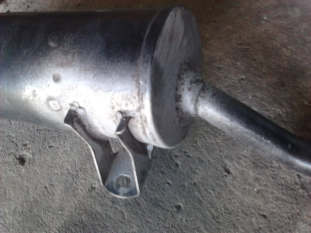

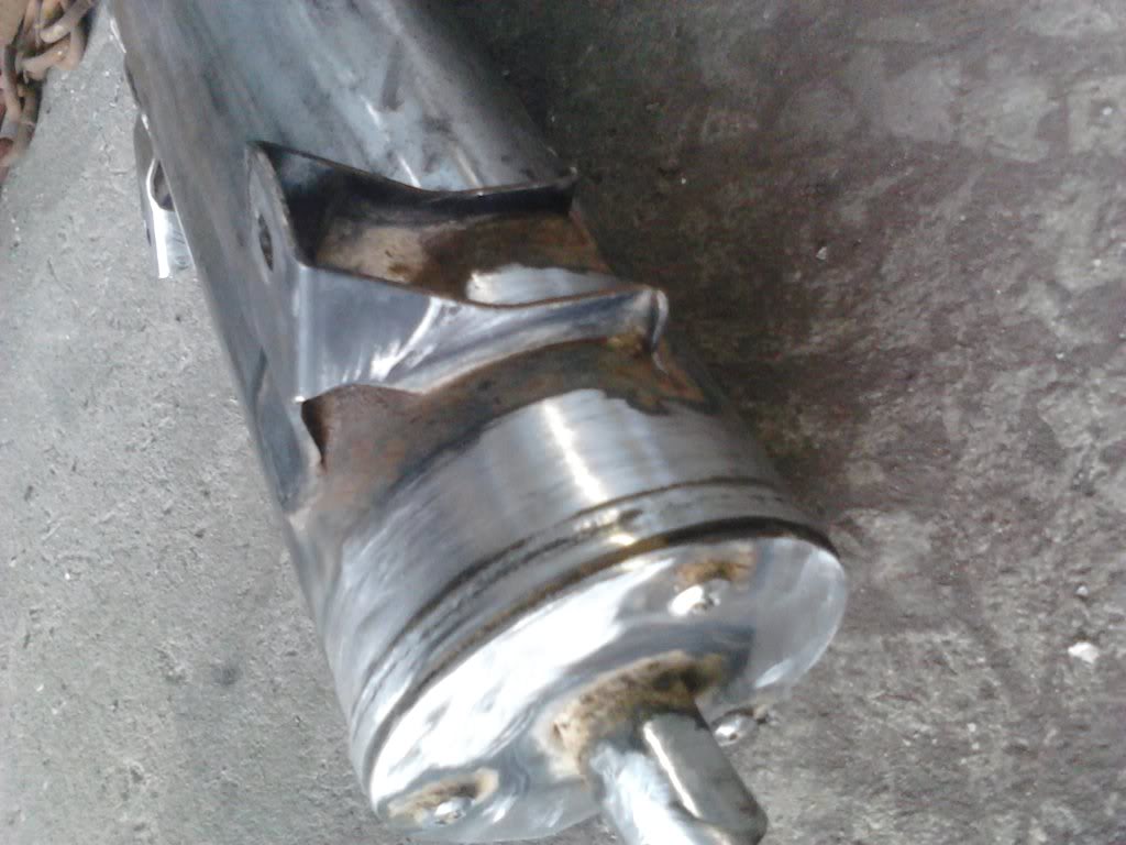

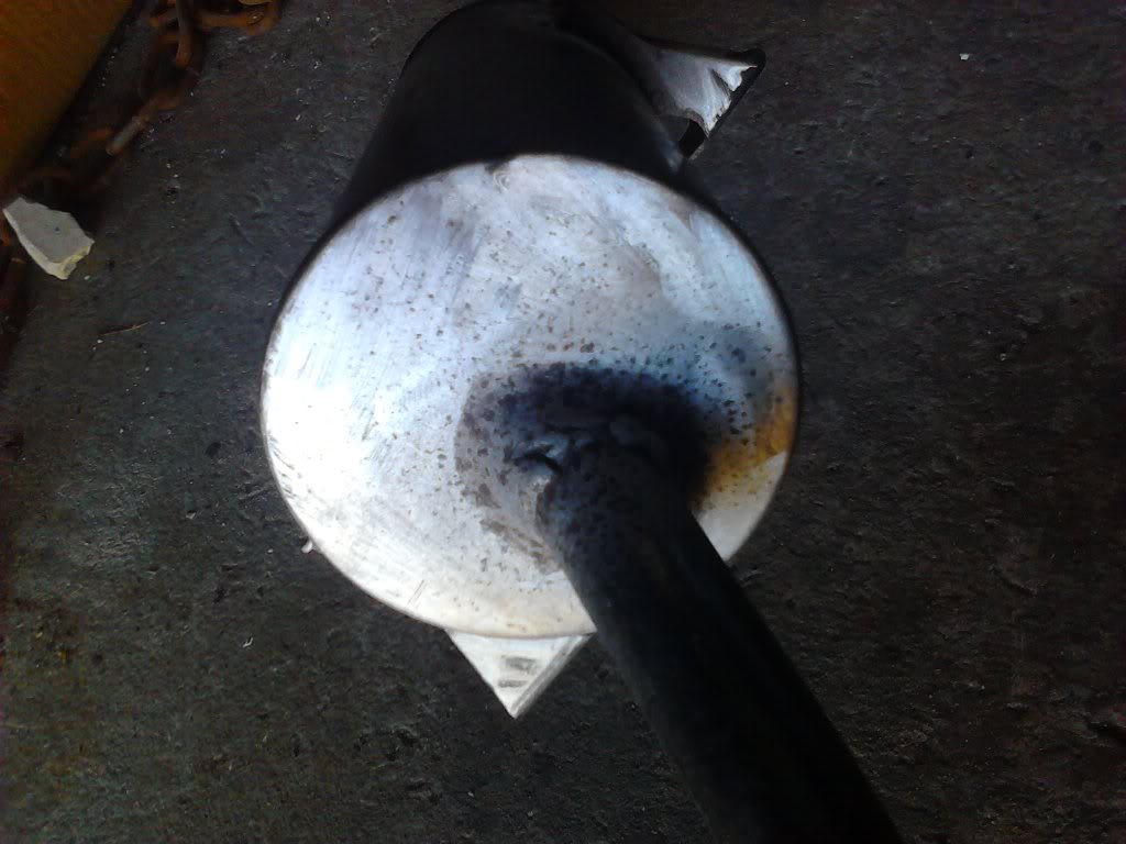

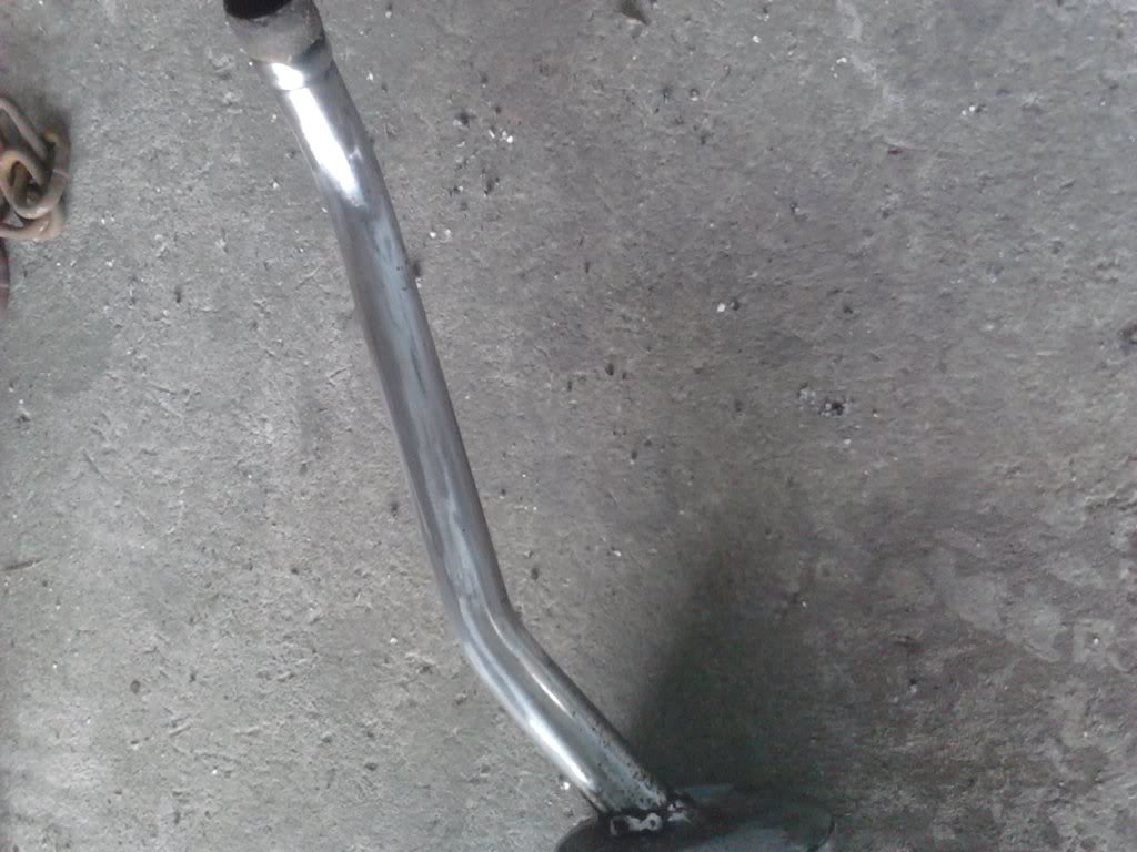

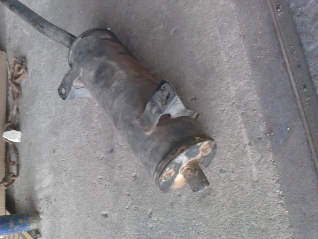

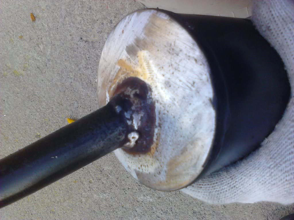

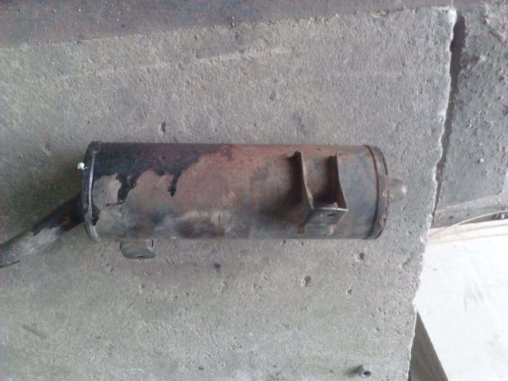

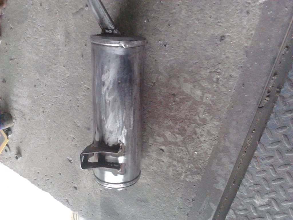

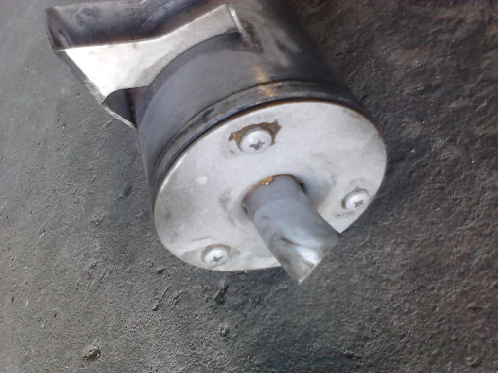

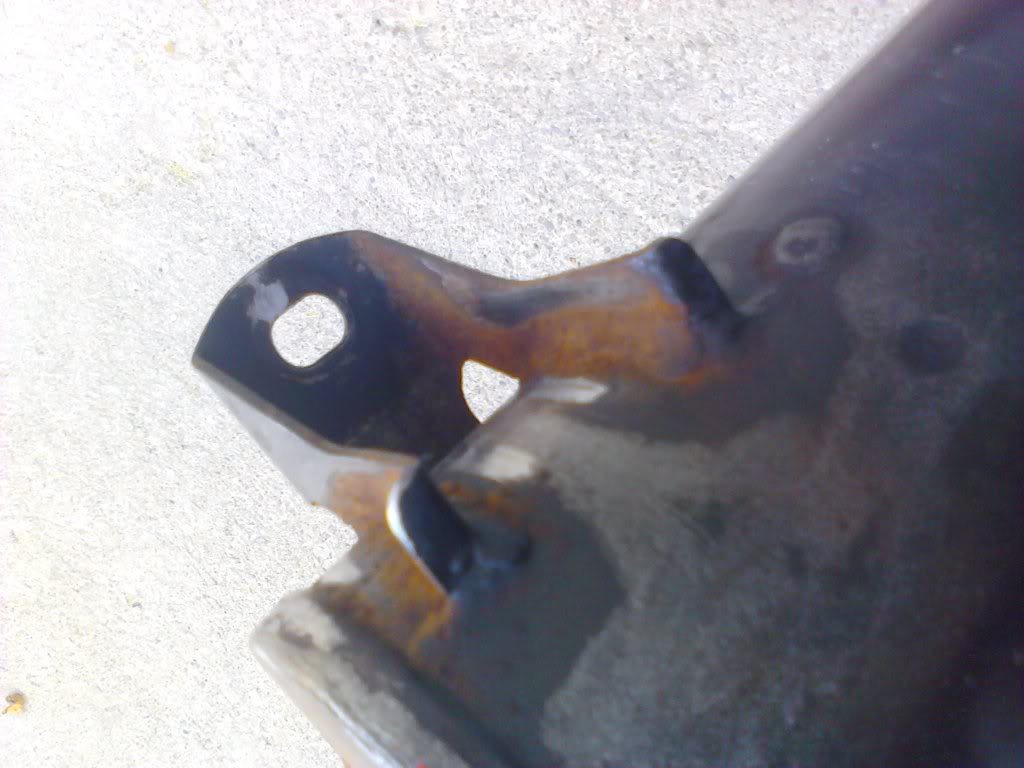

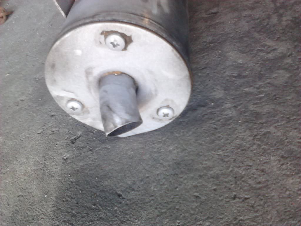

I had some time to clean up and repaint the factory exhaust.
From start to finish I have about an hour into this.
This is what we're working with
It took about 20 min with the 3m disc to clean most of it up.
Obviously with the wheel I couldn't get in everywhere
In the areas I couldn't get in with the wheel I sand blasted.
I dropped off the motor at the welder's yesterday. I got a good feeling about this guy. Super clean and organized shop, asked the right questions etc,
We'll see what happens, supposed to be ready today.

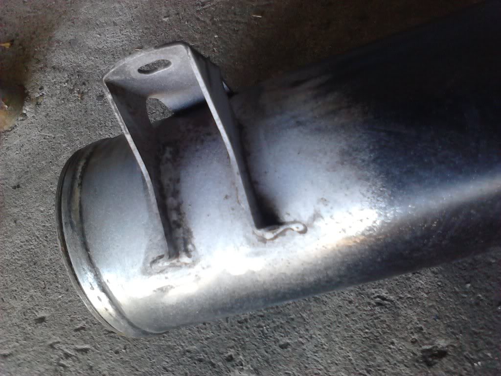

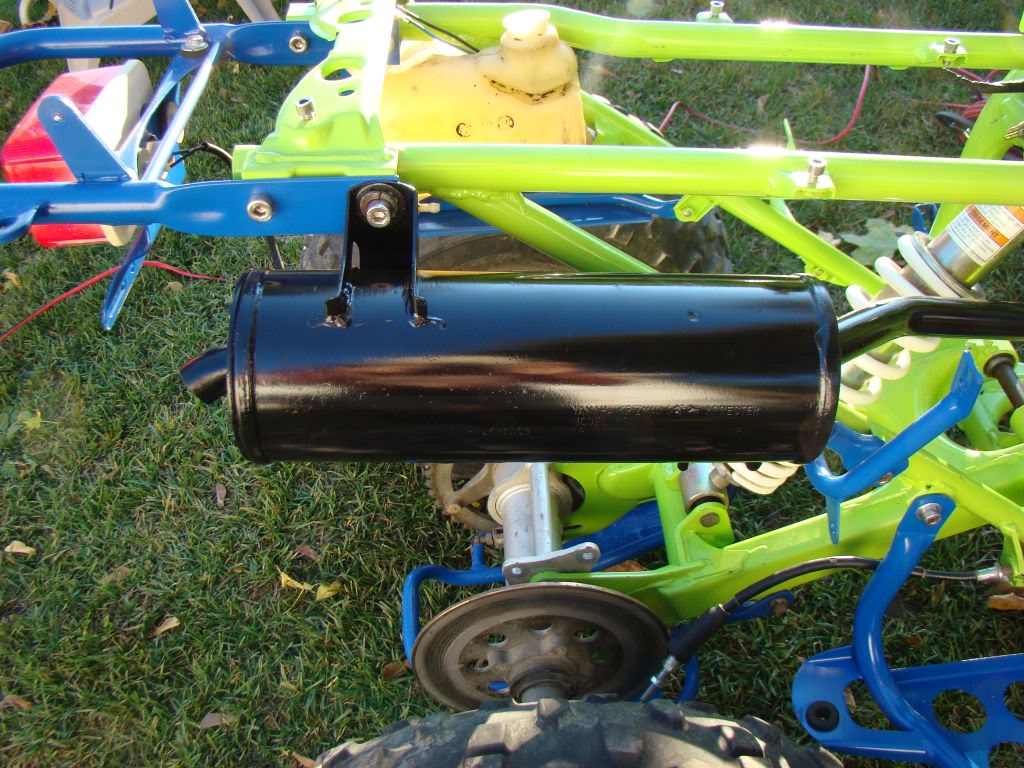

This is what the exhaust looks like painted and bolted up.
