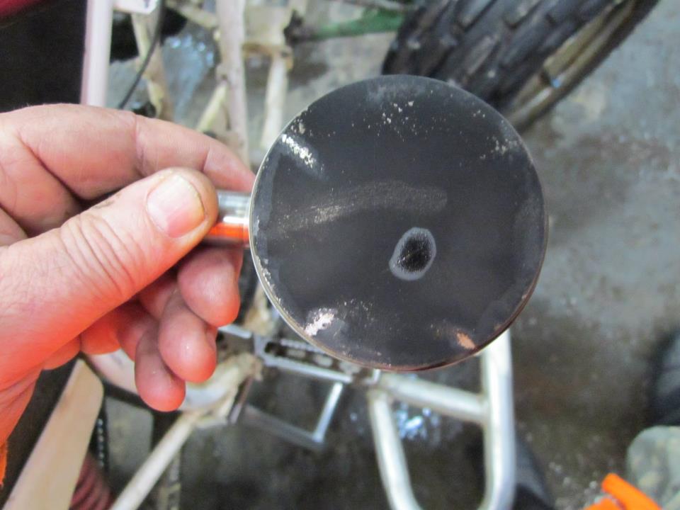

Cylinder off, piston burn pattern looks good. Yeah, the bore and piston are pretty rough, but still snug.
That is an after the fact gas smudge on the top of the piston, and yes, the engine is hard coated in mud.

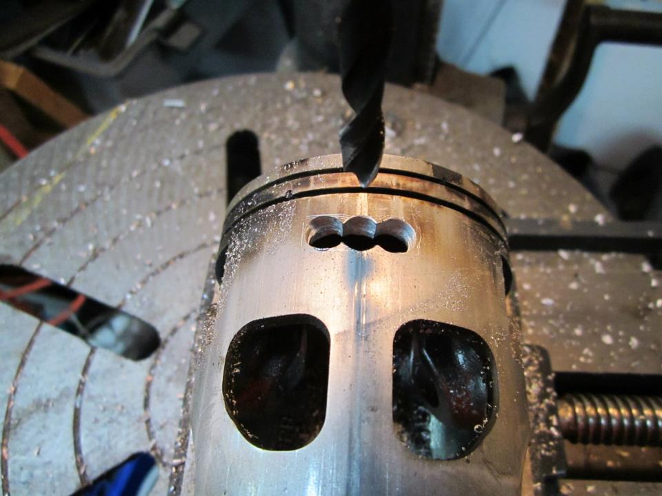

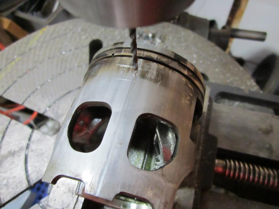

After some experimentation it was decided to line the piston and cylinder windows up to scribe the piston.
http://sphotos-h.ak.fbcdn.net/hphotos-ak-snc6/188643_10151385060060803_81061242_n.jpg

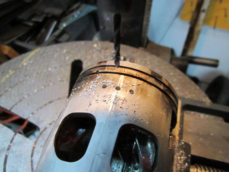

Piston prick punched and about to be pilot drilled:
Drilling in steps, connect the dots:
Note the use of soft jaws and those were the "porting tools".

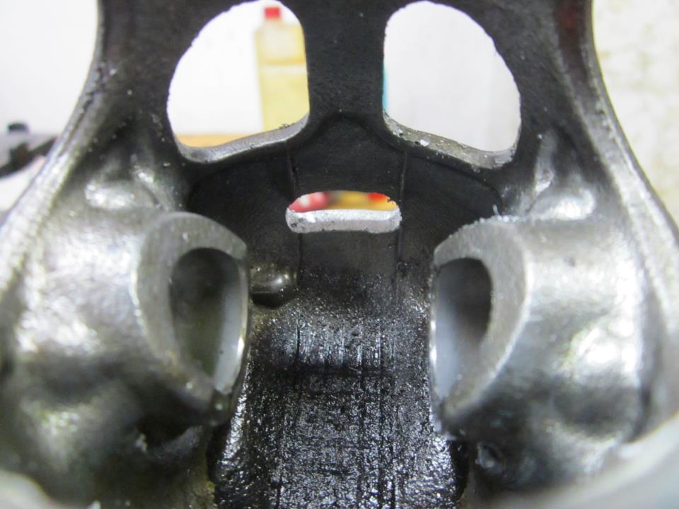

Inside view, it is the casting lines that are off, the hole is centered.
So, How does it look in the cylinder? See the next post...
That first piston picture, it definitely has a "hot spot" right in the middle. Was it lean?
Actually James, I think that was a drip of something as we took it apart.
We rode the living daylights out of it in the snow this afternoon and ripped it apart still dripping.
Here another pict of the piston:
You can see it is a wet drop, and the smudge line is from a sloppy finger.
Scuff up the center of the intake side has been there a while (assembly error), and there is a small scuff on one side of the exhaust side.
Here is the bottom of the piston, a bit of carbon, it has been hot but it has also been run long and hard.
Engine has been very hot at times, Triplecrown shows it no mercy.
All and all not too bad for someone learning on and many hours of hard max revs riding in sand pits.
This is a Vertex cast piston and no signs of cracks.

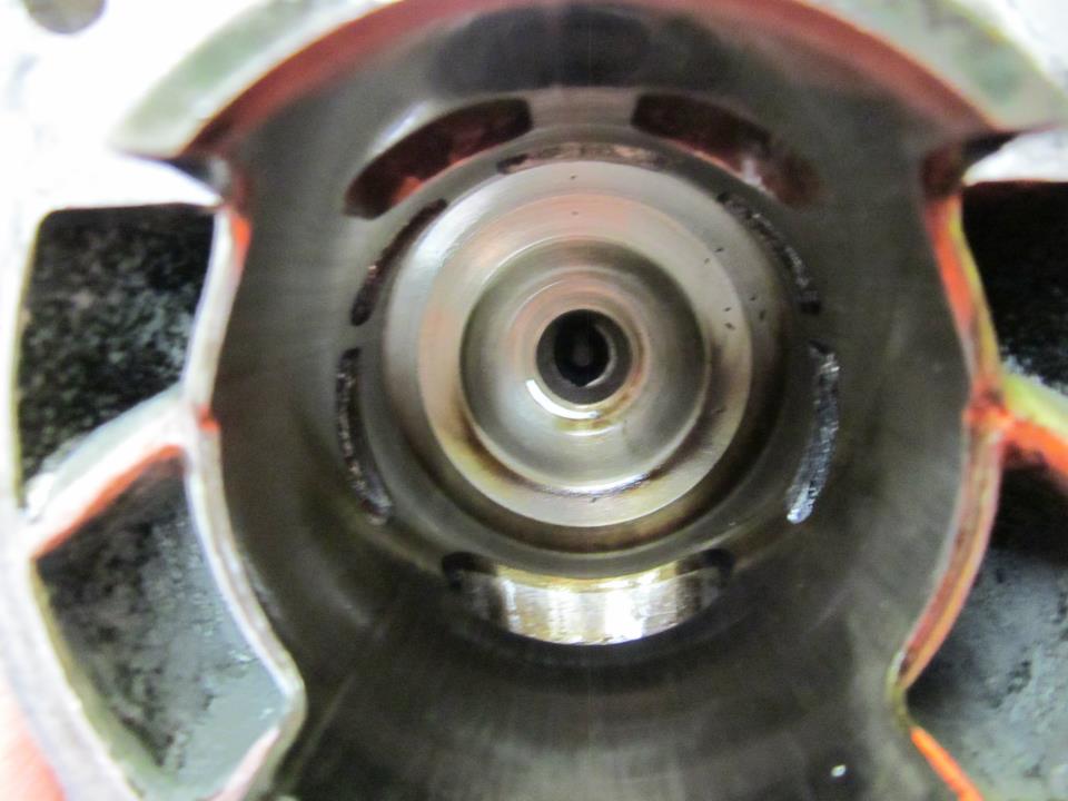

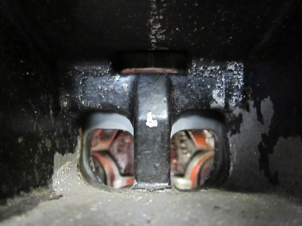

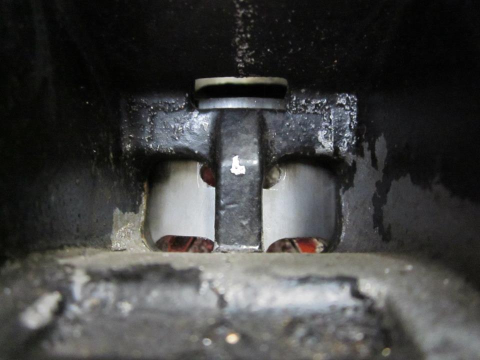

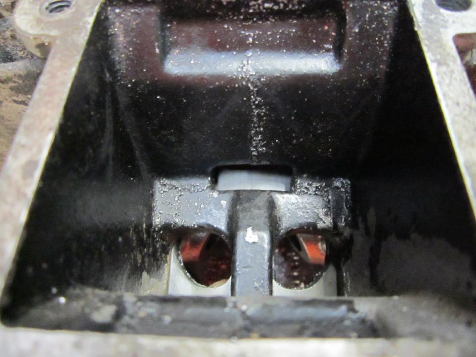

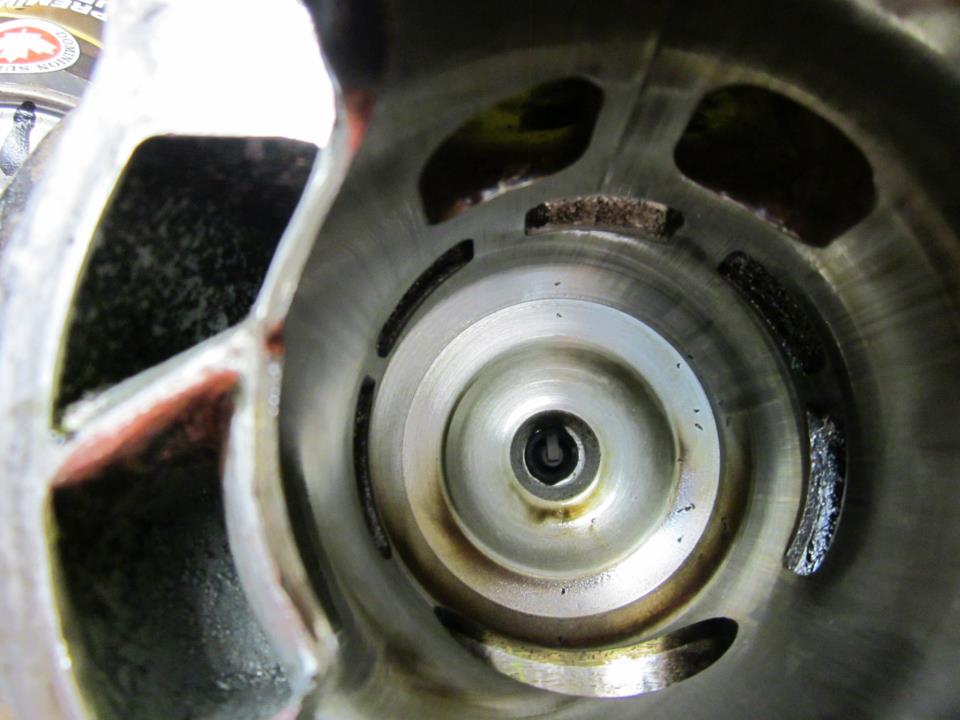

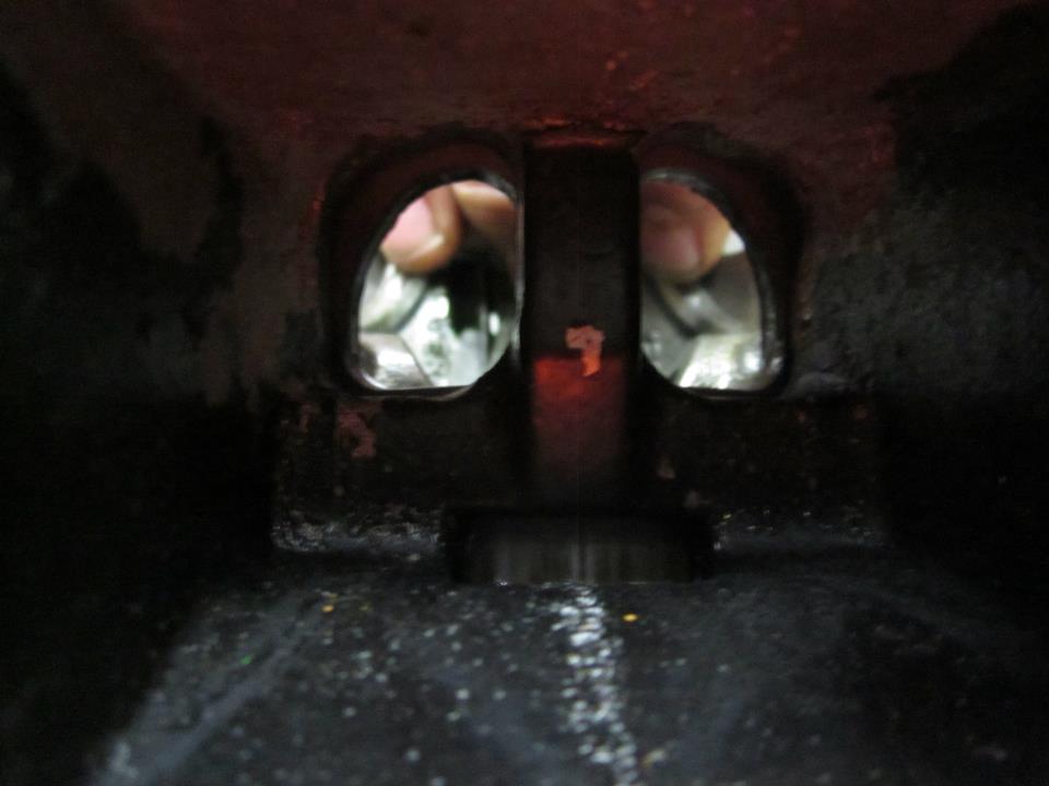

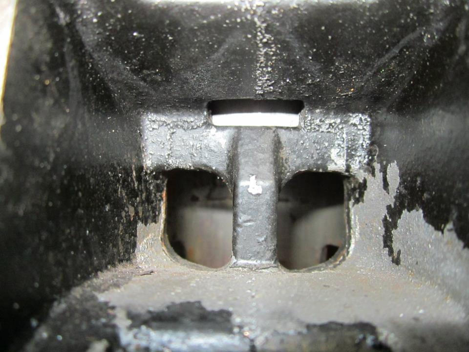

OK, so what does it look like in the cylinder?
Because of problems getting the reedbox sealed last time, Neil and I were loath to take it off .
So leave sleeping dogs lie, we figured. This is a totally stock spare cylinder with piston at BDC. (Bottom Dead Center)
Here is the piston at top of transfer ports.
You can see the piston boost port just opening in the cylinder boost port.
Here is the piston top level with the exhaust port (stock cyl).
If you look careful you can just barely see the bottom of the piston port. Their tops are level now.
Piston at Top Dead Center (TDC), all the way up. Both boost ports blocked.
Could we make the port larger?
Yup, sure could! How big before we weaken the piston I don't know.
This slot was about 1/4" high and 3/4" wide. Good enough for a test.
Note the rubber soft jaws. You would never hold a piston like this in a regular steel or even aluminum vice jaws.
Now to clean it up, put it back together and try it out. Stay tuned...

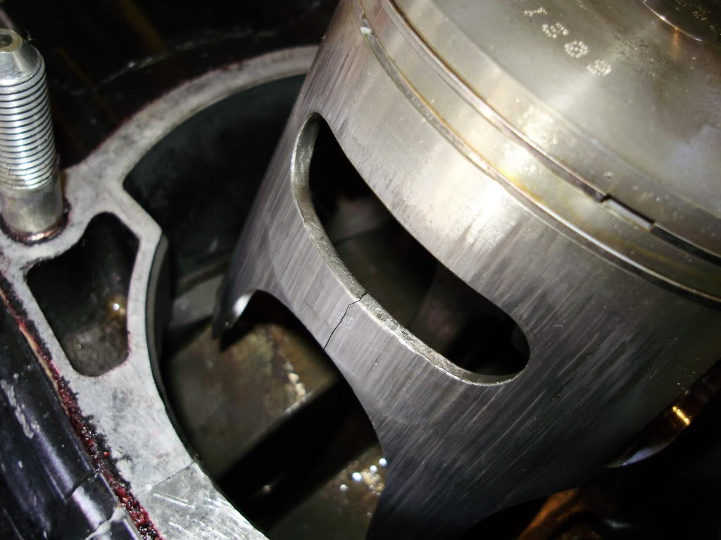

Be careful and check periodically for cracks. I had one of mine crack but I caught it in time. Yours is not as extreme as mine but it doesn't hurt to check on it every now and then.

I see thats a "wiseco" piston. Did you ever try it before the wiseco with a stock piston,and what was it like compared to now?? Lots of scuff marks on that piston too...what do you think contributed to that?
It almost looks like the bore was worn which allowed the wiseco piston to expand too far (the wiseco's do that when they get hot),and something had to give,which in this case was the bridge in the boost port.
