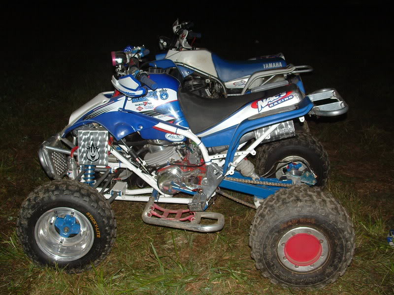

you could do what im doing and use raptor 660 nerfs with built in pegs and heel guards. here is a pic of a blaster with raptor nerfs. it takes some fab work like cutting pegs and welding, but it looks real nice.

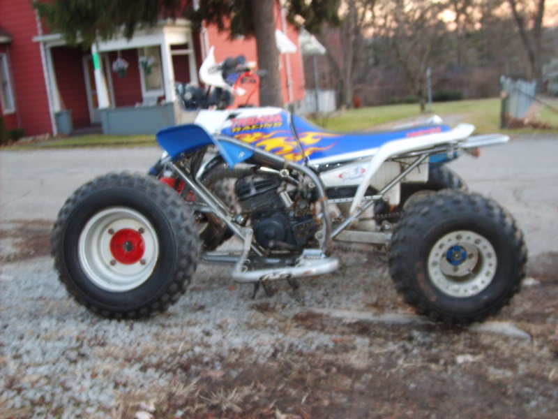

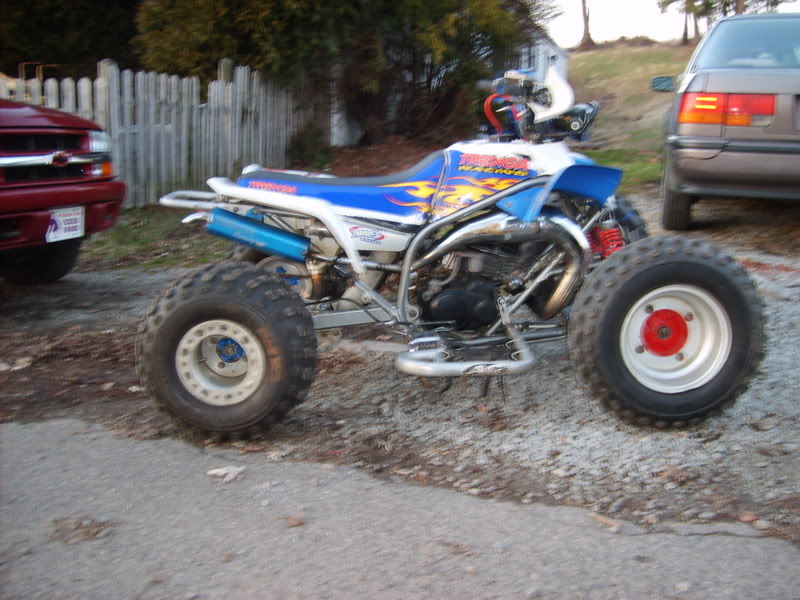

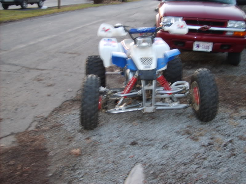

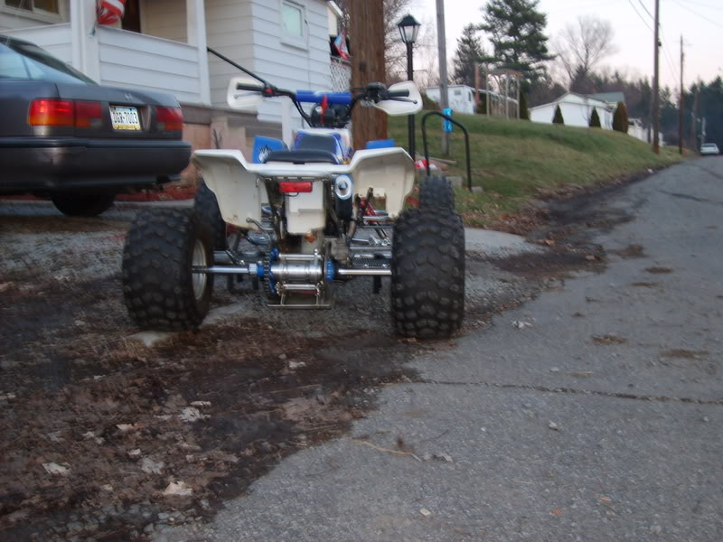

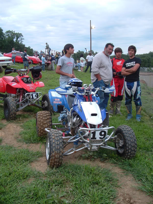

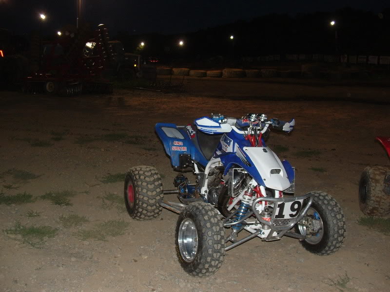

THESE ARE NOT THE BEST PICS, I DIDN'T CLEAN ANYTHING OFF BUT THE PLASTICS AND PIPE TO TAKE THESE
JUST CLICK ON THEM, THEY GO TO NEW PAGE AND GET TO THE ORIGINAL SIZE
