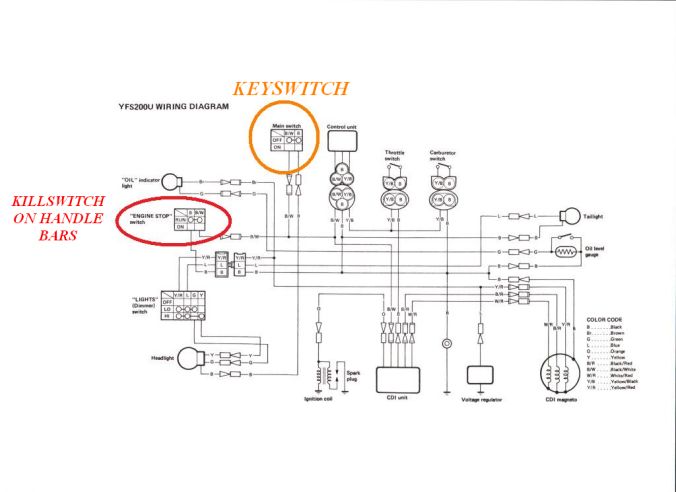

alright so i got plastics and new tires for it coming on the way. I think im going to pull the motor off the frame and sand it all down, and while the motors off, im gonna look at the carb and pull the bottom end apart. Is there a wireing schematic for the entire blaster?
i assume that when the previous owner had it they ripped everything off the quad and rewireed it and just threw on a kill switch.
Found out the problem, I had a jet that was very lose and the carb was extremly dirty. After cleaning and adjusting the jet and the throttle, it runs much much smoother. Now im taking on the task of rewirring it. In order to rewire it, do i need a key ignition? i havnt seen a diagram with a key on it. so should i buy one or do i not need it? im installing anew kill switch and light switch.
you do not need a key switch, it does the same as the other killswitch...connects a black wire to a black/white stripe wire, grounding out the ignition
the wiring diagrams are here..........
http://www.blasterforum.com/engine-13/stock-wiring-diagrams-51842/
