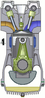

That is actually, your transmission or gear box, some people cll it the crankcase, because the crank is housed there as well, but it is sealed from the rest of the bottom end
gears are separated from the crank/piston/cylinder on a 2 stroke only thing lubing it is the 2 stroke oil.
only thing lubing you clutch/drive gears is the tranny/gear oil 10w30w.
4 stroke engine the gear/tranny oil lubes the whole shabang....thats why there is oil rings on the pistonso_O
