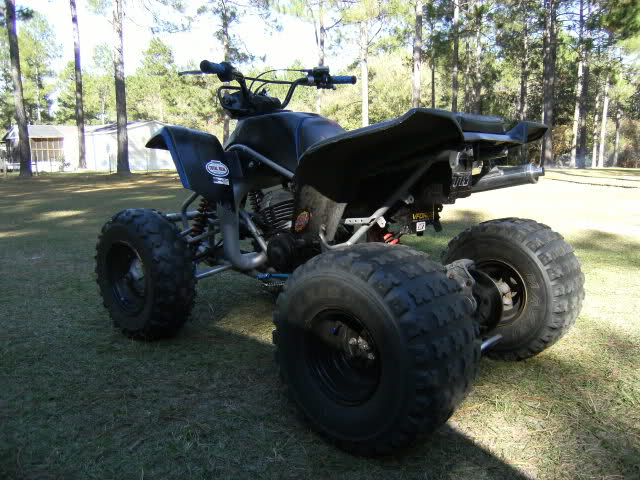

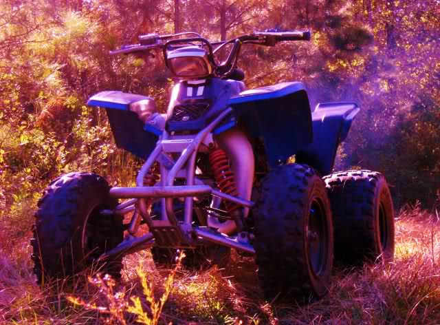

I traded my old dirt bike for this thing about 4 years ago. It was in horrible shape. Look like it sat in a pond for awhile. I disassembled the thing and sandblasted all of it and the plastics. Painted the frame n all with rust oleum hammerd silver paint, and painted the plastics with krylon fusion plastic paint black and blue. Ive got the parking brake eliminator, new chain sliders, grips, levers, petcock, and shifter.
I also split the cases to put in new weisco crank and rod. Std. bore cylinder w/ wiesco piston, vforce 3 reeds and 3/8 spacer i made at work on cnc mill. Full Toomey Exhaust Had to put in new shift shaft. New Barnett clutch. Also removed oil pump and made block off. TORS eliminator as well.
These are just a few things ive done with it. really to meany to list, its far from done.
I wish i would have took before and after pics. its not the same blaster as it was.
