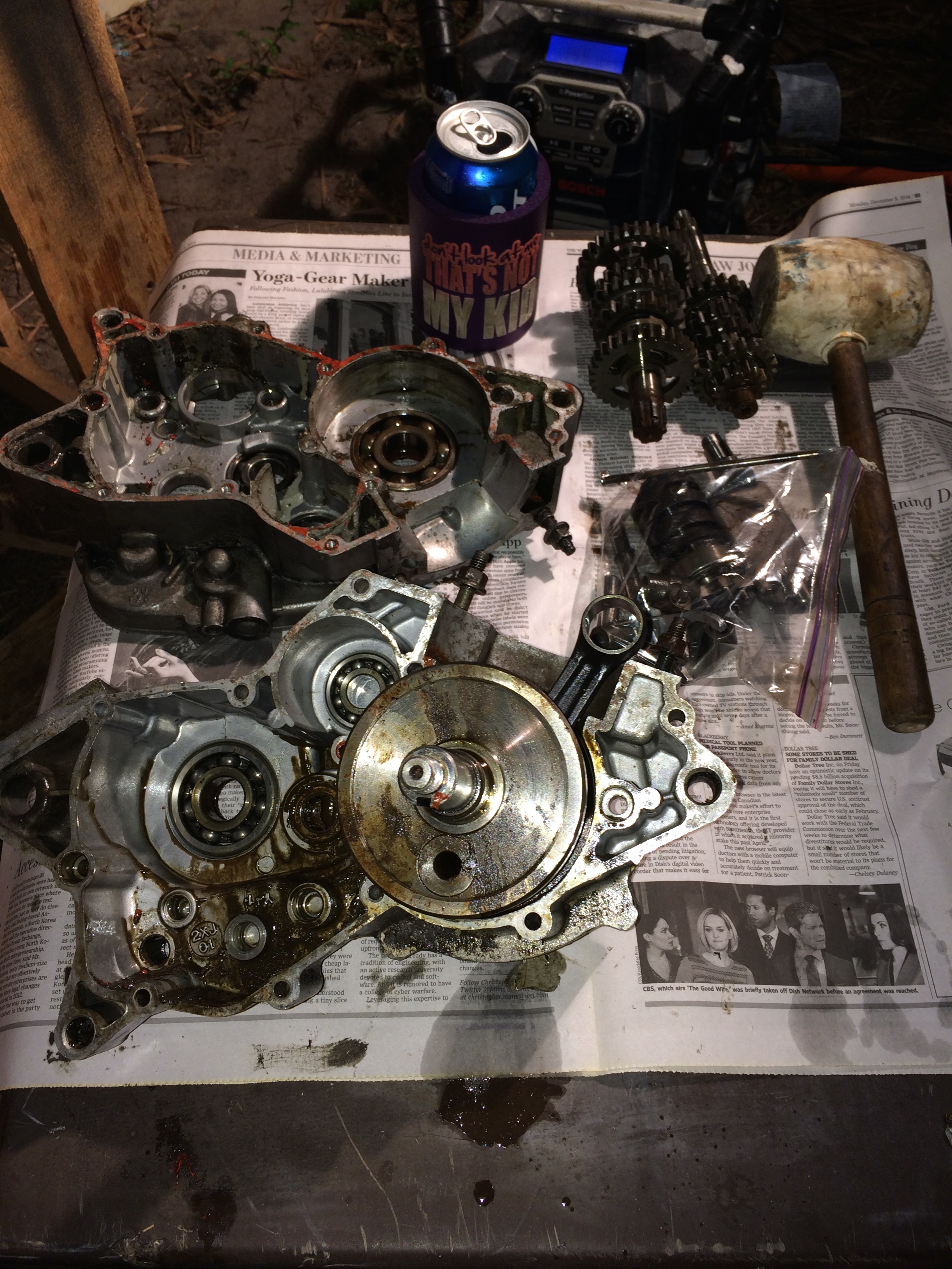

Finally got the motor apart main drive gear was put on backwards.. (i think thats what its called)
Christmas has all my blaster money tied up at the moment but am planning on ordering the new main bearings and seals and all the other little things I'm gonna need, Circlips, lock washers, gaskets etc. From KOR when i send him my cylinder to bore and crank to rebuild once i save up some more cash. Im looking at around another 450 bucks for everything i need.
I had recently purchased a crank and both engine halves from a guy on here and i believe its an OEM crank so ill be sending that one. Mine has a wiseco crank in it now. And from what I've read they're trash. Maybe throw it up on ebay for a few bucks and see if i get any bites. We'll see. heres a quick list of what I've got left and a few pics of the engine tear down..
Oh! and the little clutch ball has been welded to the shaft. ill have to replace both of them correct?

View attachment 13342 View attachment 13340 View attachment 13341 View attachment 13339

Well guys i was fortunate enough to come into a little bit of extra change in my pocket so i sent my engine off to KOR to be put together. Which was a very wise choice in my opinion. lol But its in his intensive care unit as we speak should be out of surgery in under two weeks.
He's rebuilding my crankshaft, new main bearings, New seals everywhere, rebuilding bottom end, whole top end including the bore, sandblasting and painting everything , had a cracked shift fork, and a bent shift shaft and a cracked right case that i completely overlooked but he hooked me up very well on it and i couldn't be more excited to get it back and finally ride.

Got the call yesterday from ken that my engine is finished! Should have been shipped yesterday and will get here sometime either friday or monday. will definitely post up some pics of that when it arrives,
It got an entire overhaul.
rebuilt the crankshaft with new pro-x rod,
almost all the bearings were replaced,
the right side case was cracked,
he said my shift rods were mushroomed at the tip,
clutch actuator was crap,
bored and honed with wiseco 67.5 piston i believe he said,
Also he told me spent a few hours cleaning up the port job the PO had on there
I know theres more i just can't think of it right now
as you can see in the first post it was pretty ugly, and the previous owner had no idea what he was doing with this thing, And just removed all kinds of sh*t, like rear brakes, and all chain sliders and rollers (why the hell would you do that?) I've almost got all the missing parts just waiting for a few small things and i should be ready for heat cycles!!!
