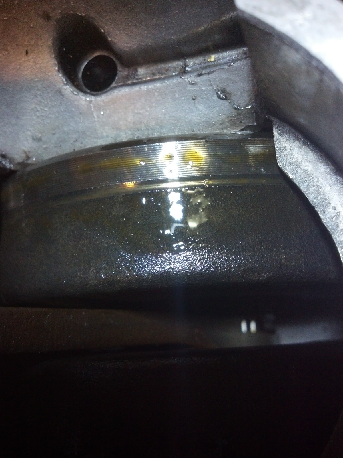

What piece is that a pic of?

Are you sure thats a crack? it looks like "casting flash" to me by looking at the picture.
casting flash and its unatimous probably a casting flash
That seems to be the general concensus is casting flash. Thanks guys. The picture is the top of the crank and what I thought to be a crack is the inside of the right case. You can see a bit of the connectimg rod in the picture and it is leaning towards the front of the bike. I'm on call until Sunday so I will try and get back after it Monday I hope...
