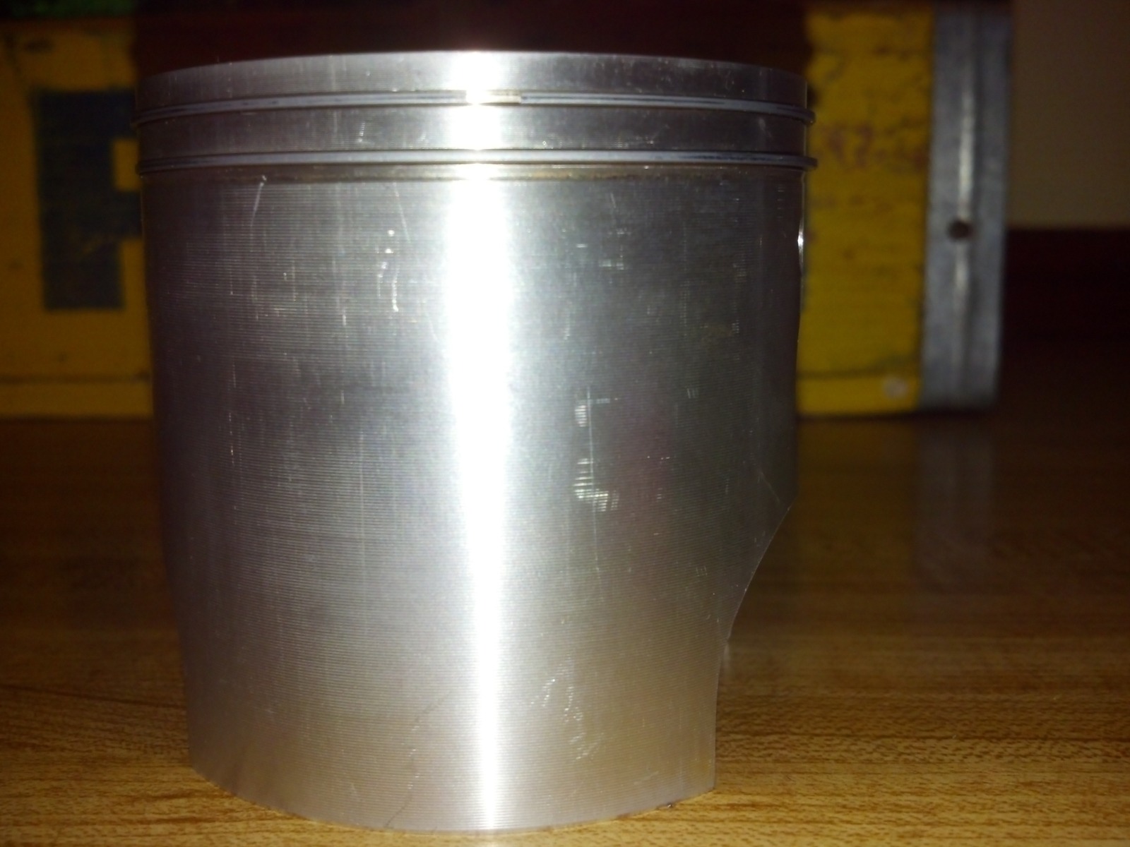

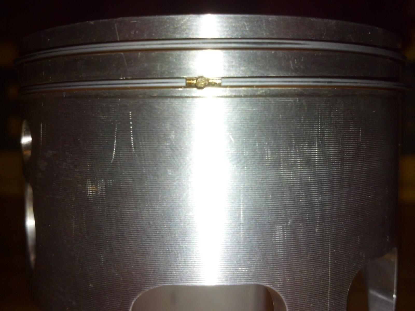

The top ring in this pic is not proud enough of the piston for it to have a peg in it.
I should like to see a pic of the exhaust or front side of the piston and the underside of the crown, to see wether it was suffering detonation.

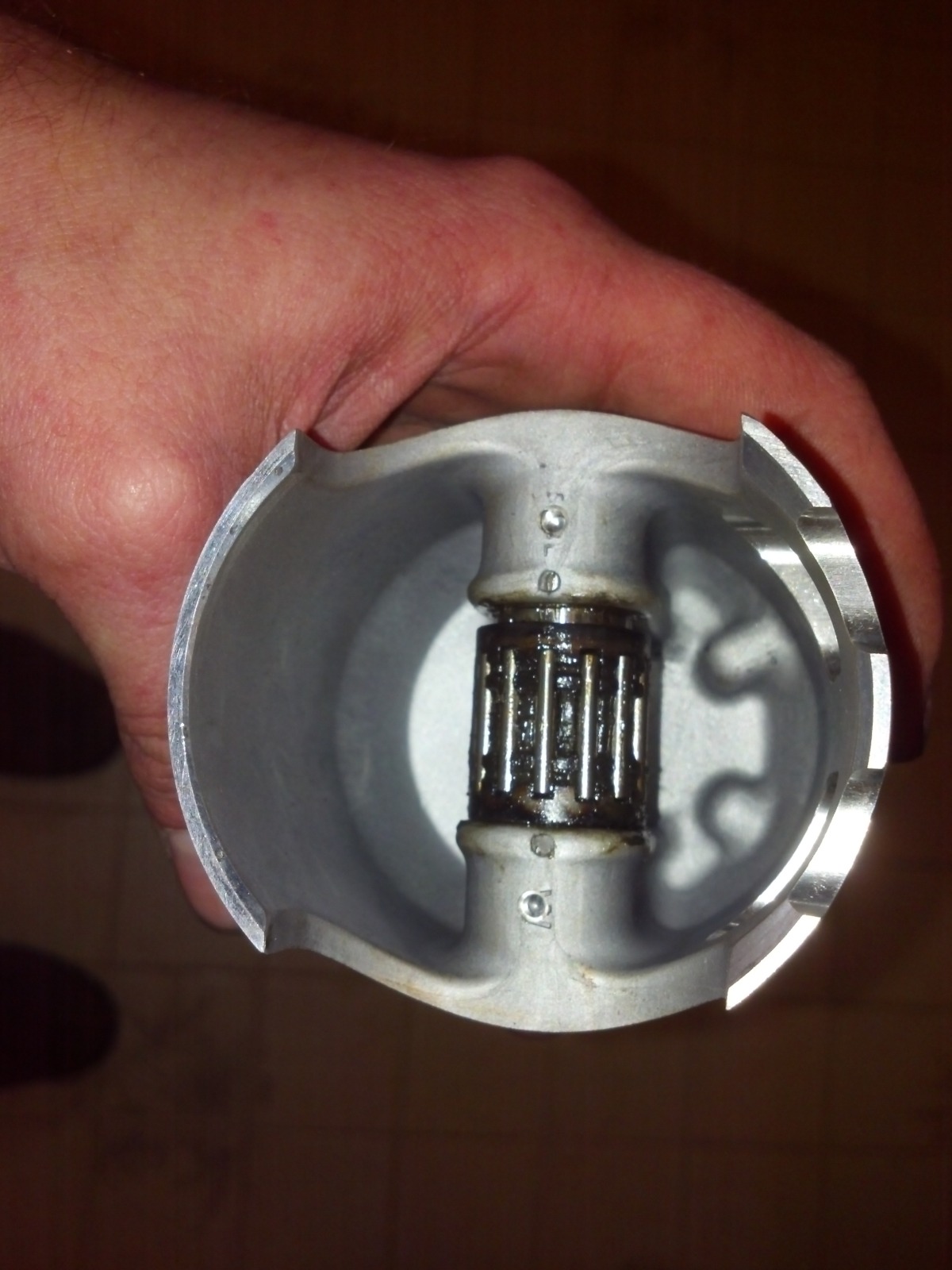

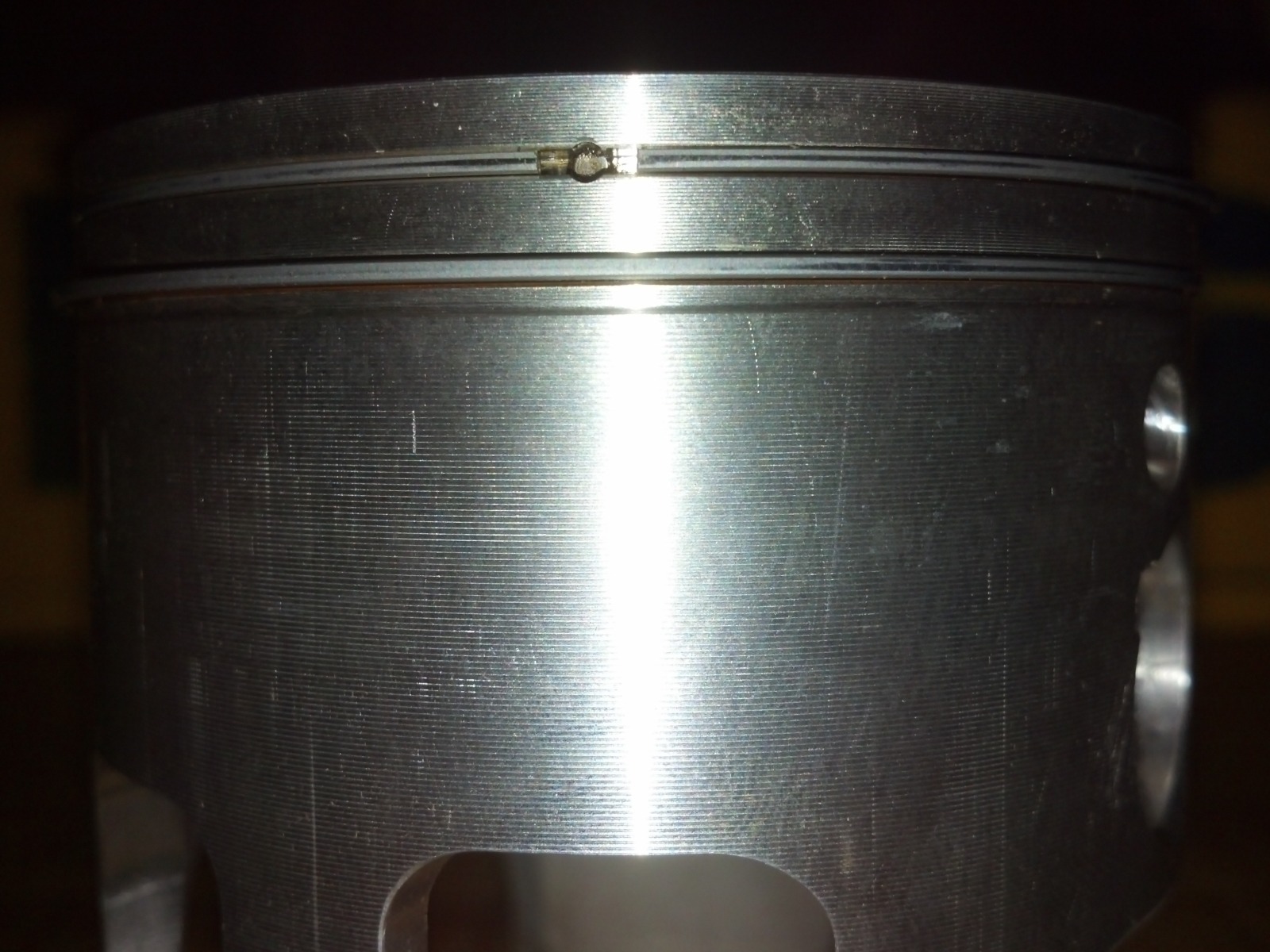

I looked closer at the piston this morning I can see pins but it looks like maybe they broke off? I will post more pictures when I get home. I can't post pictures from my phone, unfortunately.
Do another picture of the piston verifying that the locating pins are in there.My "guess" is they are. We're assuming they're not,so lets make sure they are before we procede.

Welcome.and your talking to some good guys here who really know what they're talking about..best of luck. Do you have a pic of the piston as if your looking into the piston.from the inside of the piston..like Browning or black burnt marks??
sorry for the dark pictures. i assume thats what you guys were after? the guy at the bike shop said the cylinder was egg shaped and i would be better off to start with a stock bore cylinder so i believe thats the unfortunate and expensive route im gonna take. the guy said whoever i took it to didnt do the cylinder job right and he went into detail about gooves in the clyinder and such so i dont doubt what he said. he also commented on the rings and how they didnt seat in the cylinder and how it took chromoly a lot of heat to expand etc etc. so now my plan is to pick up a used (hopefully stock bore) jug and new piston. i dont think i have any other options do i?
Looks like the bottom peg is there but the top one looks pressed in too far.
Any way you cannot use that bore as it is, either have it sleeved or pick up a jug with a few bores left, grab a new piston and proceed from there.
The underside of the crown shows no sign of overheating.
