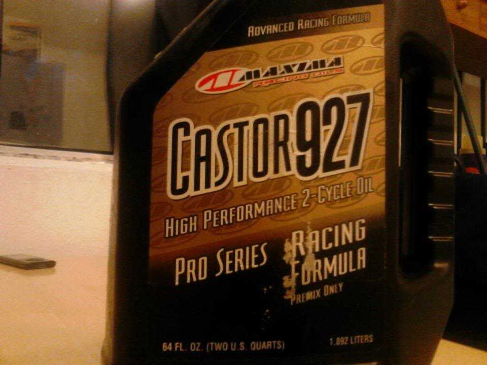

What i would personally try is going back up a jet and drop the clip on needle one. Is it a stock needle? Just sounds like a similar problem i had once. And, just as far as oil, I've been sold on castor oil
:o NOBODY IN THEIR RIGHT MIND WAS EVER SOLD ON CASTOR OIL....lol. That's the stuff your grandma used to shove down your throat when you were sick.
I'm pretty sure you mean Castrol Syntec???
Been using castor since 1973. Put a bazzillion hours on my Elsinore, was only halfway to service limit when I tore it apart. Unfortunatly they don't sell Castrol R30 in the U.S. So it's Klotz Benol for me.
Yeah, I guess I'm sold on it, and my son is too I:I. LOVE the smell I:I B)
I wouldn't use synthetic to break in a fresh top end. It lubricates too well which may not allow your rings to seat properly.

NO. I mean.

Gees am I the lucky one, I have just made the switch to Castrol R30, due to the unavalibility of Maxima 927.
Can't comment on it yet as I have only been usuing for a few months, but it still smells a sweet as the 927.
