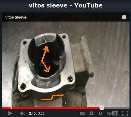

As luck would have it, I have two Vito’s cylinders in the shop that need to have the sleeves replaced. Once I got the first one cut out, I knew I needed to shoot a video. Pretty cool, check it out.

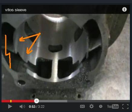

Might be my terminoligy. Where transfer tunnels start at bottom of cyl. The sleve at front (main) transfer is higer than the rearward (secondary) , it looks about 3/16-1/4 lower in that area.
i noticed that too...
but the sleeve matches the cylinder casting .......
maybe has to do with the boysen/boost ports ???
Had to find images of stock cylinder, they're same way. But not all cylinders have that step of the liner @ transfer. Stock Banshee does, some aftermarket cyls do, some don't.
