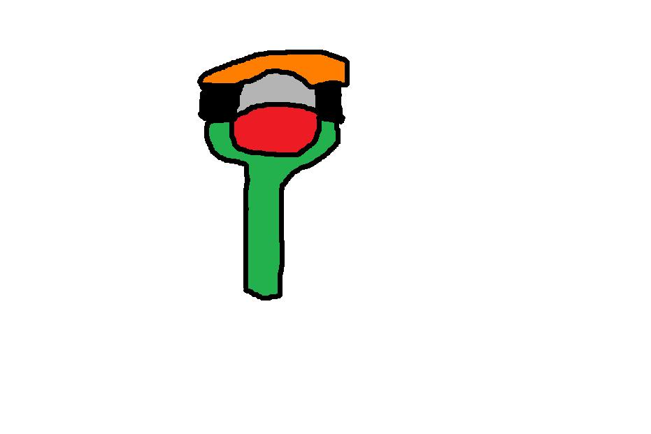

Seeing as how the bars clamp directly to the stem i would say no because if you add rubber the bars wouldnt be able to clamp down, you would have too much space between the upper clamp and the stem.
Crappy diagram drew up to explain my reasoning, the green being the stem, the black being the rubber, the red as the bars, orange being the clamp and the grey area would be leftover space for the bars to flop around.
"the grey area would be leftover space for the bars to flop around"
