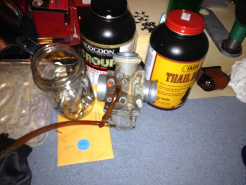

Cleaned my carb again, didnt think first time was enough. Got jet installed. Never thought it was that simple.
Cleaned carb x2. Did it on my reloading bench, obviously

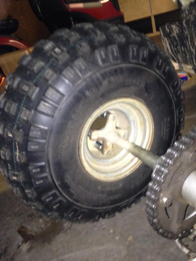

Cant really tell but flipped front and new pads.

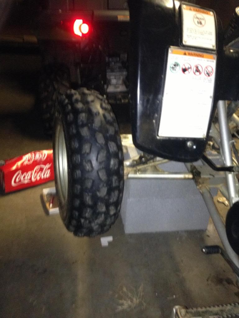

and last pic spaced rear!
