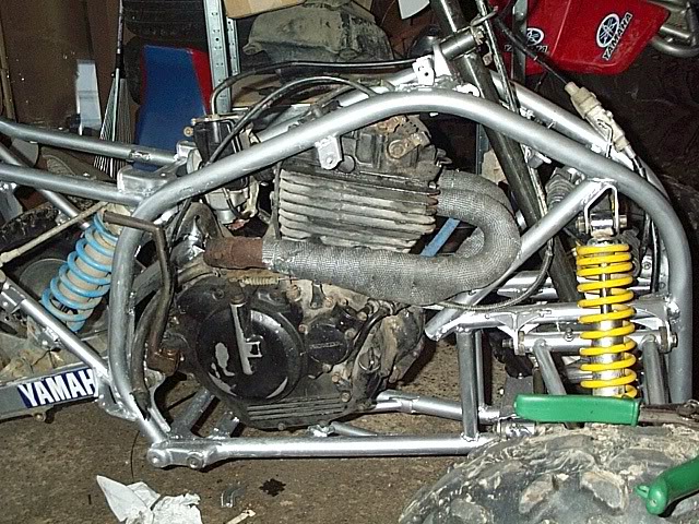

hello all, i'm new here but have been putting together a blaster which i've wedged in a honda 350x 4 stroke (had it from an old bike)
so far the motor is in place, all the brakes/bearings have been replaced, located the oil cooler in the nose....
things left to do, piece together the exhaust, buy a chain, and make a gas tank and cover......so far counting what i made on the parts i sold (old engine was blown) i have about $180 in the project (including the blaster, it was a tip from a customer).....

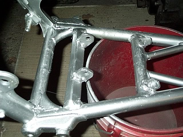

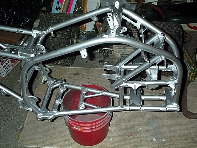

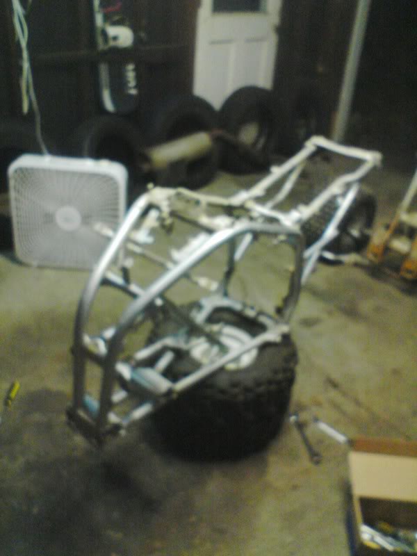

the frame was roughed up, primered and painted.....the top pics were from mock-up....the bottom 4 are after paint. next time i have it torn down i'll send it out for powdercoat.
personally i've never liked the 2-stroke 200's in the blaster so i didn't want to spend to put the destroyed one back together. i've always liked the torque of 4 strokes, and like i said i already had the 350x.....so in it went :D

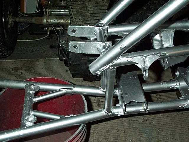

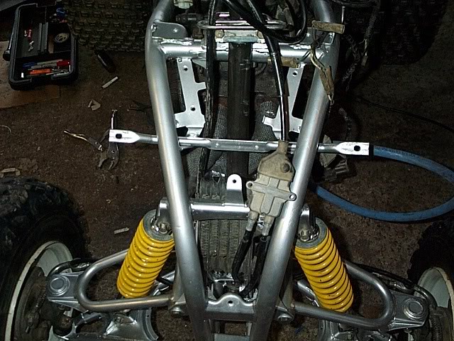

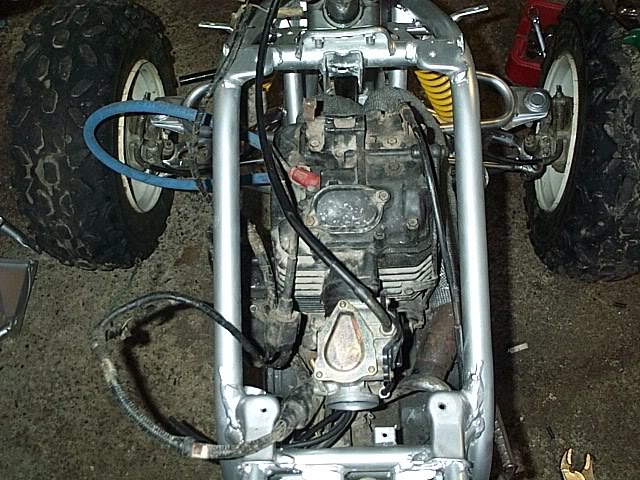

we did alot of measuring to be able to get it in without butchering the frame, the added beams and the way we boxed in the front lower mount really tightened up the frame to handle the extra weight/torque..... it's a real pia to install or remove the engine as you need to "clock" it into position once it's near the mounts and it's pretty heavy, also need to pull the steering stem to get the exhaust in place :D
it lined up very nice, i'll probably need to fab up some chain runners though.
it's already been running with an open pipe and a temporary gas tank, i should have my head back this week from my machinist so i can start to button it up.

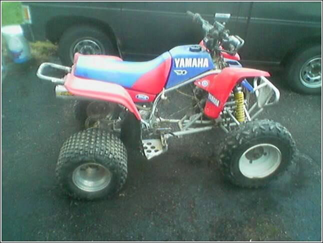

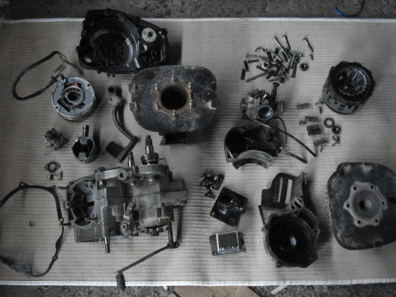

here's what the 200 engine looked like when i got it, the piston had major slap and caught an edge destroying the piston/cyl wall etc.....
so....rebuild an engine which was in pieces and missing a bunch of little stuff.....or drop in a good running 350x, i chose the latter :D

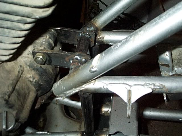

was it hard to mount it to the swingarm/motor bolt? i looked at some of these motors on ebay and the hole where the swingarm/motor bolt is looks pretty small to fit that bolt.
i added new beams for my mounts, we thought about making it work with the swingarm bolt but found a better solution once we got the engine sprocket lined up where we wanted it.
here are some pics of the pieces i added for my mounts, i will use a long tubular insert for where the stock engine mount was so the swingarm will still function properly.
being the sprocket is a little more forward than the stock engine i'll be making some chain guides, and probably a tensioner sprocket since the geometry of the chain changed.

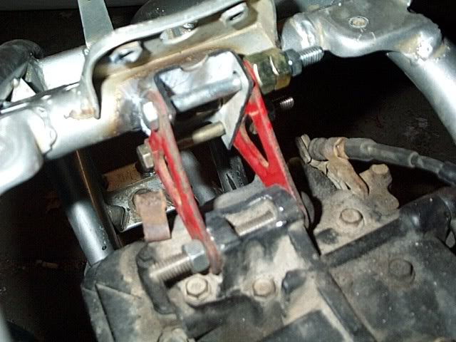

the top mount can be removed to make room to clock the engine into place....
