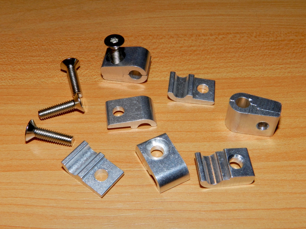

Brought the brake line clamps for my swing arm.

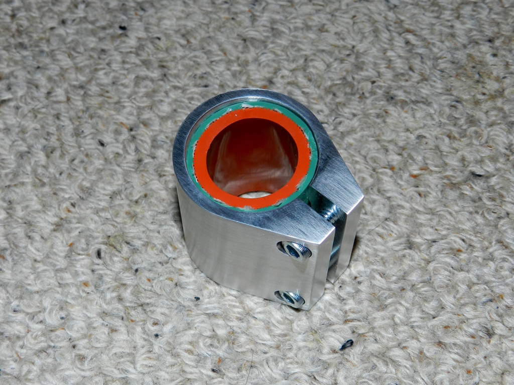

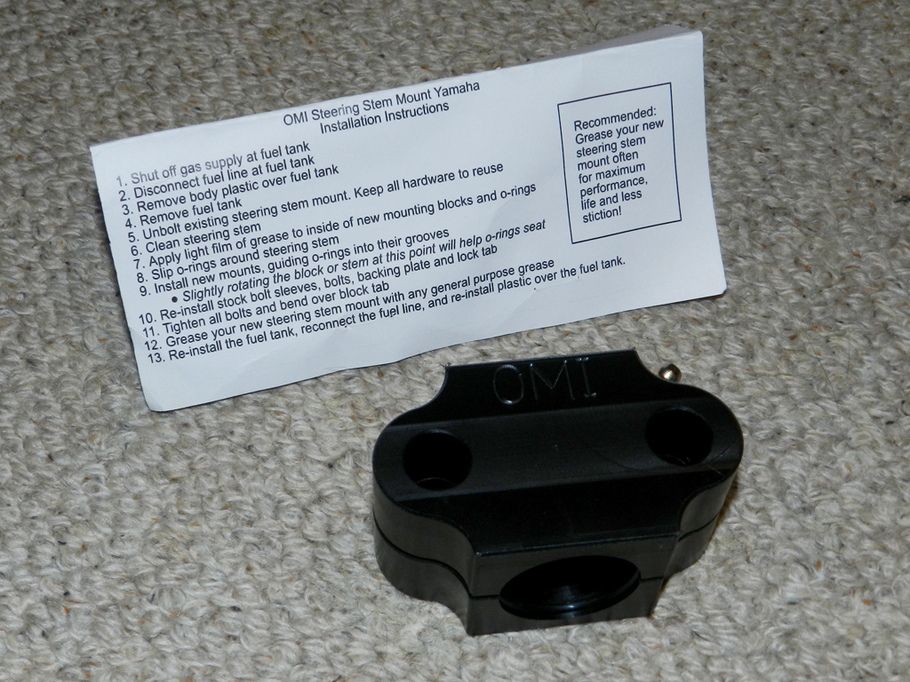

Also go a new Steering stem cable guide plate to replace the twisty style one I had.
Old style.
New style.

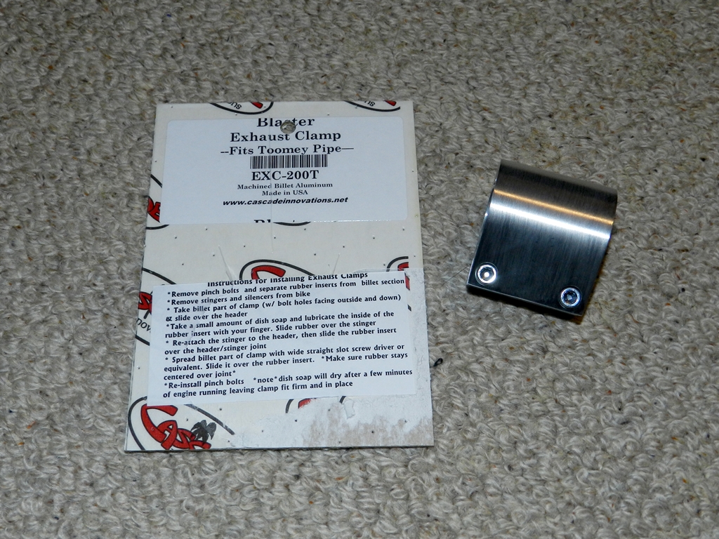

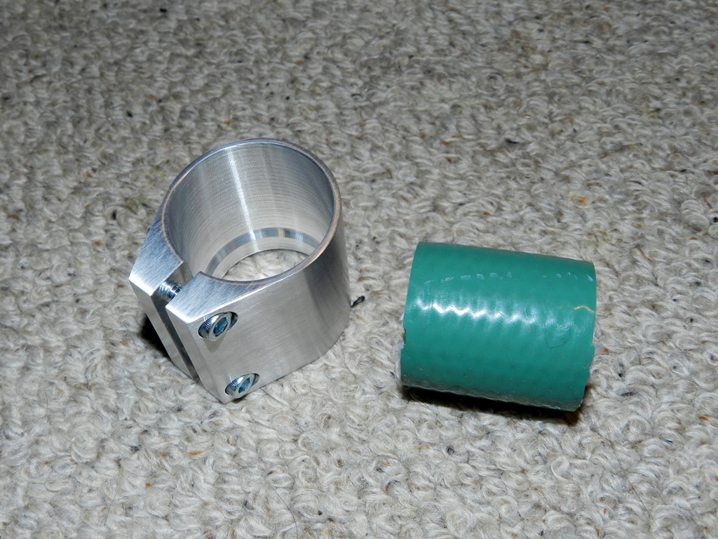

Ordered my exhaust clamp after emailing Cascade Innovations to get some info about fitment.
Cascade Innovations exhaust clamp.
I will get some photos and let you all know how it goes.
nice stuff mark !
this may not apply to you mark, as you're into a full rebuild, and fuel tank is usually one of the last parts to be installed.
but for anyone else seeing this.....#1 thru #4 in those directions - shut off gas to remove fuel tank
there is no rhyme or reason any of that needs done to replace a steering stem block

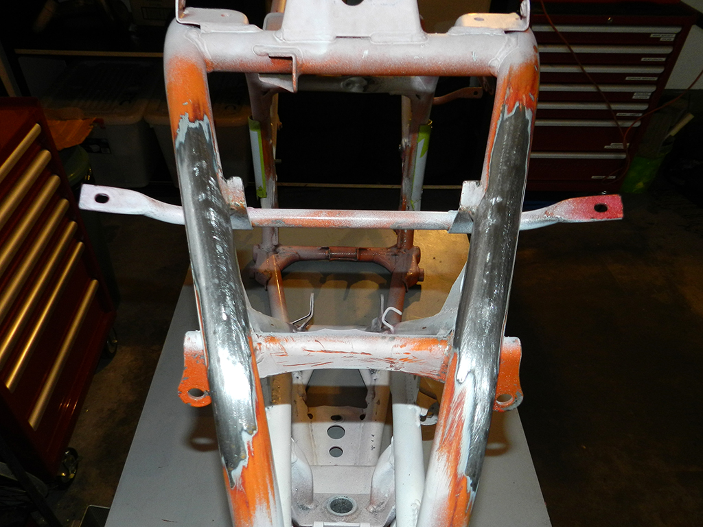

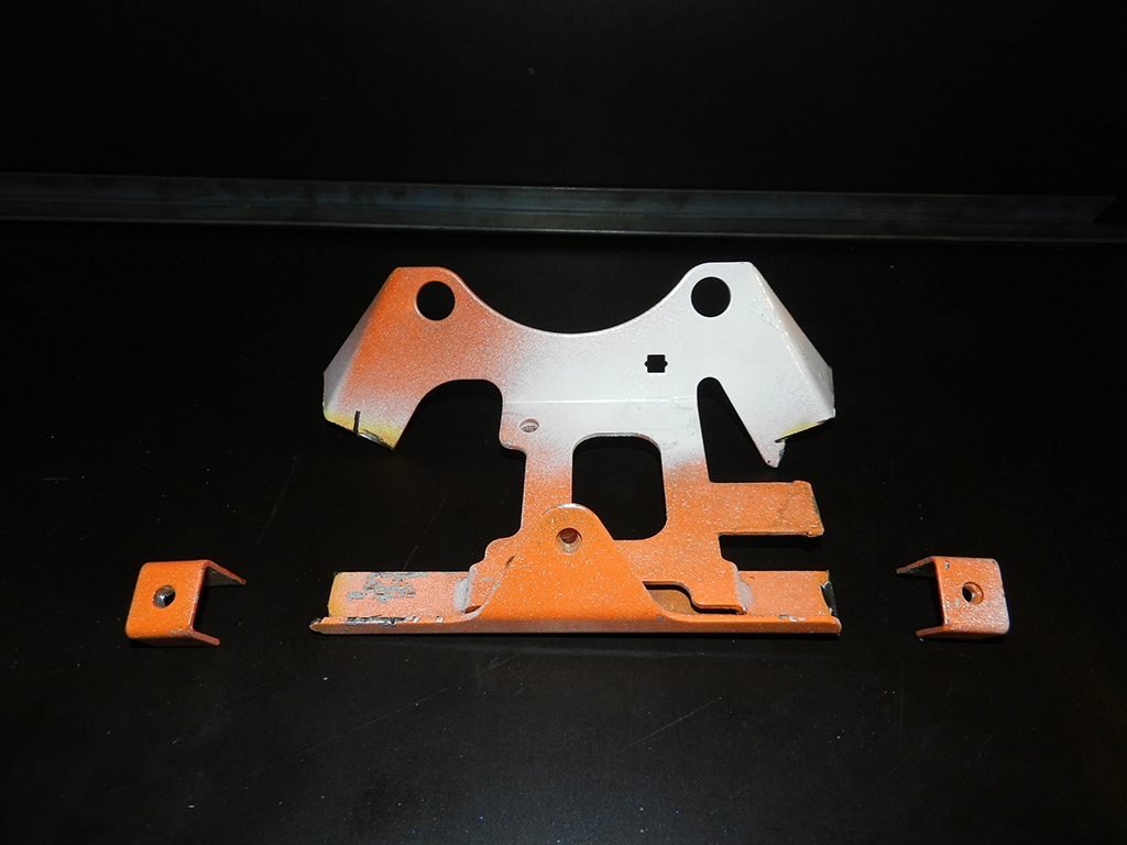

Got into the shed today and attacked my blaster with a disc off disc. :)
Headlight / CDI / voltage regulator mount and front fender mounts need to go.
Removed.
BOOM all gone. Cleaner and better air flow.
Now to work out a pace for the CDI box and make a bracket for it.

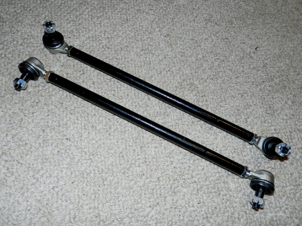

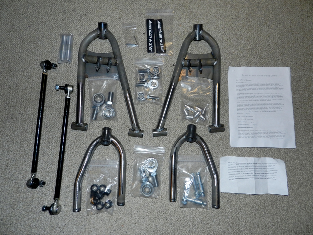

Got a package today. :) Yippy my front end is here. But they sent the wrong tie rods. :( I asked to have the 10mm stock tie rods upgraded to the 12mm MX PRO Chromoly Racing Tie Rods & Ends. Have contacted them about it.

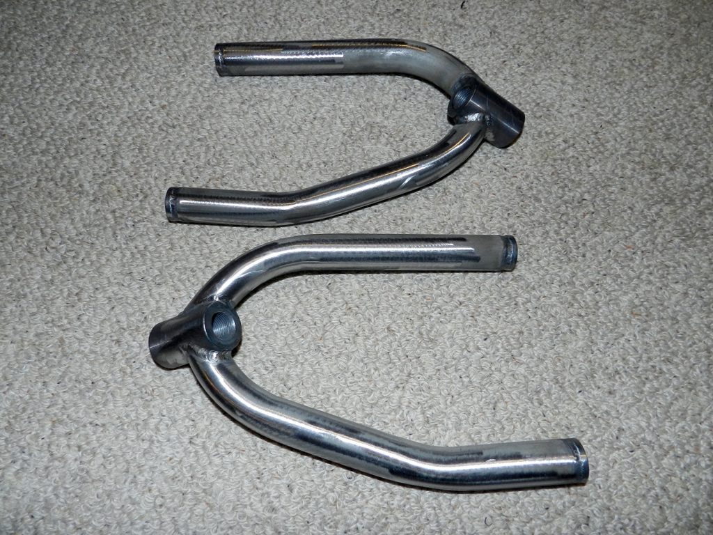

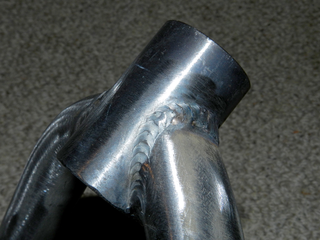

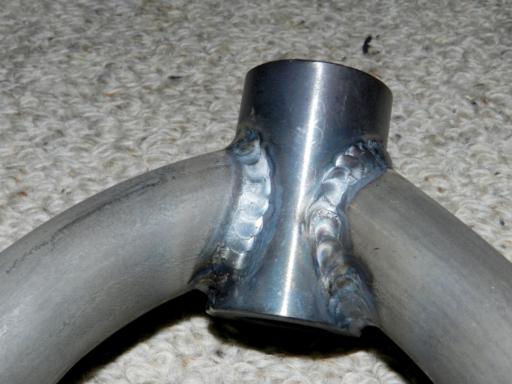

Photos of nice new parts.
Welds

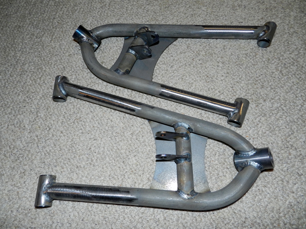

Now that I have my A arms I can start drawing up custom skid plats for them . :)
Will post images of my design as soon as I have done it.

Brake line clamps.
Exhaust clamp.

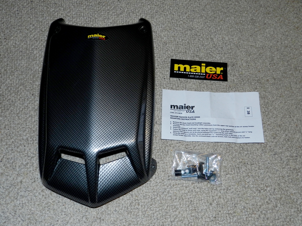

Hood.

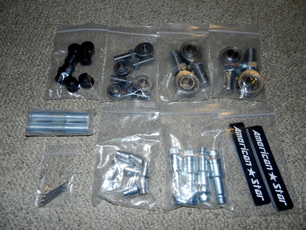

How do those upper a-arms attach to the frame?
Nevermind, I see the 4 extra heim joints. The tubes must be threaded?
