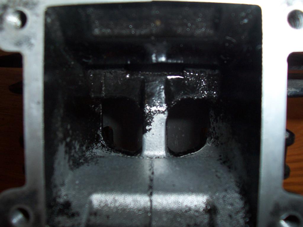

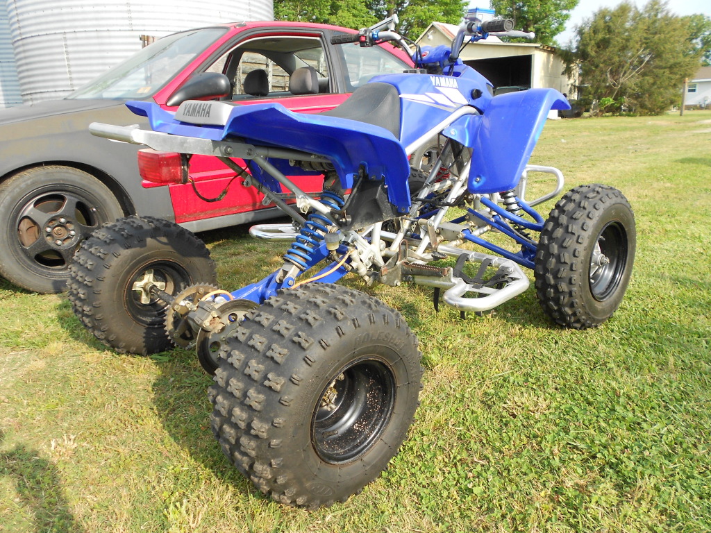

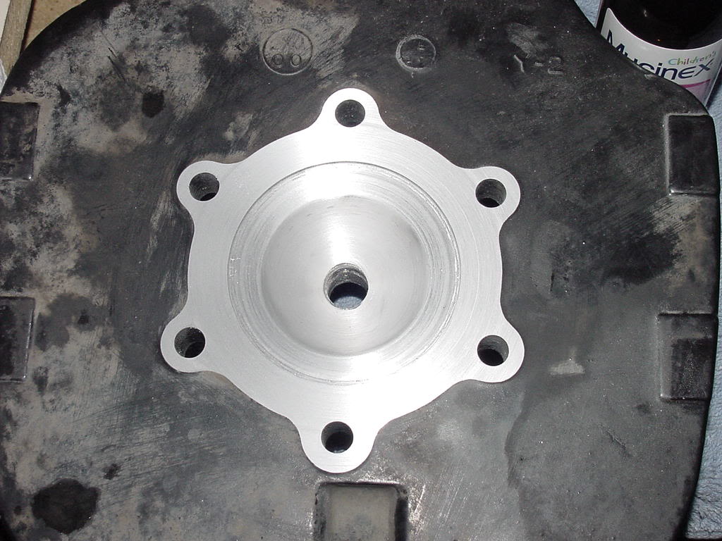

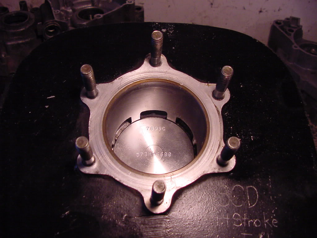

Did you see that 4mil stroker bottom end a few pages back? The blue 03 will be it's new home. :)

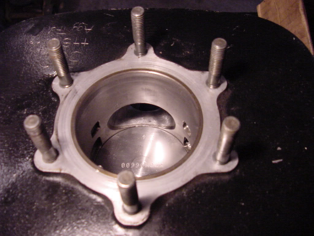

Same type of port job the stock stroke that came out of it had. If I ever have the money to do it again. Lol as far as pipe and carb go ptobably another right bend or toomey and my 35mm a/s and a 34mm pwk for the 06.

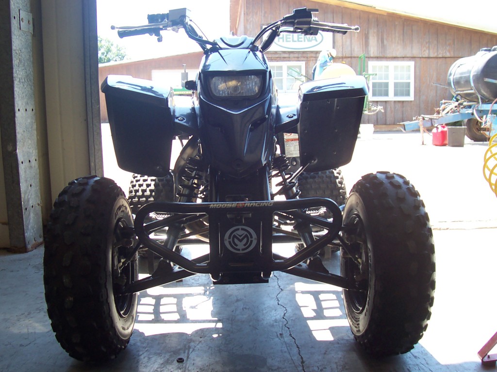

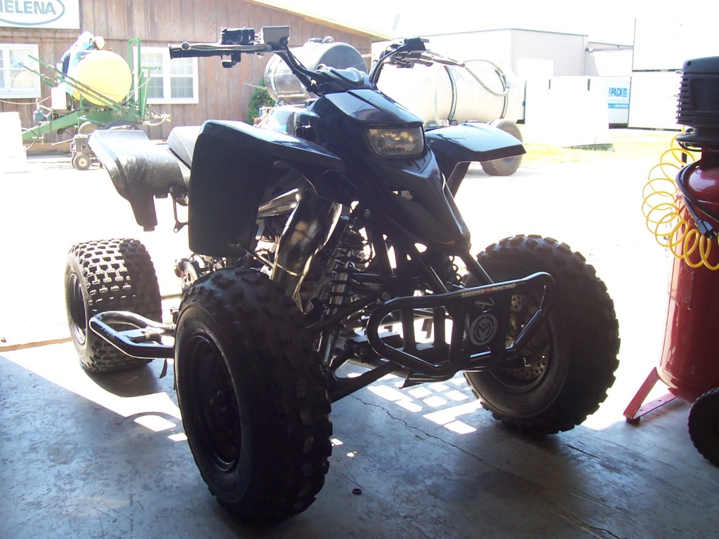

Sneak Peak...
More to come at 11....

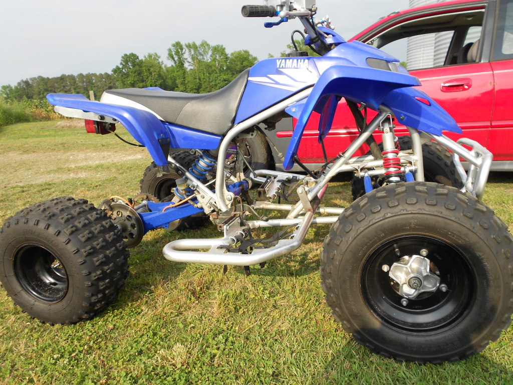

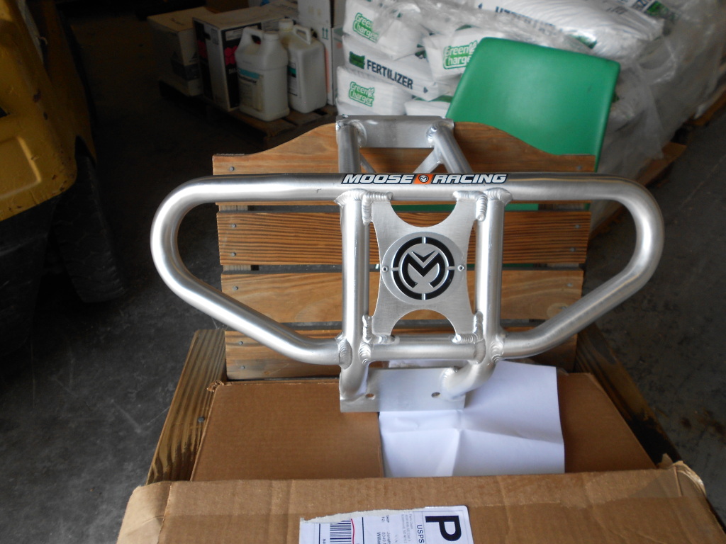

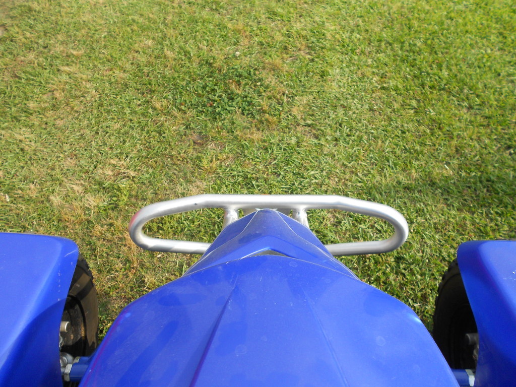

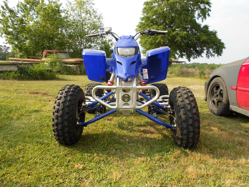

Finally a great looking bumper for the Yamaha Blaster. Moose Racing FTW!
I will be ordering one in Black for the 06 after I finish the motor for this 03. :D

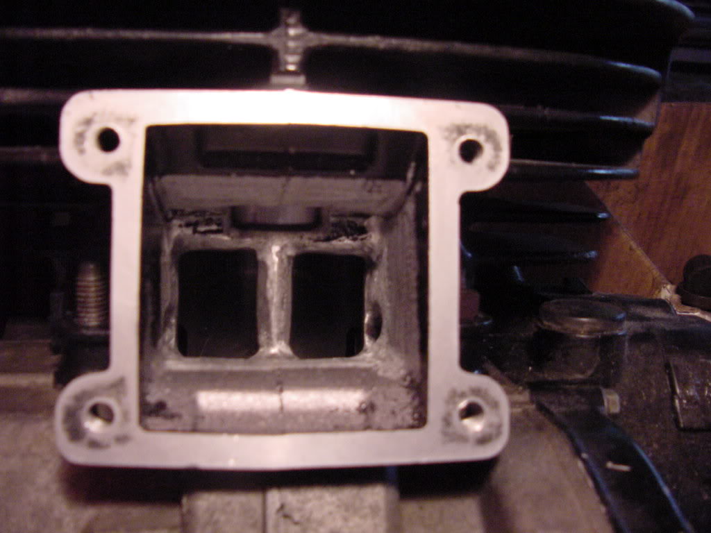

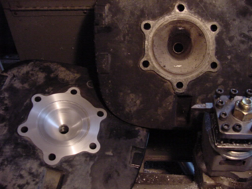

Yep, I didn't cut down the bridge. I widened the windows and raised them quite a bit. We'll see how this design holds up and puts out powerwhen JonS gets this engine back and bolted onto the "blue meanie".
