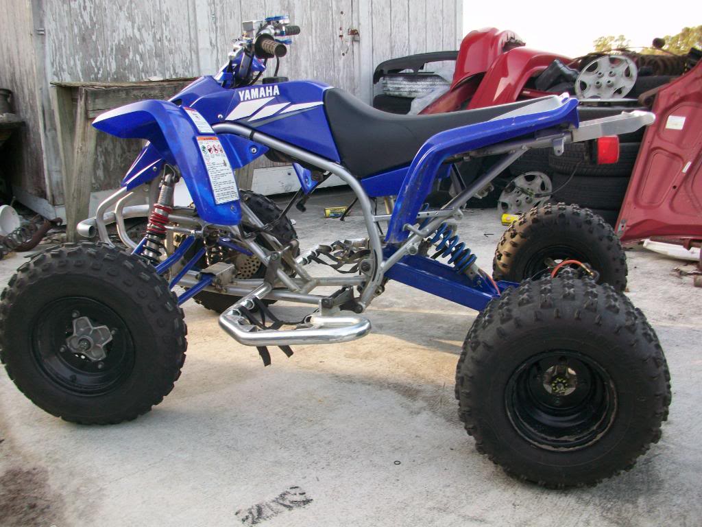

those spacer were not right. they should have studs in them and mount to the studs on the hub.not bolts all the way through like that. lol someone rigged that chit
i have no idea. stupid though, very stupid.
They do make ones with studs in them, But also the old style are clean through , I had a set, and you have to use longer bolts, not rigged just a crappy way of extending! I like those screw on extenders im have for 15 bucks can go wrong and I have used them riding awk mountain with no issues!

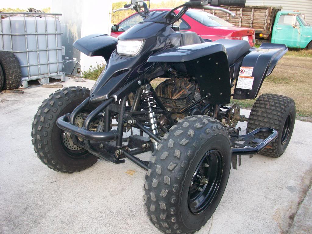

Well, I had a very productive day yesterday. Stripped one and built another.

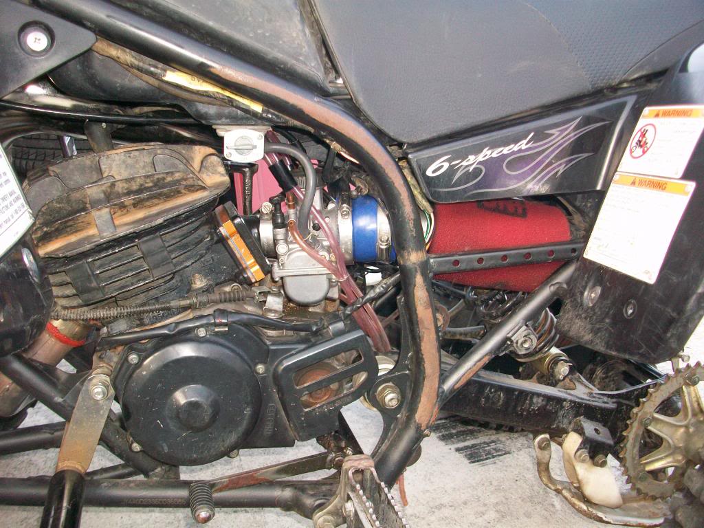

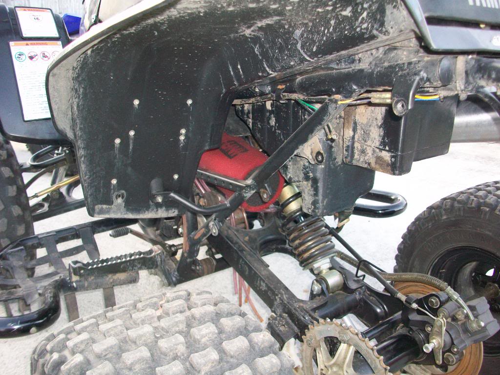

My nifty little direct filter system i made. Got tired of the cfm box and it was off a lot anyhow. I hacked into it and stole the air tube. Fits in there nicely and this direct system has waken this motor up a lot more. I was rich before doing this and the extra air making the mixture about perfect. I will still do another plug chop soon to be sure though.
Actually durablue makes 2 diferant kinds, one that the bolts are a permanent part of the spacer and the other cheaper style that the bolts are seperate like the ones that he had.

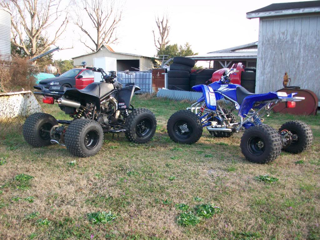

You should run these front tires on them black rims that would be a perfect setup man
i had thought about doing that, but i'm just gonna leave them alone. the stock tires off of the 06 were practically brand new.
But those tires are new if the ones that came off the 06 are like new take the ones off the 03
the 06 tires are on the 03. the 03 tires are on the 06 as it's just my beater blaster for right now. i still have a warrior too man. that's what the goldies came off of originally. just a good set of tires i got a great deal on.
