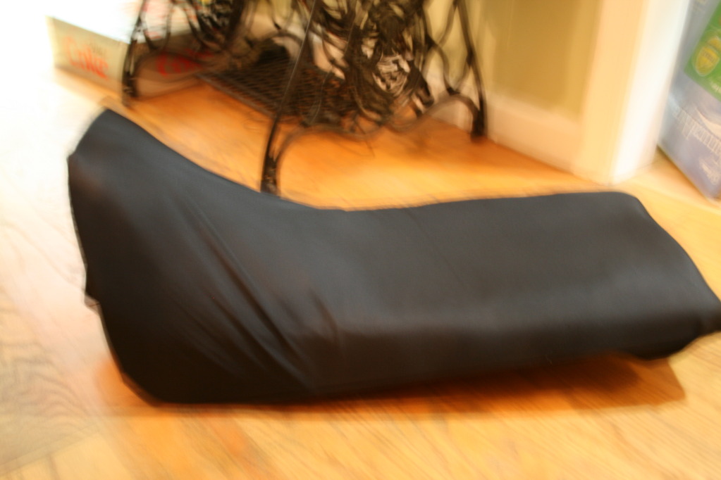

it looks better in person but i cant get that one wrinkle where the seat bends up but oh well its good enought
There is a technique. I made my millons as an upholsterer.
Staple centre front and back with a couple, centre sides with a couple.
Like making a cross but leaving enough material mto pull into the bend.
Now work at the bend to pull out the wrinkle.
Then work outwards from the centres to the corners.
Good luck and if you cant do it, freight it to me and I would love to help, but you pay freight.
well that was good advice iv just about got the wrinkle out
