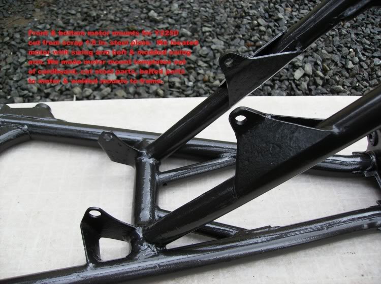

These are thin & light and haven't broke yet. 2pcs 1/8" on each front mount. Nice long weld. Prolly not runnin as much power as you but they been holdin up. Don't know what yours look like but ya don't wanna weld heavy 1/4" plate tabs to thin wall frame tube. Doubt that rubber will help that much.
