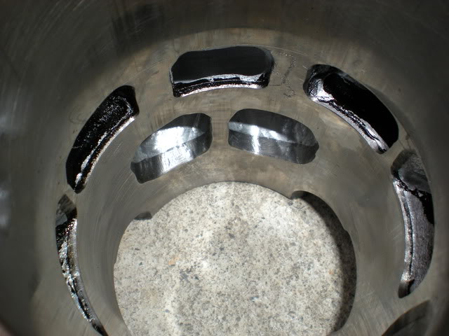

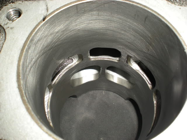

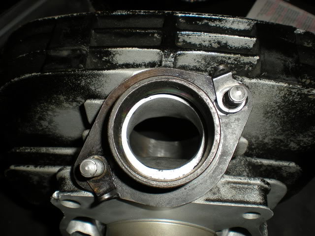

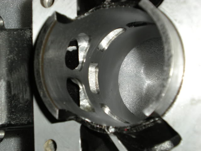

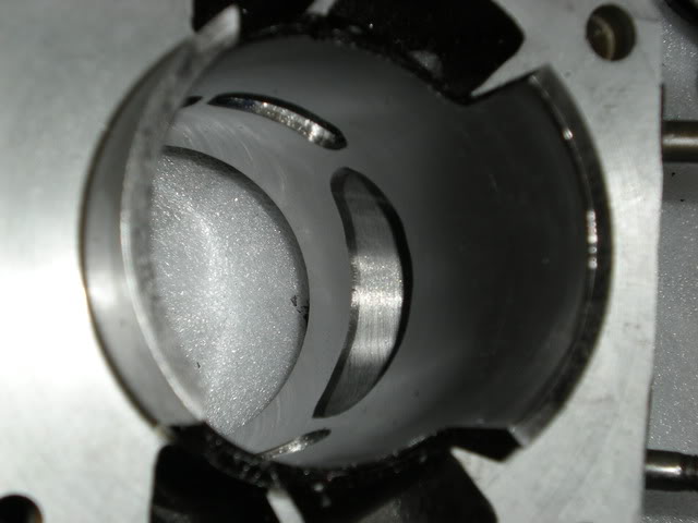

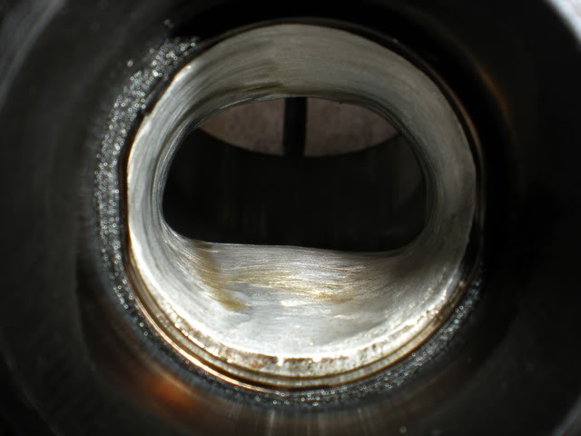

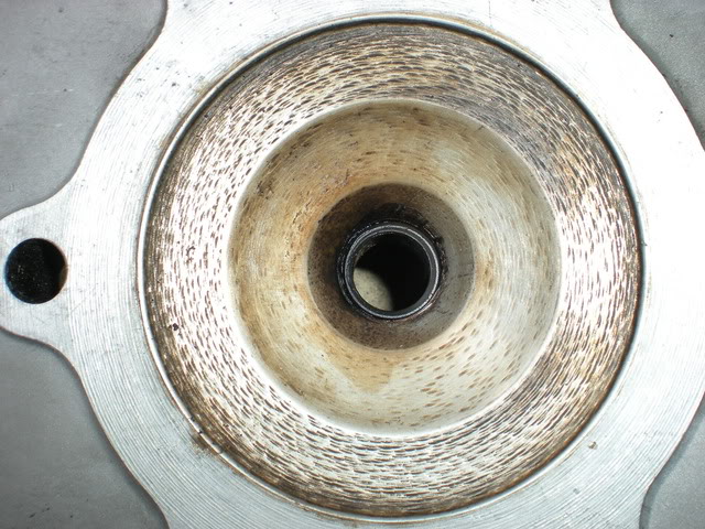

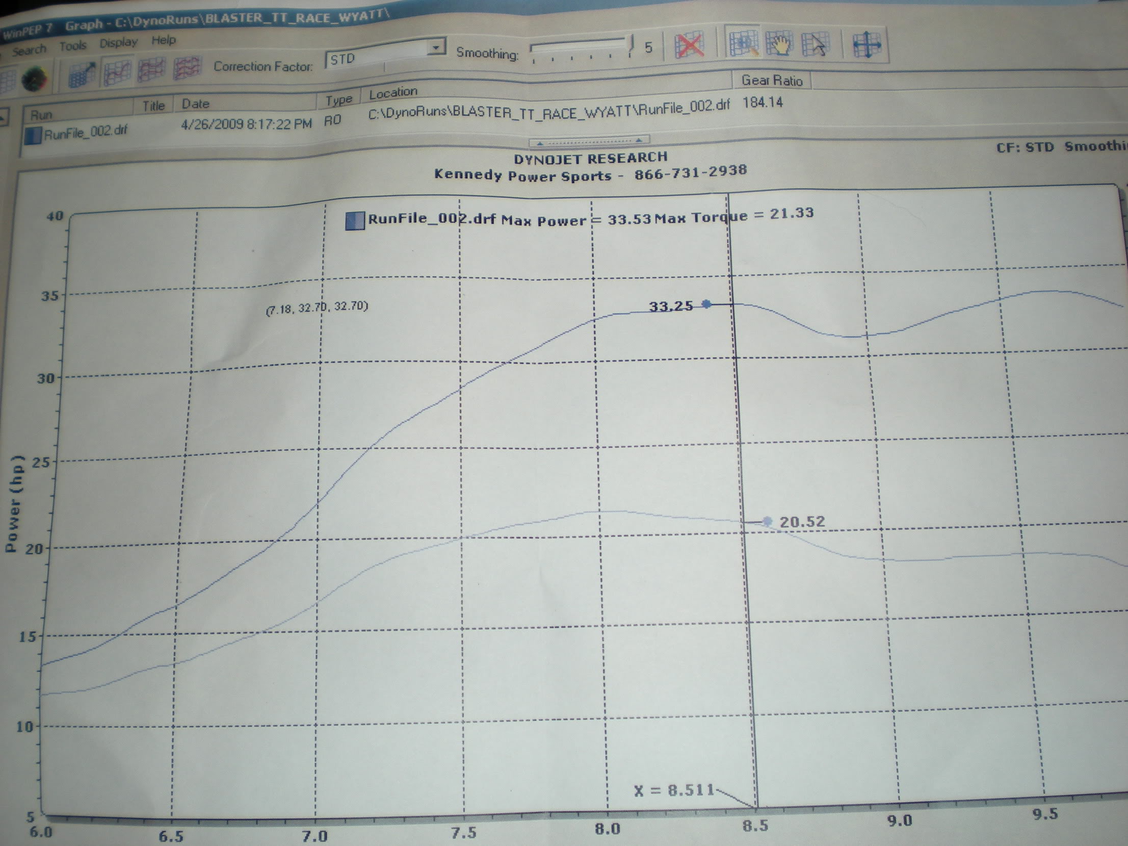

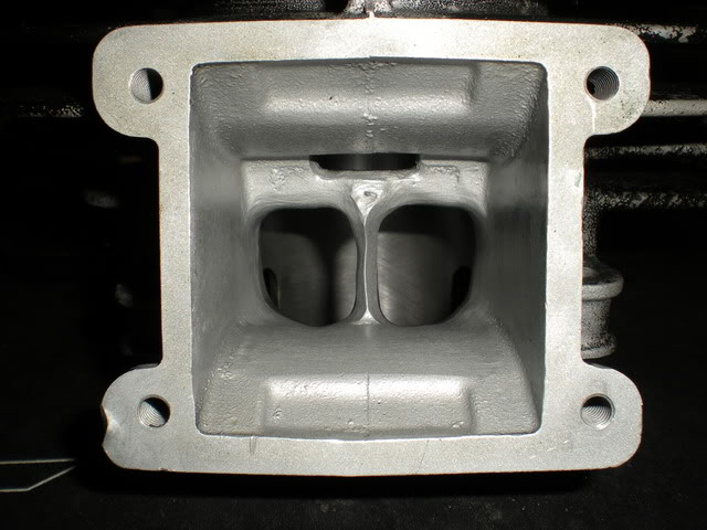

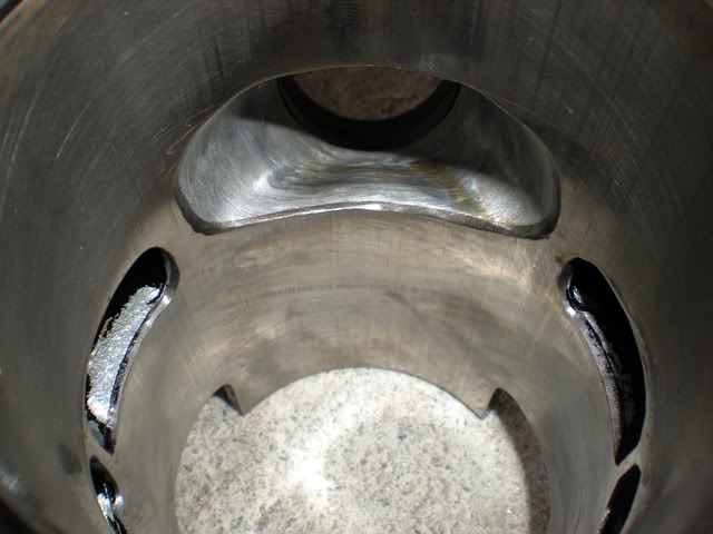

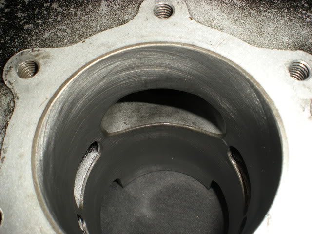

Well after my previous sending it to kennedy and somewhat disappointed... He called me to say that he WANTED to redo the setup, kinda of reluctant, I agreed to do it. Price charged?? $16.38 which is how much it cost me to ship it just to him.... What Did I receive?? JUST WOW I mean its hard to describe, HE even threw it on his dyno with almost my exact setup! ( difference was im putting a 38mm carb he used a 35) I am very impressed, He did such a good job explaining what he did, he was very helpful over the phone. He even honed it out too for free before sending it back to m. Lets let these pictures speak for themselves.. aay? Im going to Post the BEFORE pic followed by the AFTER pic
Starting with the exhaust port

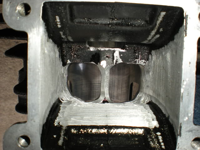

Next up we have the Intake windows
Now the Intake!
BUT WAIT theres MORE!!!!
Exhaust port INSIDE

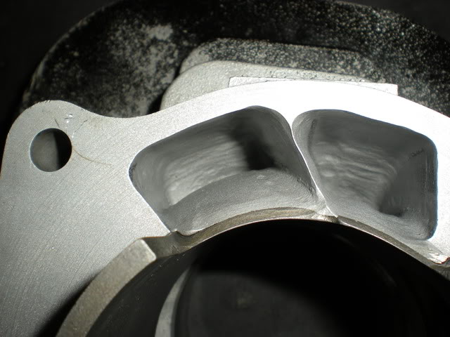

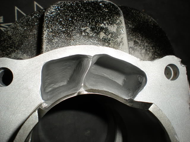

Transfer Ports! 2 old
2 New!

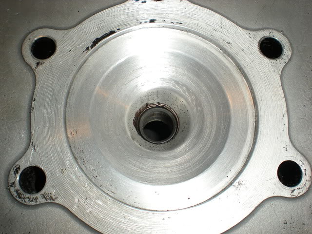

And last but NOT least.. The Cyl. Head
And finally... the Dyno Chart! It looks the way it is... because it is a PICTURE of my dyno chart... for somereason.. I cannot scan things onto this computer... so there she is!
She runs beautifully :-D finally able to say this haha its been a LOOONG summer...
Previous intake/exhaust port looked horrible.
Awesome job taking care of the motor and customer, all that matters when all said and done!
Enjoy you new setup and post some vids! :)
yea the first work looked like sh*t.but now its looks good.but he should of prolly paid the shipping both way but thats no big deal
agreed...i dunno how a builder could send something back looking like that (the 1st time). Id be asshamed to send work out like that. BUTTT he did fix it for no cost and threw in a hone,so atleast he did make good on his product so thats always good.
