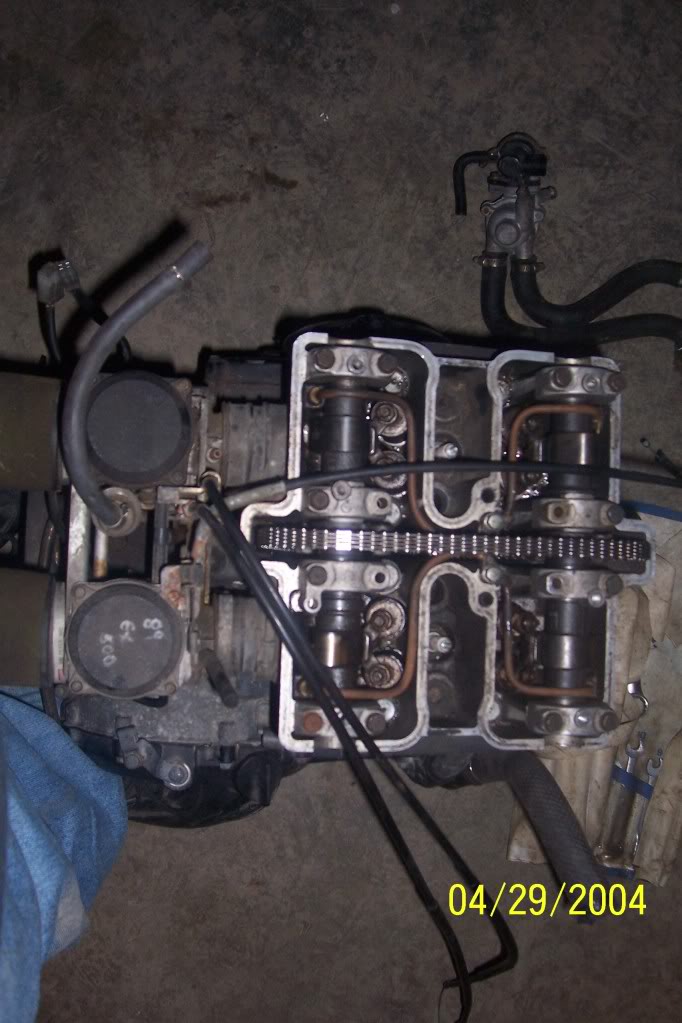

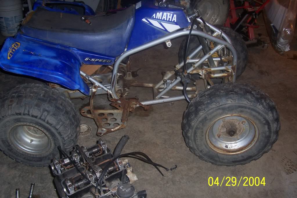

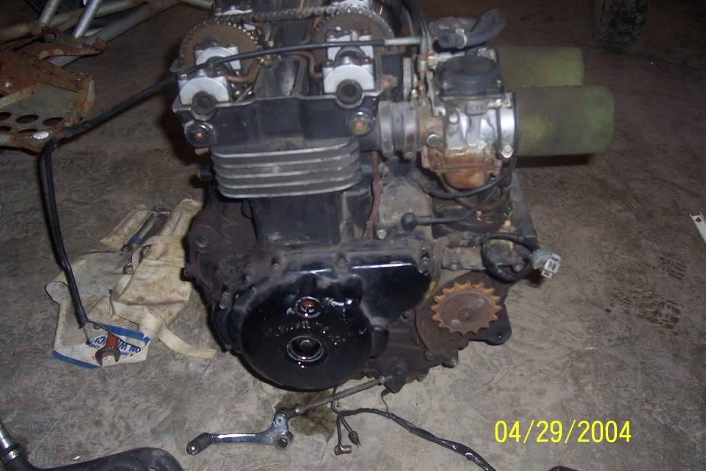

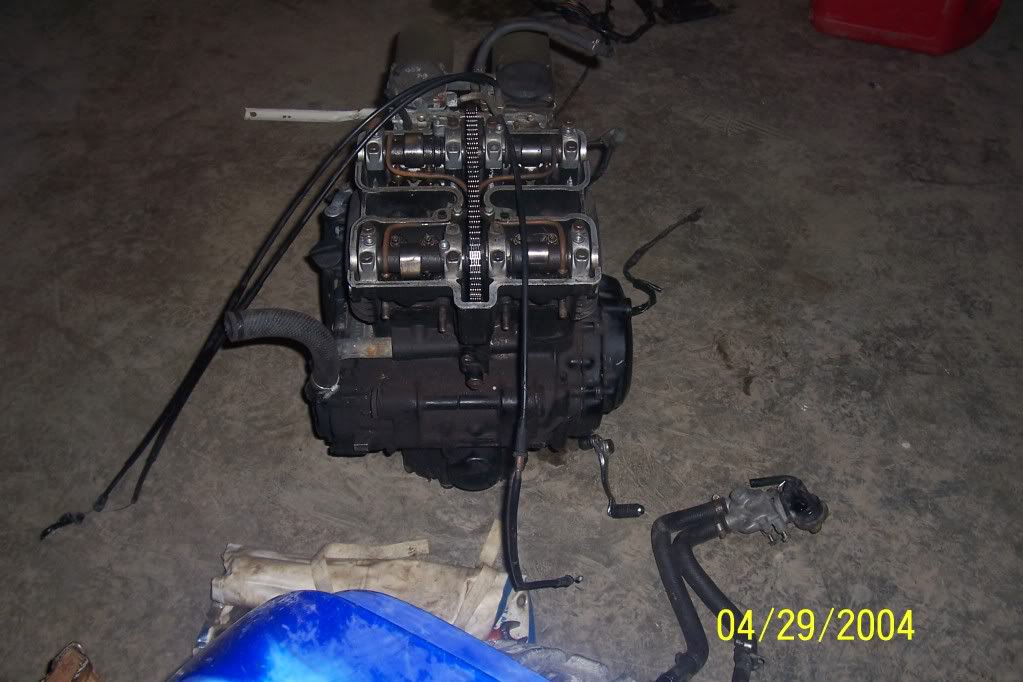

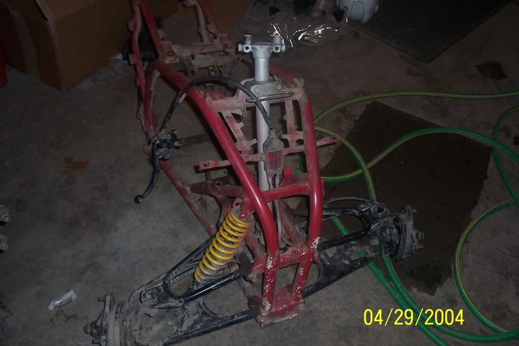

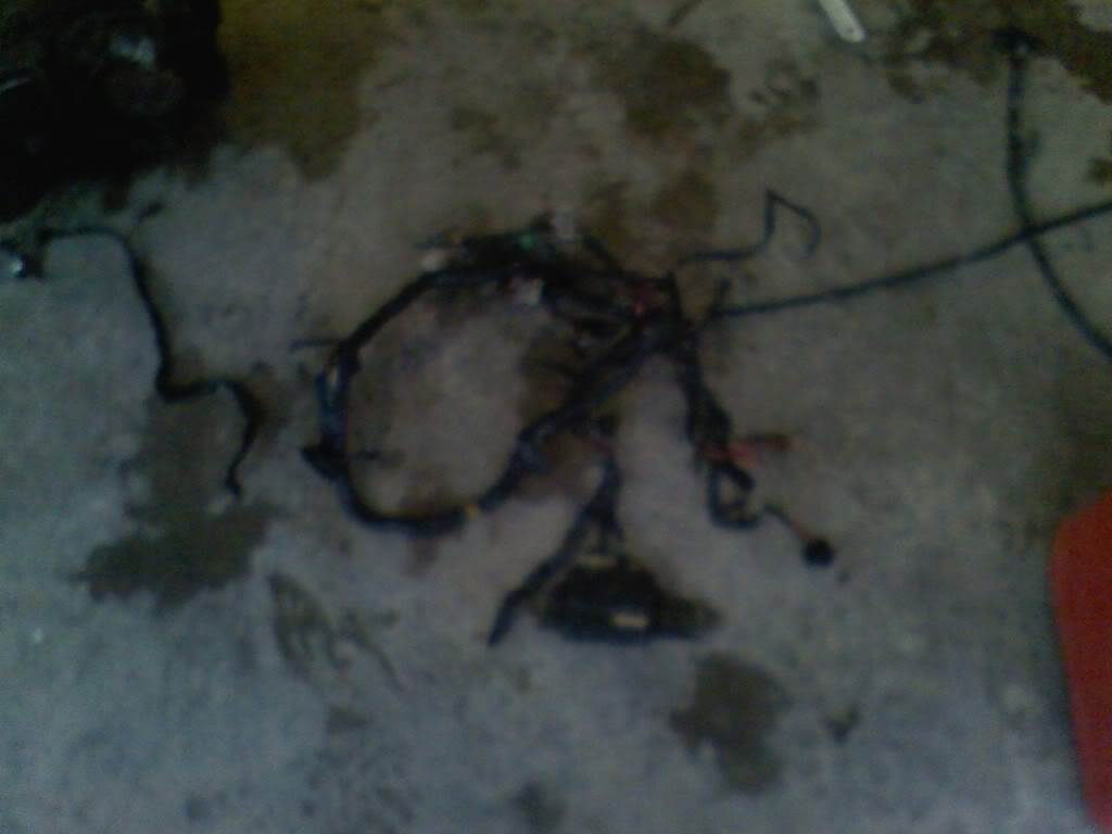

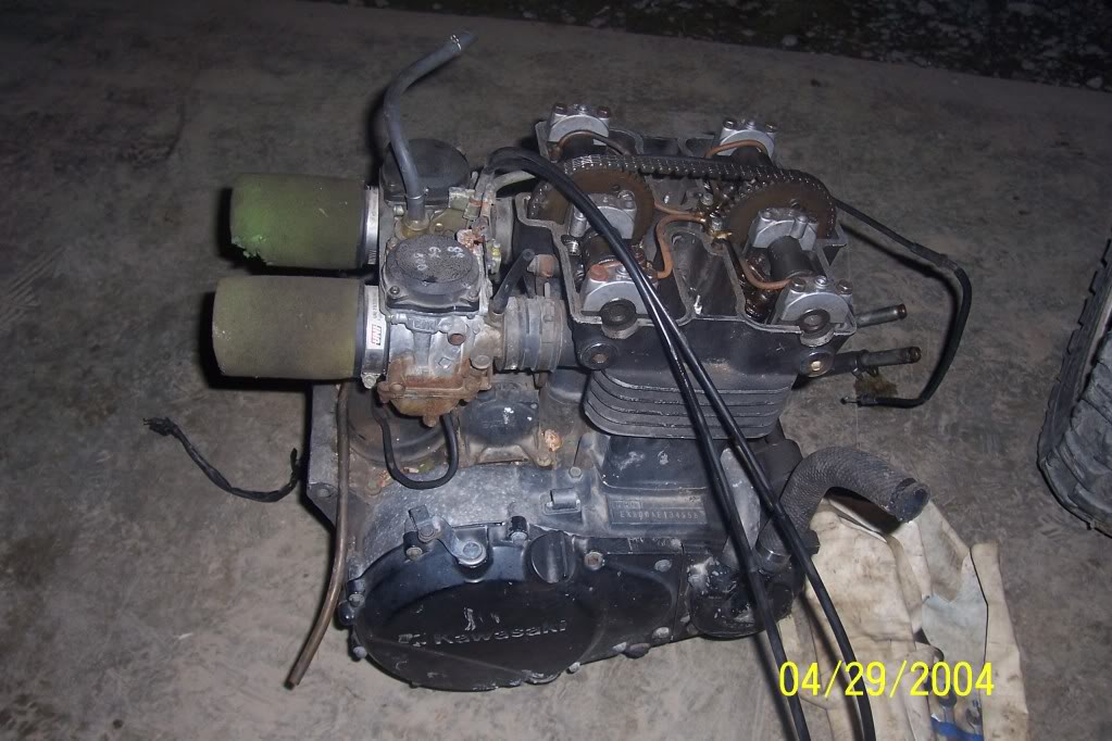

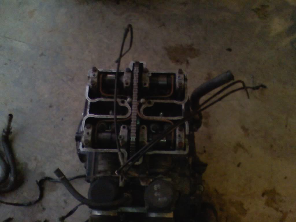

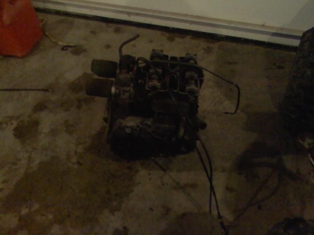

i am making a hybrid blaster with a 91 ninja 500 motor in memory of my good friend that died a cupel days ago. the motor it self needs wiring and a valve cover. also a custom pipe will have to be made because i dont want the pipe running down along the bottom of the quad. any suggestions/hints/tips will be greatly appreciated. trying to go pick up the motor and everything with it today(5/1/11).

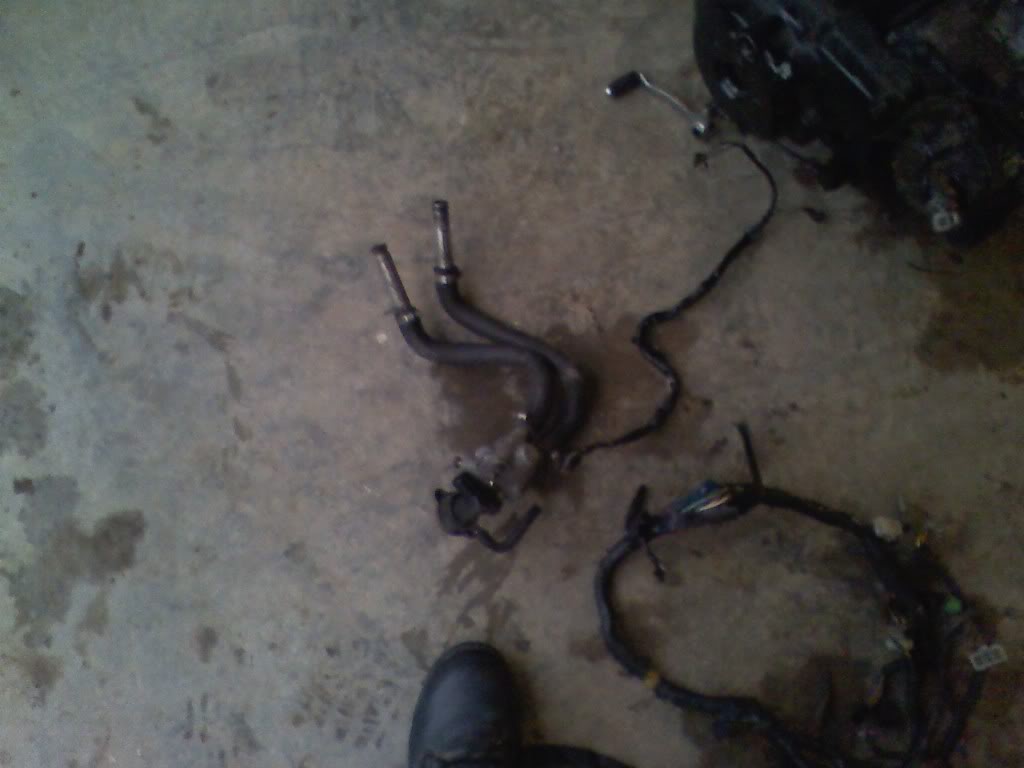

what is this????///??
Nice.
That's the coolant cap/overflow and thermostat housing. The temp sensor is in there too. The cap has to be the highest point in the coolant system so it can bleed off air. Most of the time they build it right into the top of the radiator but i'm guessing the radiator was kept low and under the plastics on the bike.

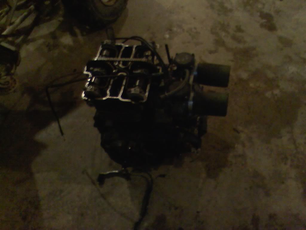

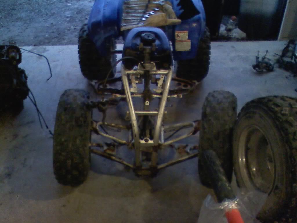

Lol I will not be too crazy. Decided for it to be a low Riding drag quad. It's going to be bad ass. I'm not giving out too many details yet so you all will have to stay tuned to find out. 79xs I will have better pics for you as soon as I can get on my computer. I'm on my iPod now

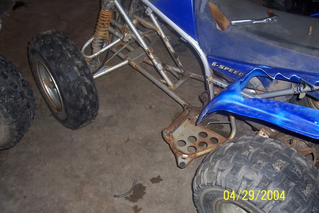

no it looks clean, im just sayin ur going to have to reinforce the frame for the weight of the motor, ur just going to have ur hands full with the fabbing
