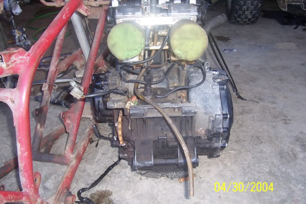

i just dont want u to get halfway through it or somewhat through it and be overwhelmed by it and give up, u are going to need custom parts for this too and its going to be expensive also. was it a running engine when u got it?
was off a werecked bike. only 1,ooo miles on it. was not running for a while. a guy came to buy it and got it running but only took the pipe and the valve covers

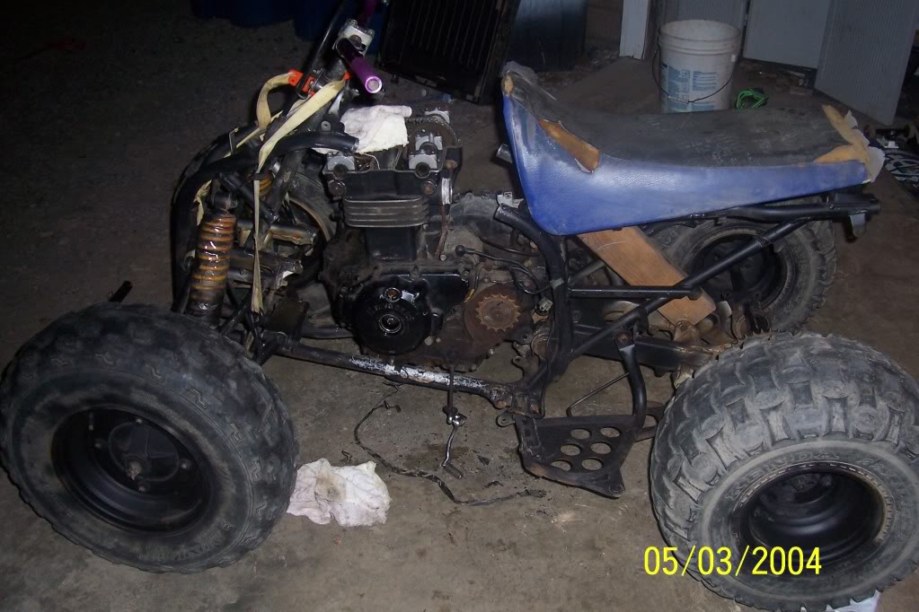

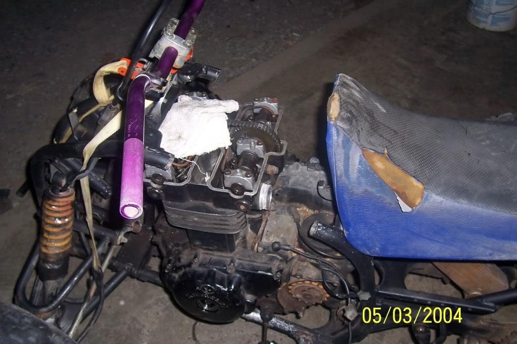

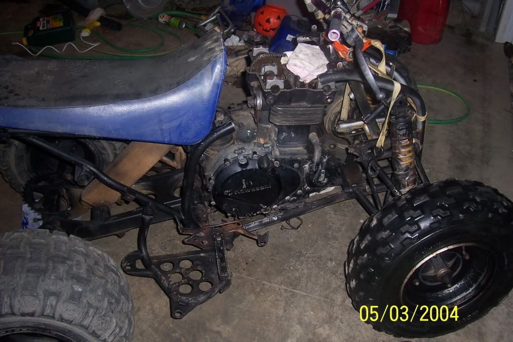

Slick... can you get a shot from the left side, but take the picture at the same level as the quad/motor? gotta see how high that sprocket is. Also, try to find a large towel to cover the whole top of that motor. Things will tend to sneak in there otherwise.
That rear sprocket is running really high compared to the swingarm.
You probably need to get the front two tubes (the ones that run from the shock mounts through the upper control arm mounting bar and down to the lower frame rail straightened out and then cut the lower two tubes out and make a "drop down" section for that frame to get the chain aligned better.
