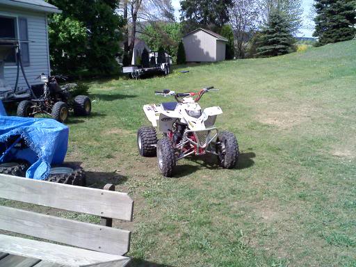

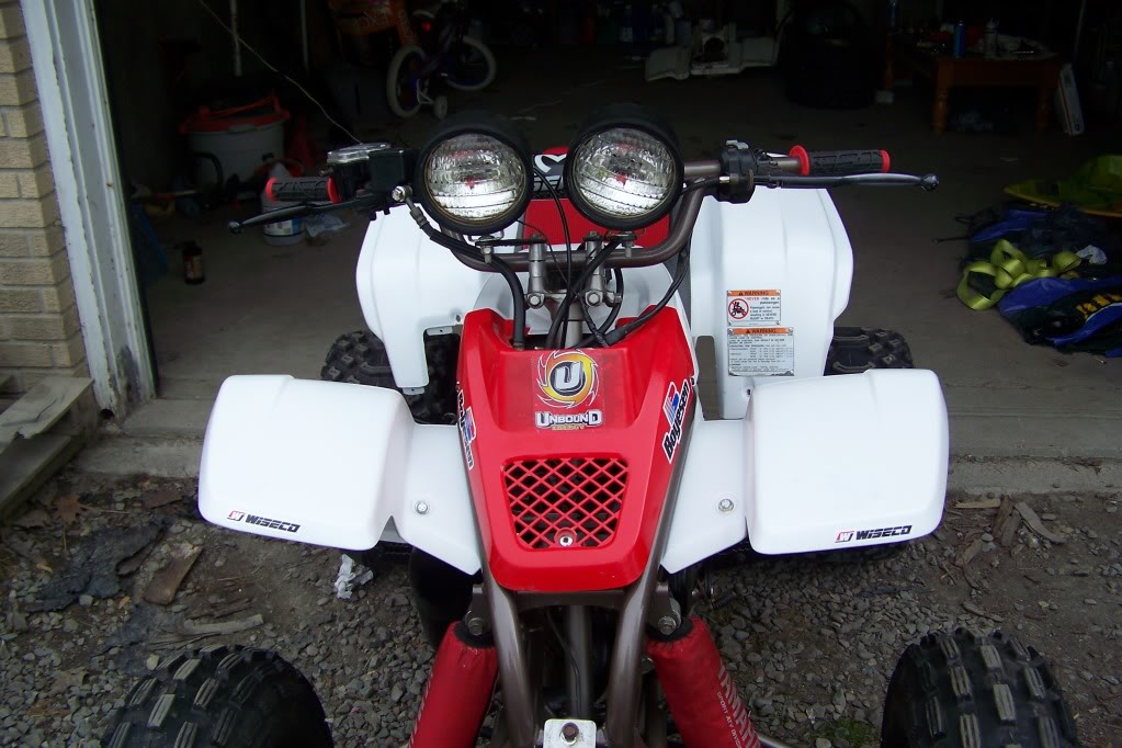

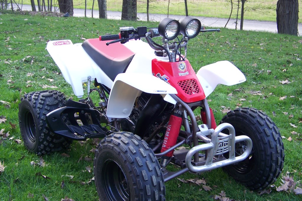

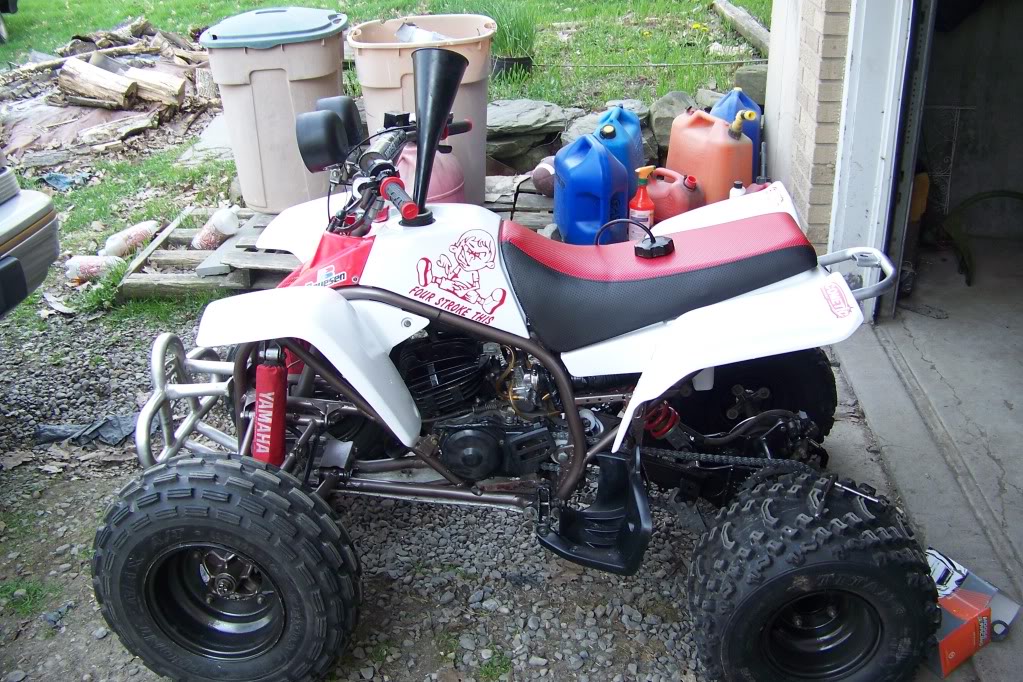

A Arms: stock
Swingarm: +2.5 mike jones racing custom stock
Steering Stem: stock
Stabilizer: n/a
Axle: stock w/+5 durablues
Carrier: stock
Locknut:stock
Hubs F|R: rappy 350 up front stock in the rear
Bars: the ones everybody likes and keep asking me about lol
Throttle/Clutch Lever: MJR stock modified/ stock
Grips: tag
Nerfs: n/a yfz450 heel guards
Bumper: dg
Grab Bar: dg
Front Shocks: stock
Rear Shock: 400ex
Brake Lines:stock
Rotors F|R: rappy 350 in the front and a stock in the rear
Rims F|R: nicely painted stock
Tires F|R: 21" kenda fronts and 20" titan fasttrekkers in the rear
Body:
Frame: 1988 modified to accept all new gen parts by mike@ MJR
Plastic: stock freshly repainted with krylon fusion
Graphics|Seat Cover: 4 stroke this graphic kit (lol) custom made seat cover
Number Backgrounds: n/a
Handguards: n/a
Bar Pad: moose
Fuel Tank: 2.2 gal stock
Engine|Drive System:
Cylinder|Head: FLOTEK +3 agressive trail port with blasterfreek polish, and milled head
Bore & Stroke: 67.75/ 60mm
Displacement: 218cc's
Cam: the good one
Carburetor: polished 34mm pj
Air Filter|Box: moose foam filter/no lid with custom made 34mm intake
Pipe|Silencer: power pros header/ powercore silencer
Clutch|Plates: barnett dirt digger
Gearing F|R:14/40
CDI|Killswitch: stock
Cooling: air

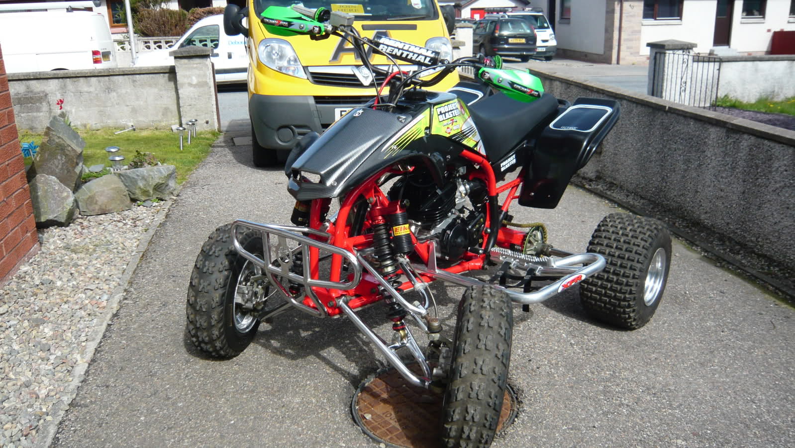

Other: cases have been port matched to the top end, shift star modded, EVERY bearing, bushing and seal is new. complete blasterfreek30 case saver and chain roller set. too much custom welding work to mention check out my build thread for lots more pics.

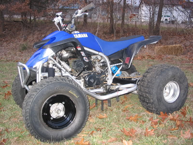

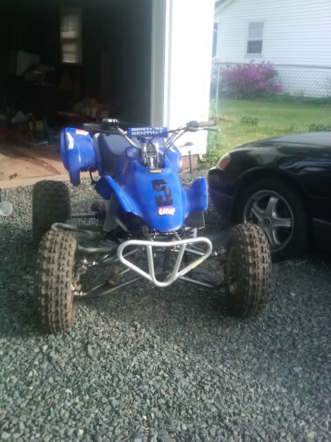

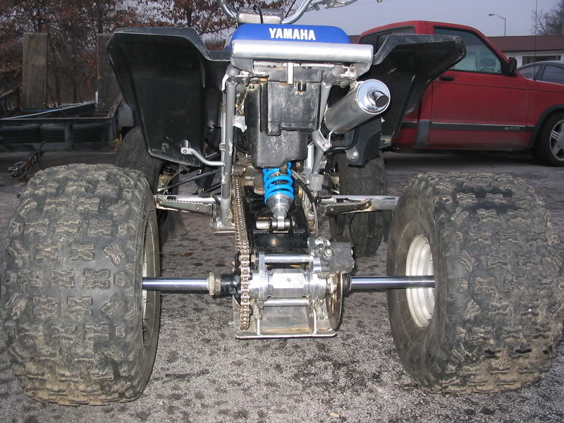

1. A Arms:stocl
2. Swingarm:R&D +4 custum swingarm
3. Steering Stem:stock
4. Stabilizer:na
5. Axle:banshee
6. Carrier:stock
7. Locknut:aftermarket locking axle nut
8. Hubs F|R:stock
9. Bars:tag x5
10. Throttle/Clutch Lever:stock
11. Grips:scott
12. Nerfs:graydon proline
13. BumperG
14. Grab Bar:PRM
15. Front Shocks:banshee
16. Rear Shock:400ex
17. Brake Lines:stock
18. Rotors F|R:stock
19. Rims F|R:douglas
20. Tires F|R:maxxis razrs
Body:
1. Frame:stock
2. Plastic:maier race front stock rears
3. Graphics|Seat Cover:
4. Number Backgrounds:K&K
5. Handguards: na
6. Bar Pad:tag
7. Fuel Tank:stock
1. Cylinder|Head:kennedy power ported cylinder and redesigned head
2. Bore & Stroke:30 over bore stock stroke
3. Displacement:
4. Cam:a big one lol
5. Carburetor:34mm pj
6. Air Filter|Box:uni pod
7. Pipe|Silencer:toomey.shearer
8. Clutch|Plates:kennedy HD clutch kit
9. Gearing F|R:14/40
10. CDI|Killswitch:tether kill
11. Cooling:
12. Other:gsxr hydro rear, lots of custom work just check out the pics

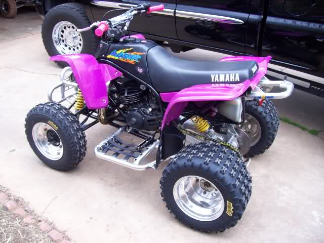

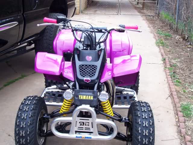

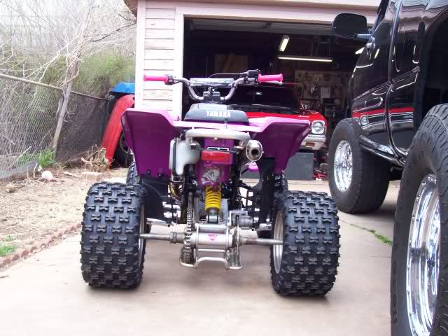

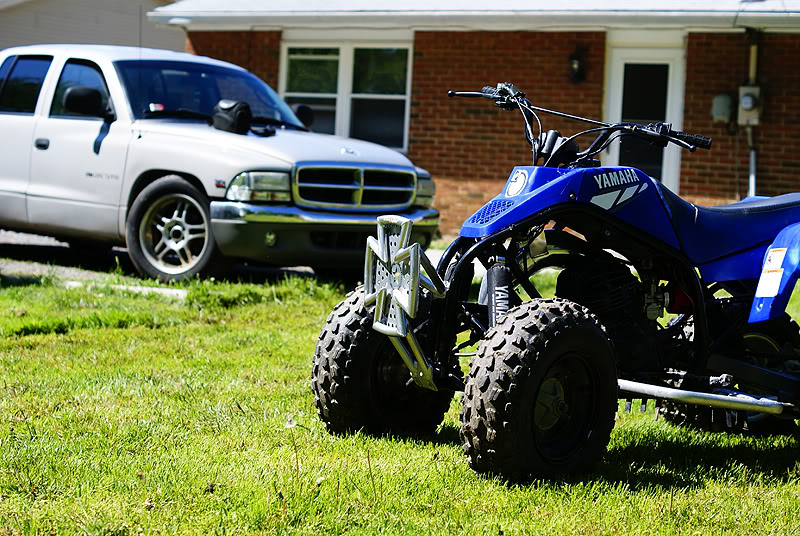

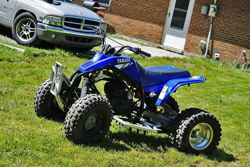

A Arms: stock painted black
Swingarm: stock
Stabilizer: N/A
Axle: stock
Carrier: stock
Locknut:stock
Hubs F|R: stock
Bars: stock painted silver
Throttle/Clutch Lever: stock
Grips: PINK
Nerfs: DG
Bumper: DG
Grab Bar: DG
Front Shocks: stock
Rear Shock: stock
Brake Lines: stock
Rotors F|R: stock
Rims F|R: 10" Douglas Black Label
Tires F|R: Holeshot 20x6x10 & 19x10x10
Body: stock purple
Frame: painted black
Plastic: Stock purple plastics from 98
Graphics|Seat Cover: N/A
Number Backgrounds:
Handguards: N/A
Bar Pad: moose
Fuel Tank: stock
Cylinder|Head: stock
Bore & Stroke: stock
Displacement: stock
Cam: stock
Carburetor: stock
Air Filter|Box: UNI/stock
Pipe|Silencer: FMF Fatty/Power Core 2
Clutch|Plates: stock
Gearing F|R: stock
CDI|Killswitch: N/A
Cooling: Stock
Other: led headlights

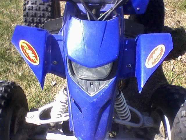

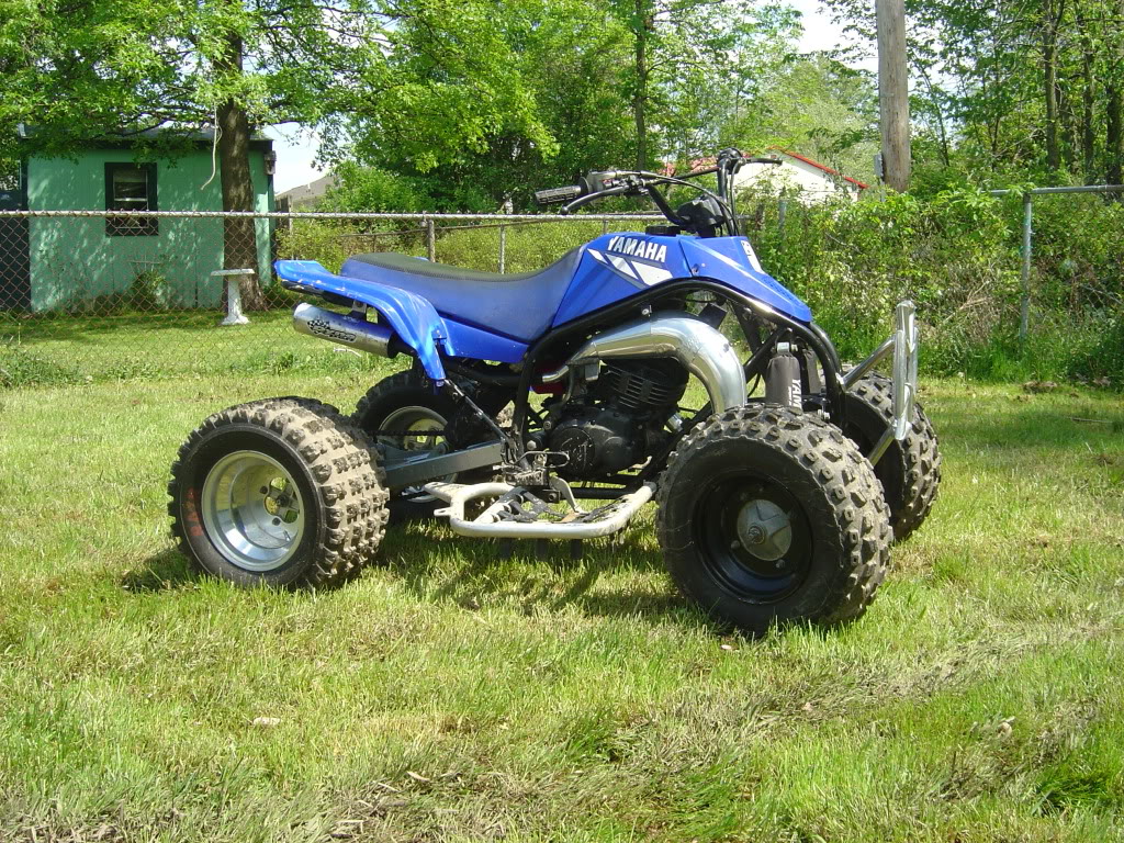

1. A Arms: Stock
2. Swingarm: stock
3. Steering Stem: Stock
4. Stabilizer: N/A
5. Axle: stock
6. Carrier: stock
7. Locknut: Stock
8. Hubs F|R: stock/painted blue
9. Bars: Protaper
10. Throttle/Clutch Lever: stock/ stock
11. Grips: MSR
12. Nerfs: custom
13. Bumper: stock
14. Grab Bar: Custom
15. Front Shocks: stock
16. Rear Shock: 86 honda atc 250r
17. Brake Lines: stock
18. Rotors F|R: stock
19. Rims F|R: stock/stock
20. Tires F|R: stock/razr mx
Body:
1. Frame: Stock
2. Plastic: cut front fenders
3. Graphics|Seat Cover: N/A
4. Number Backgrounds: N/A
5. Handguards: N/A
6. Bar Pad: Protaper
7. Fuel Tank: Stock
1. Cylinder|Head: Stock
2. Bore & Stroke: Stock
3. Displacement: Stock
4. Cam: N/A
5. Carburetor: Stock
6. Air Filter|Box: Stock with no lid
7. Pipe|Silencer: fmf fatty/fmf powercore 2
8. Clutch|Plates: Stock
9. Gearing F|R: 14/40
10. CDI|Killswitch: stock
11. Cooling: air
12. Other: Polished throttle cover, 5” front/back wheel spacers, oil injection removed, custom heel guards, cutom air scoops, and a re-mounted tail light.

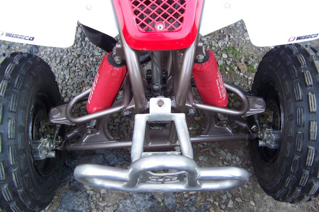

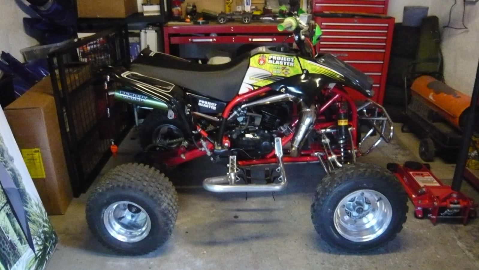

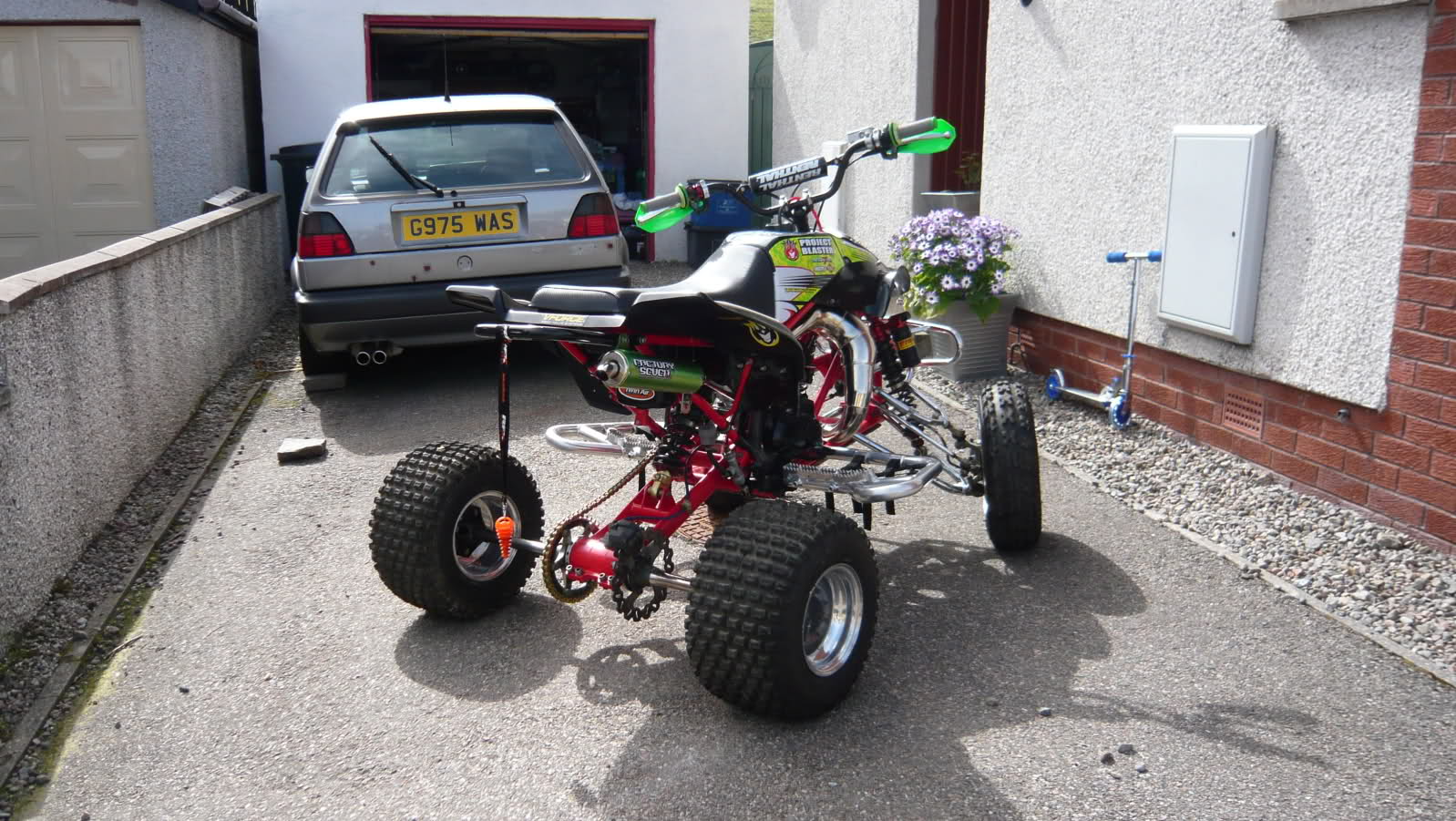

1.A Arms: Stock with PRM skid plates
2.Swingarm: 4 1/2 JTM products extension & Custom Skid plate
3.Steering stem: Stock with Tusk handlebar riser kit
4.Stabilizer: N/A
5.Axle: Stock
6.Carrier: Stock
7.Locknut: Stock
8.Hubs F|R: Banshee | Stock
9.Bars: Stock
10.Throttle/Clutch lever: Stock / Banshee
11.Grips: ?
12.Nerfs: N/A
13.Bumper: RPM products Baja Bumper
14.Grab Bar: RPM products 6-pack rack
15.Front Shocks: Works SRS Dual Rate with Rez
16.Rear Shock: Works Ultracross with Rez
17.Brake Lines: Rear Breaided stainless line | front Banshee
18.Rotors F|R: Banshee
19.Rims F|R: Douglas .190
20.Tires F|R: Kenda Front Max 22x8x10 | Maxxis All Trak 22x11x10
Body:
1.Frame: Stock with custom skid plate
2.Plastic: Maier custom banshee rear fender
Maier Blaster raceing front fender
Maier 450 vented hood
Maier 400ex front fender extensions
3.Graphics|Seat cover: N/A | Black
4.Number Backgrounds: N/A
5.Handguards: N/A
6.Bar Pad: Renthall
7.Fuel Tank: Stock

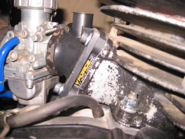

1.Cylinder|Head: CT Sonic 240
2.Bore & Stroke: CT 240 / Stock
3.Displacement: ct 240
4.Cam: N/A
5.Carburetor: KEIHIN 36 PWK & 250r V-froce 3 reed assembly
6.Air Filter|Box: K&N | Custom Alum & Outerwears airbox cover
7.Pipe|Silencer: CT/CT
8.Clutch|Plates: Barnet
9.Gearing F|R: 14/40
10.CDI|Killswitch: Stock
11.Cooling: AIR
12.Outher: Front Wheel spacers
Custom Alum Rear wheel spacers
Custom Alum Air Box
Custom Frame Guards
Vitos oil injection block off
Modquad rear Alum brake reservoir & cap
Tusk Polished Folding shift lever
T.M. Designworks no leak Alloy pipe collar

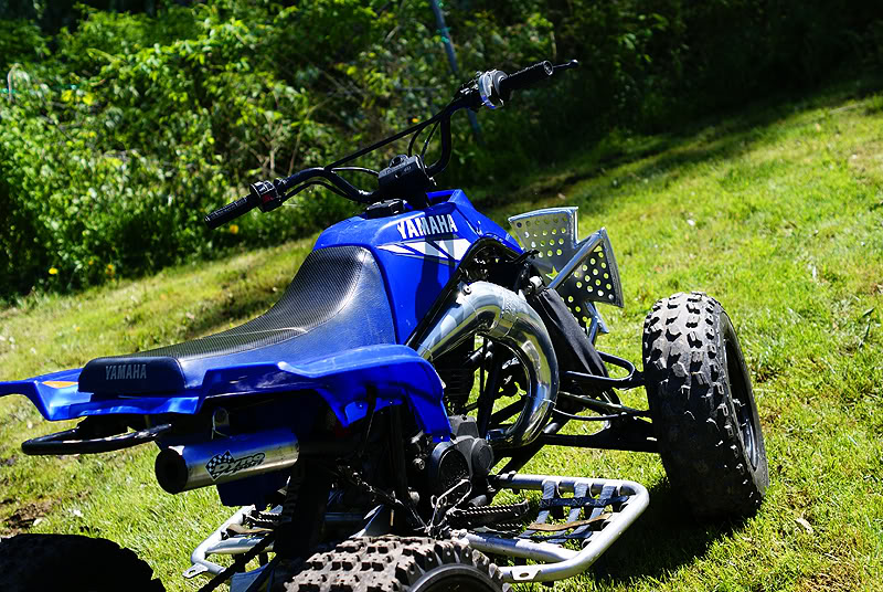

1. A Arms: stock
2. Swingarm:stock
4. Stabilizer:n/a
5. Axle:durablue eliminator
6. Carrier:stock
7. Locknut:anti fade
8. Hubs F|R:stock
9. Bars:renthol mids with risers
11. Grips:mx
12. Nerfs:n/a
13. Bumper:custom iron cross
14. Grab Bar:stock
15. Front Shocks:stock
16. Rear Shock:stock
17. Brake Lines:stock fronts, shorty rear
19. Rims F|R:stock
20. Tires F|R:holeshot sx fronts, turf tammer rears
Body:
1. Frame:painted black
2. Plastic:stock race cut
3. Graphics|Seat Cover:n/a and 99 seat
4. Number Backgrounds:n/a
5. Handguards: n/a
6. Bar Pad:power wheels yamaha pad
7. Fuel Tank:stock
1. Cylinder|Head:stock
2. Bore & Stroke:stock
3. Displacement:197?
4. Cam: lol whats this?
5. Carburetor:stock with tors delete
6. Air Filter|Box:k&n no lid
7. Pipe|Silencer:LRD rfx, fmf turbinecore2
8. Clutch|Plates:barnett
9. Gearing F|R:13/40
10. CDI|Killswitch:stock
11. Cooling:air
12. Other:front spacers, front wheels flipped, injection removed,chrome clutch lever, without parking brake

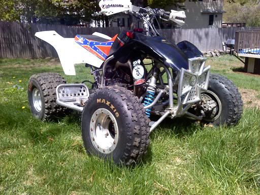

A Arms: +2+1 strong arm & +1.5 spacers
Swingarm: +2 chrome lonestar racing
Steering Stem: Warrior
Stabilizer: PEP
Axle: banshee
Carrier: Dual row round house
Locknut: stock
Hubs F|R: 03 blaster / stock
Bars: Pro taper school boy low
Throttle/Clutch Lever: 03 blaster
Grips: Pro taper
Nerfs: Raptor 660 A/C
Bumper: Blingstar iron cross
Grab Bar: SVC
Front Shocks: banshee works
Rear Shock: 400ex
Brake Lines: Speedlines
Rotors F|R: 03 blaster
Rims F|R: ITP bead-lock off set rims / DWT red label
Tires F|R: 22x7x10 RAZR 2's / 20X11X8 razrz
Body:
Frame: 2001
Plastic: Race front hood, 03 tank cover, banshee rears
Graphics|Seat Cover: Confederate flag
Handguards: Tusk D-flex
Bar Pad: Pro taper w/ compass&watch
Fuel Tank: stock with shee petcock
Cylinder|Head: Wildcard aggressive trail port and head mod
Displacement: 195cc
Reeds: VF3
Carburetor: 34mm pj
Air Filter|Box: CFM airbox with uni clamp on filter
Pipe|Silencer: Dyno-port high volume
Clutch|Plates: Tusk
Gearing F|R: 14t|stock
CDI|Killswitch: Pro amour tether kill switch
Cooling: Djack air scoops
Other: GSXR rear caliper set up by AWK08 w/ shee master and pedal by me, Tusk gas cap, go pro camera mounts on handle bars and bumper

A Arms: Stock
Swingarm: Stock
Stabilizer: N/A
Axle: Stock
Carrier: Stock
Locknut: Stock
Hubs F|R: Stock
Bars: MSR
Throttle/Clutch Lever: Stock
Grips: Scott Waffled
Nerfs: N/A
Bumper: WC Racing Front bumper
Grab Bar: Stock
Front Shocks: Stock
Rear Shock: Stock
Brake Lines: Stock
Rotors F|R: Stock
Rims F|R: Douglas Black Label|Stock
Tires F|R: Stock(for now)|Artrax "18
Body:
Frame: Stock
Plastic: Stock
Graphics|Seat Cover: Stock|some here and there
Handguards: N/A
Bar Pad: MSR
Fuel Tank: Stock
Displacement: Stock
Cam: Stock
Carburetor: Stock
Air Filter|Box: UNI
Pipe|Silencer: Toomey B1|Toomey B1
Clutch|Plates: Kevlar
Gearing F|R: Stock
Cooling: Project Blaster Fins
Other: N/A

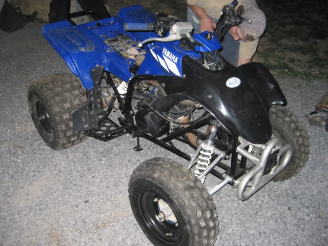

A Arms:
Swingarm: +4 swingarms shop swinger
Stabilizer: n/a
Axle: stock
Carrier: stock
Locknut: stock
Hubs F|R: f: stock r: Banshee hubs
Bars: stock (for now)
Throttle/Clutch Lever: Twist grip throttle
Grips: scott grips
Nerfs: Dg nerfs
Grab Bar: stock (black)
Front Shocks: stock (covered)
Rear Shock: Stock (covered)
Brake Lines: stock
Rotors F|R: F: stock drums R: stock disc
Rims F|R: F stock (painted Black) R ITP .190
Tires F|R: F Stock R maxxis Razrs
Body:
Frame: Powdercoated black
Plastic: stock no fronts
Graphics|Seat Cover: n/a
Handguards: n/a
Bar Pad: n/a
Fuel Tank: n/a
Cylinder|Head: Milled .030"
Bore & Stroke: b: 67mm s: 60mm
Displacement: 211 cc
Cam: hahahaha
Carburetor: oko 30mm carb
Air Filter|Box: uni filter bolted directly to the carb
Pipe|Silencer: full Dynoport exhaust
Clutch|Plates: barnett clutch
Gearing F|R: F: 14 R: 38
Cooling: air flow lol
Other: spent all my money on engine work, now have no money for cosmetics lol!

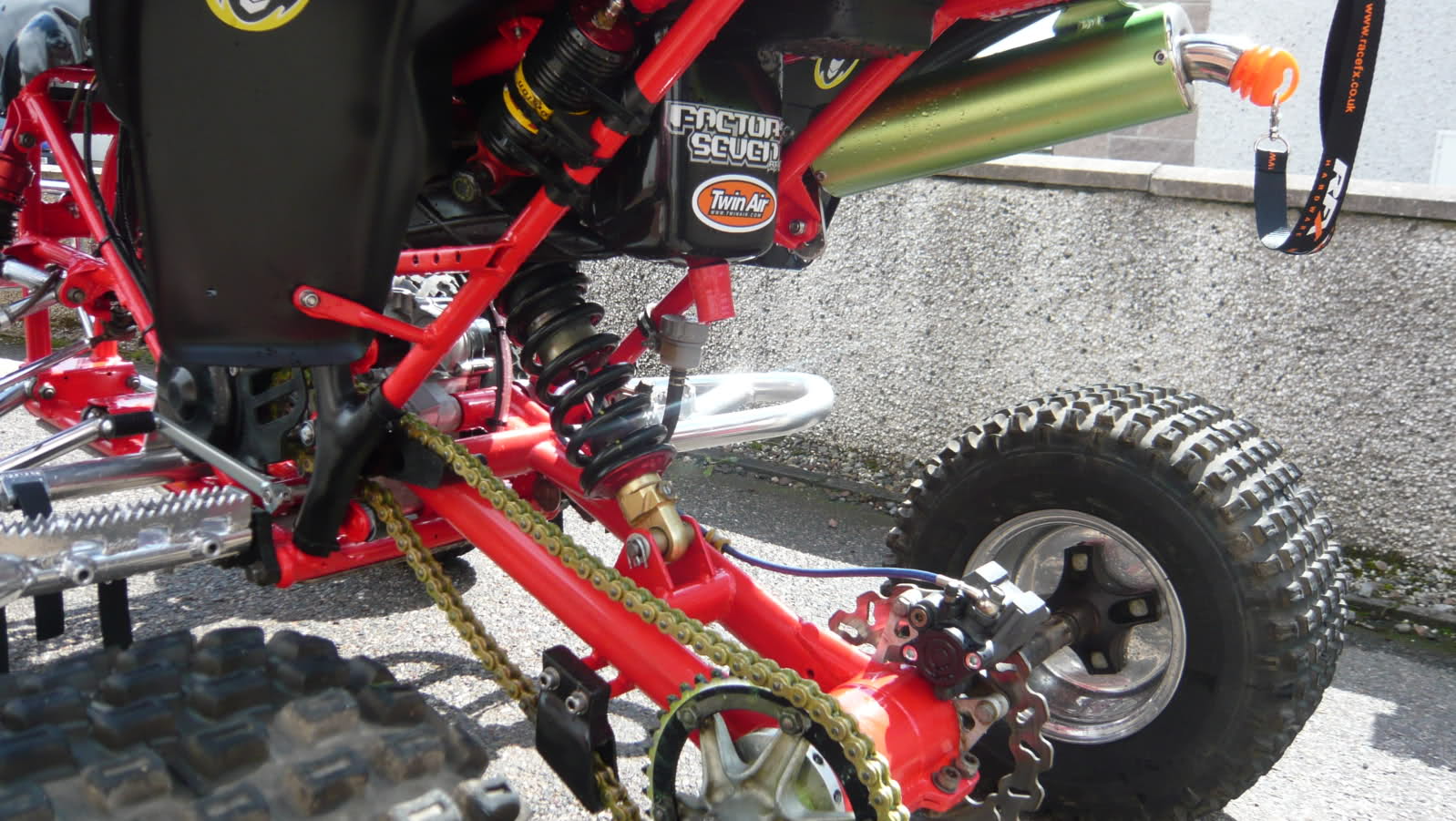

A Arms: laegers +2+1
Swingarm: fireball racing full roundhouse +2, UPP slider and guide and rollers.
Steering Stem: custom +1.5
Stabilizer: none
Axle: team racing +4 adjustable
Carrier: full roundhouse
Locknut: drilled and tapped locknuts
Hubs F|R: front stock hubs, rear alloy team racing
Bars: black renthal atv bend
Throttle/Clutch Lever: motion pro twist throttle tors delete, factory 7 "on the fly" clutch lever and perch vitos cable.
Grips: RFX grip, RFX donuts
Nerfs: XFR pro peg nerfs, QZR heel gaurd still to modify and put on.
Bumper: GYTR front bumper
Grab Bar: stock modded
Front Shocks: ELKA fully adjustable long travel with piggy back ressies
Rear Shock: ELKA fully adjustable long travel with remote ressie
Brake Lines: stainless braided lines all round, parking brake deleted with alloy blanking plug.
Rotors F|R: stock front, BRAKING wavy rear rotor
Rims F|R: DWT racing alloys, polished.
Tires F|R: ITP holeshots on front, turf tamersoin rear
Body:
Frame: fully PC in red, all un-neccasary mountings removed, rear fender mounts welded on.
Plastic: PROJECT BLASTER TAURUS V2 front end with carbon centre, maier tank cover, maier rear fenders, custom heelgaurd replacement panel.
Graphics|Seat Cover: PROJECT BLASTER TEAM special ed. phsyco green/yellow distortion. FACTORY carbon fibre tank cover decal, QUADWORKS gripper seat.
Number Backgrounds: SPASTIC designs number backgrounds
Handguards: FACTORY 7 "impact" phsyco green gaurds
Bar Pad: renthal
Fuel Tank: stock with red/black free-flo vent hose alloy swivel type.
Cylinder|Head: 3mm milled with squish band, aggresive MX porting.
Bore & Stroke:fresh 67mm bore, PROX piston, HOTRODS crank.
Displacement: stock or there abouts.
Cam: none [lol]
Carburetor: OKO 30mm PWK, V-FORCE 3 reed assembly, vitos oil block kit.
Air Filter|Box: twinair filter, outerwears lid
Pipe|Silencer: full FACTORY 7 pipe and silencer kit with phsyco green silencer
Gearing F|R: 14t front, 40tTALON radialite black rear, gold chain with ipone green lube.
CDI|Killswitch: KX style killswitch, stock cdi with RICKY STATOR adjustable 75w stator, NGK iridium plug.
Cooling: stock, PROJECT BLASTER phsyco green scoops not fitted yet.
Other: this quad is now fully rebuilt. the chassis/suspension/brakes has had every bearing and or seal replaced with fresh ones new brake fluid and brake pads, every nut and bolt possible on the whole bike has been changed for a stainless steel allen bolt stainless nyloc nuts and stainles washer throughout. if i havent replaced anything it has been cleaned and painted. the motor has been fully rebuilt, every seal and bearing changed in it including the gearbox also a new selector shaft and peg. the motor is built inside brand new crank cases, they dont even have numbers on them.
the wiring loom is chopped all un-necassary wiring removed, tors lights etc. im bound to have missed something but thats about it, i do still have to modify the airscoops to fit and modify my QZR heelgaurds to fit these nerfs.
