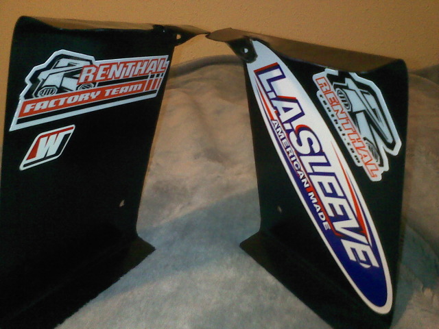

made some sweet air schrouds/scoops

just made these out of 22 gauge steel, used a grinder and alot of sanding and bending, had to paint them black so they wouldint rust, but these will be stronger then alloy ones. only costed me 10 bucks for the sheet and i made some heel guards still in progress. The measurements i used on these are, 6 inches wide, 8 inches tall, and 1 inch flaps top and bottom, you will also need 2 small brackets, i just used the steel i had left over, cut it 7 inches long, give or take a little, i like mine to stick out a bit, and 1 inch wide. i would add a pic of the bracket but i didint make brackets i used my old brackets

nice work bro, have some greens !
and you know someone is going to want the measurements
add nice close, clear pics of them mounted, and the mounting points once you get them on, and i'll rename this thread 89's diy airscoops and put it in the DIY section.
and delete all these posts, LOL

Are you going to sell your alloy ones now??
they cracked and fell apart thats why i made these
