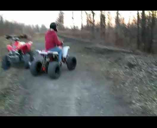

I got the blaster out today and started let-en her breath. Just a quick clip.
As my daughter (who is filming me) said "Dad for such a small 4-wheeler it sure has a big bite" all I could do was agree with her lol... Kids
sounds good! What mods are you running? Also where are you riding? Is that an ATV park or private property?
92 sleeper
Motor
Stock bore
Stock stroke
New yamaha Crank/bearings/seals
Flotek aggressive trail port cylinder
Milled/rechambered head
WSM Forged piston/rings
EBC clutches/plates
Oil injection removed and plated
Vito base/head gasket
155 PSI Comp
Air/Intake/exhaust
DMC alien comp exhaust
Cleaned up reed cage
Boyesen Pro duel pedals
Stock 26mm Mikuni open'd to 30mm
Stock pilot,banshee needle,300 main
Tors removel kit
Airbox snorkle cut/ 8x 1" holes in lid
Custom wrapped lid
UNI duel stage filter
Banshee tank valve
Suspension/frame/gearing
400EX rear shock
Stock front shocks (shee’s on the way)
+3 swinger
Stock arms
+2 axle
Banshee Hubs
14/40 gearing (vortex setup)
YFZ450R Rims
20x10x9 OHTSU rears
Dunlop fronts
gsxr 1000 rear hydro conv
vesra grooved front breaks
Praxair sermetel slurry coatings
Custom seat cover/pad
That is open public land behind my house, everyone rides,and does there testing tuning back there. Its pretty neet sitting in my backyard hearing everything from bikes to sleds ripping it up.
