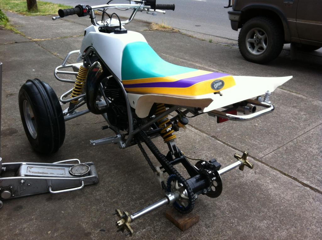

Here's a pic of the +2 in our beater Blaster. Our nice Blaster is all apart, getting a transformation.

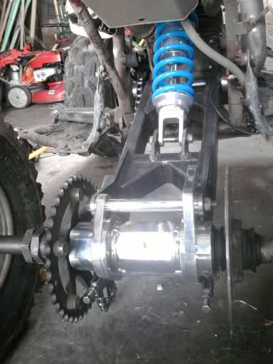

i've got a +2" and now trying +3" for my white bike

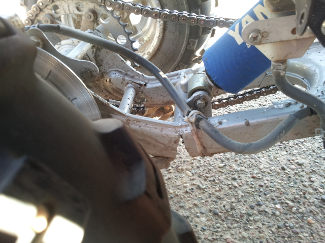

+2 back in the works shock days
+3 & elka
and a +4 on my black bike w/ yfz450 shock
(looking for a pic)
