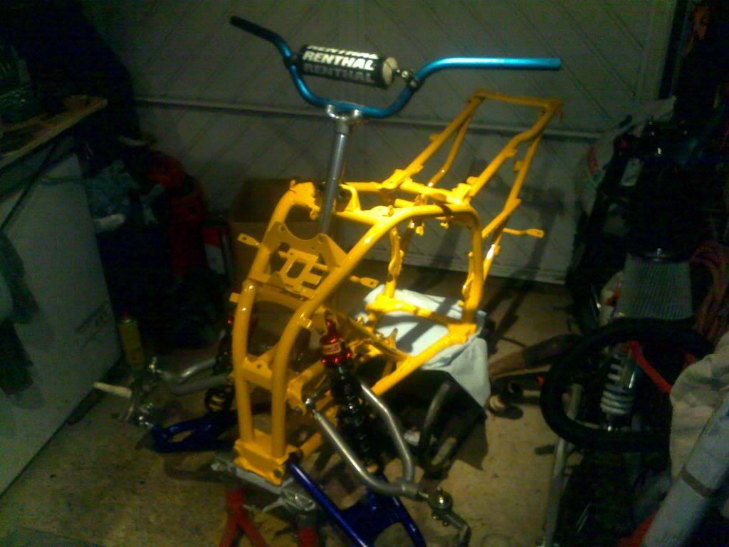

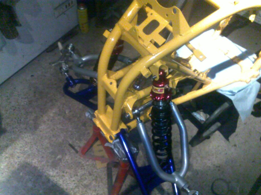

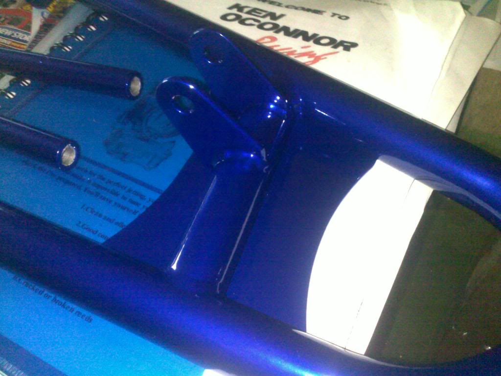

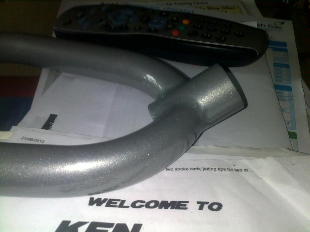

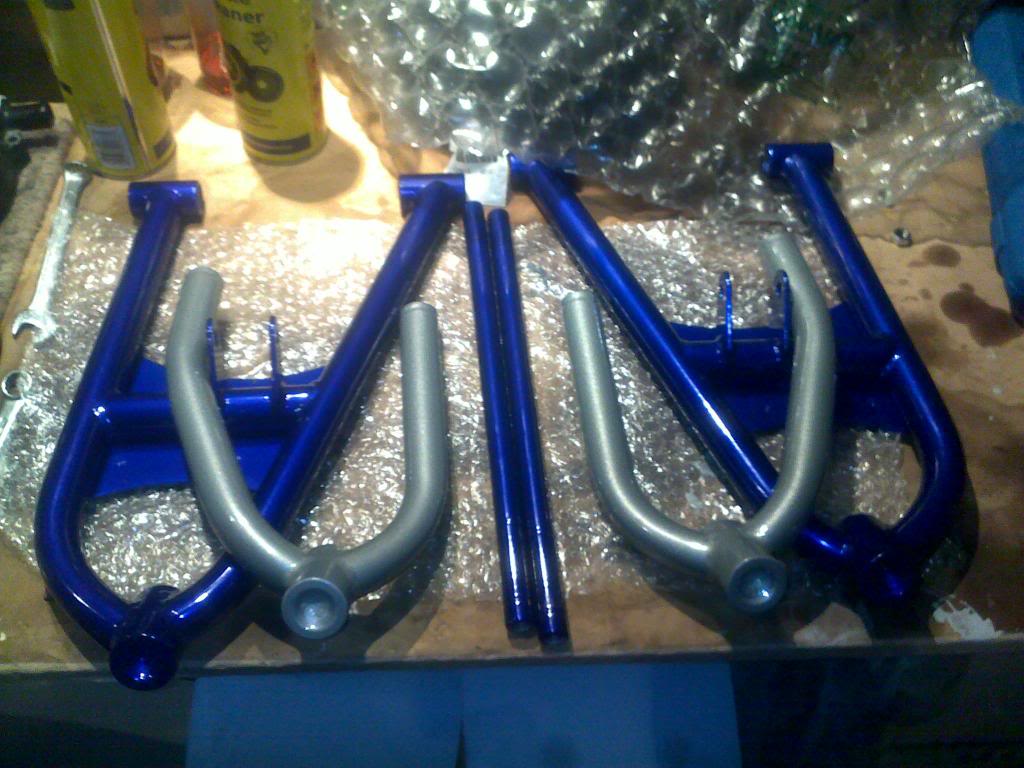

Right, I have got my A arms back from the powder coater and they look awesome
I got the top arms done in a titanium silver rather than the chrome effect i was originally considering as we have found it doesn't hold up too well to oil and dirt. :-/

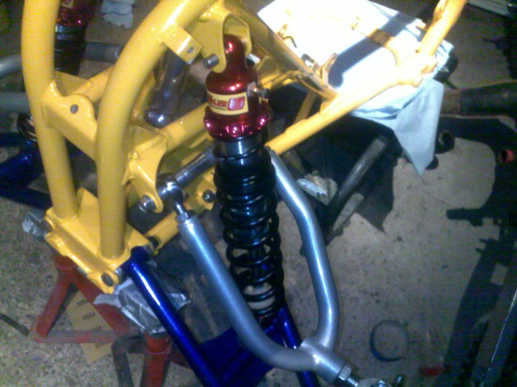

I also have dry assembled the front end to see how it all looks and fits. I:I

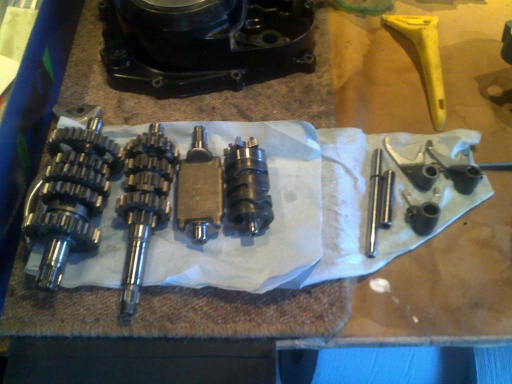

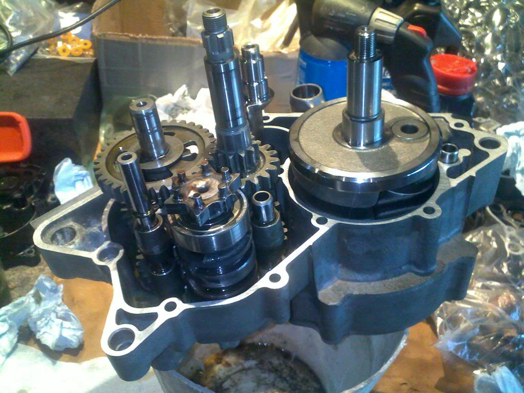

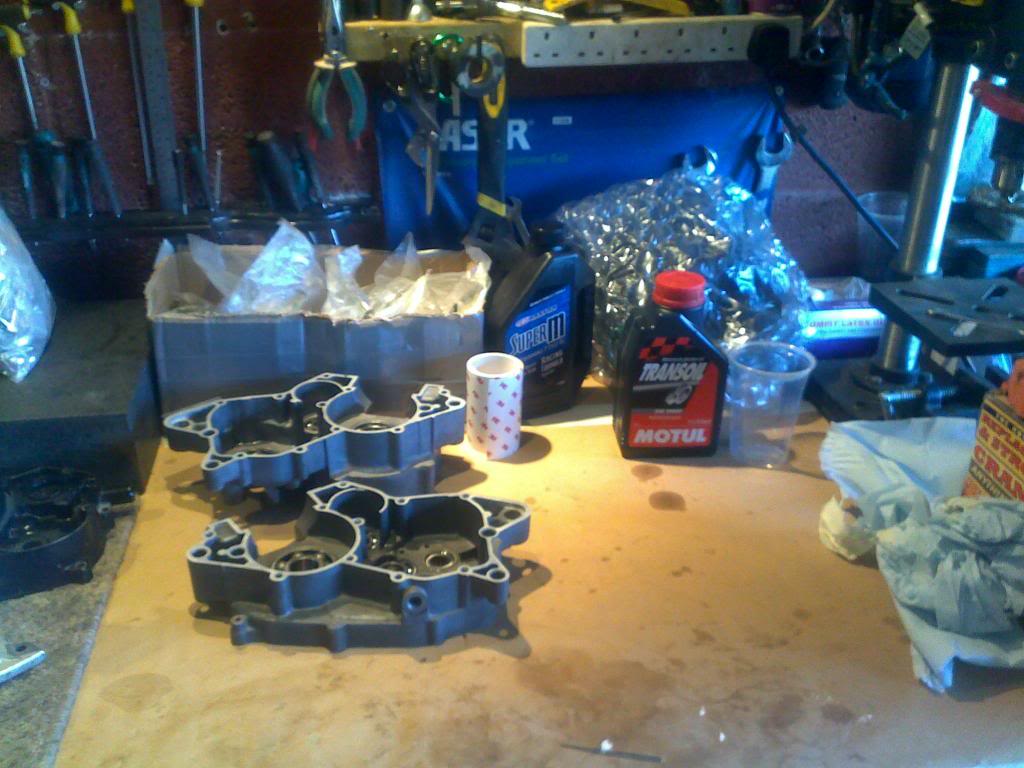

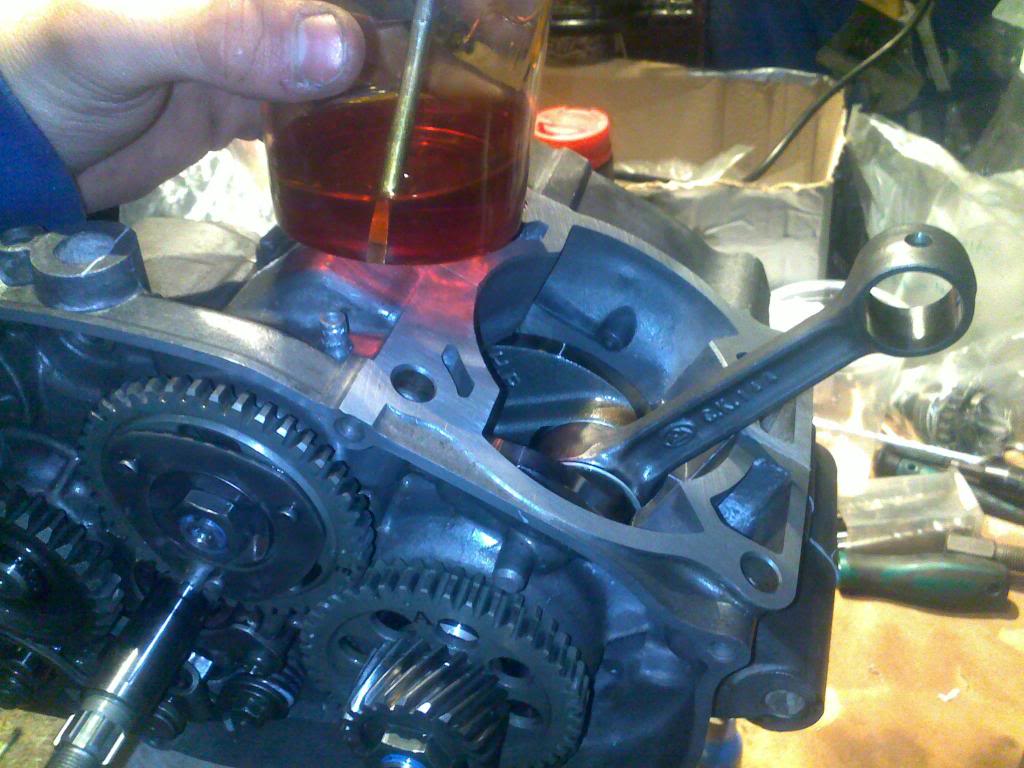

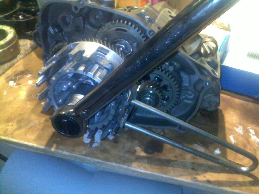

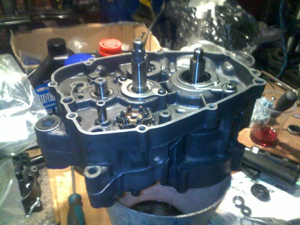

Here are some more pics of the bottom end assembly that i did last week

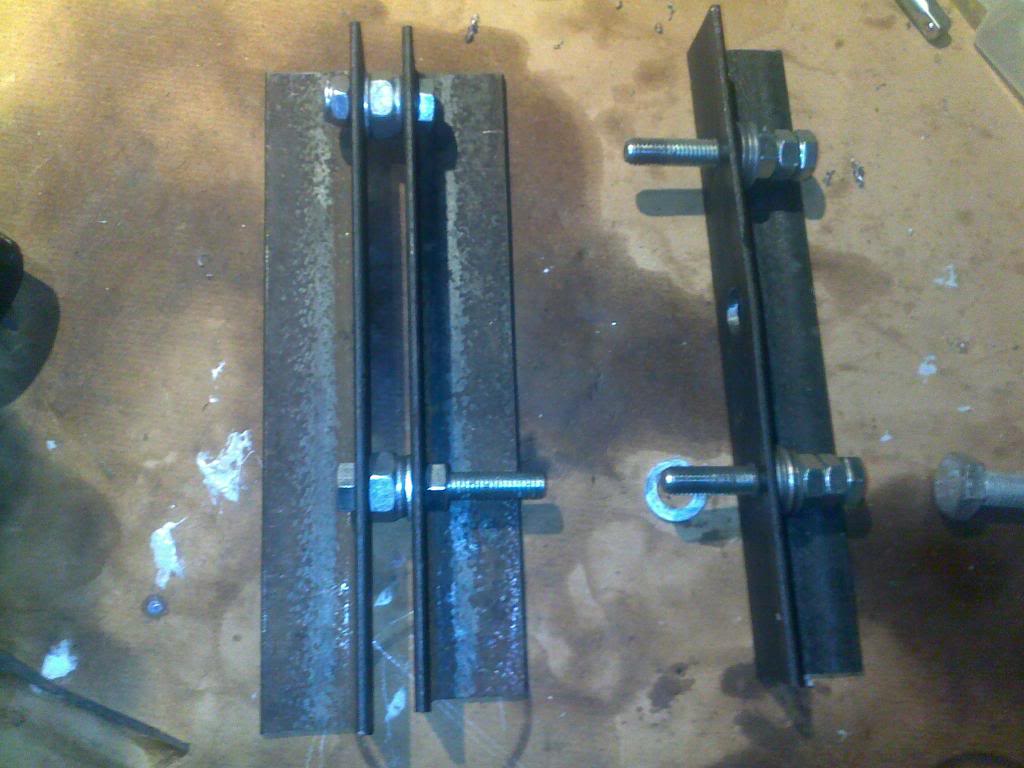

Just a couple of tools i made as i really didn't want to spend more money, left one is a con-rod holder/retainer and the right one is a crank puller

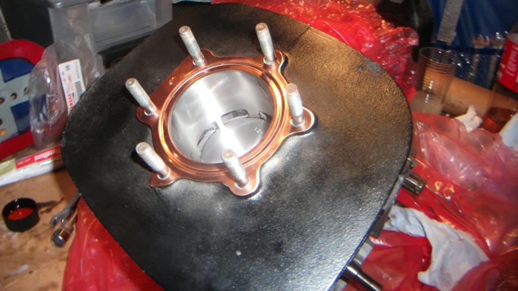

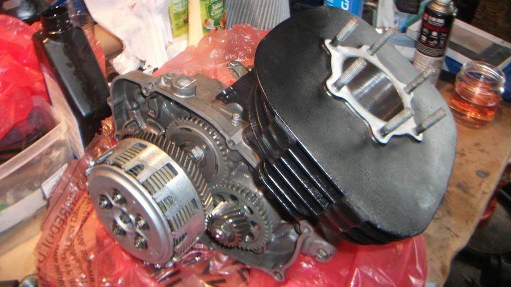

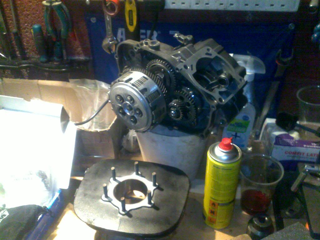

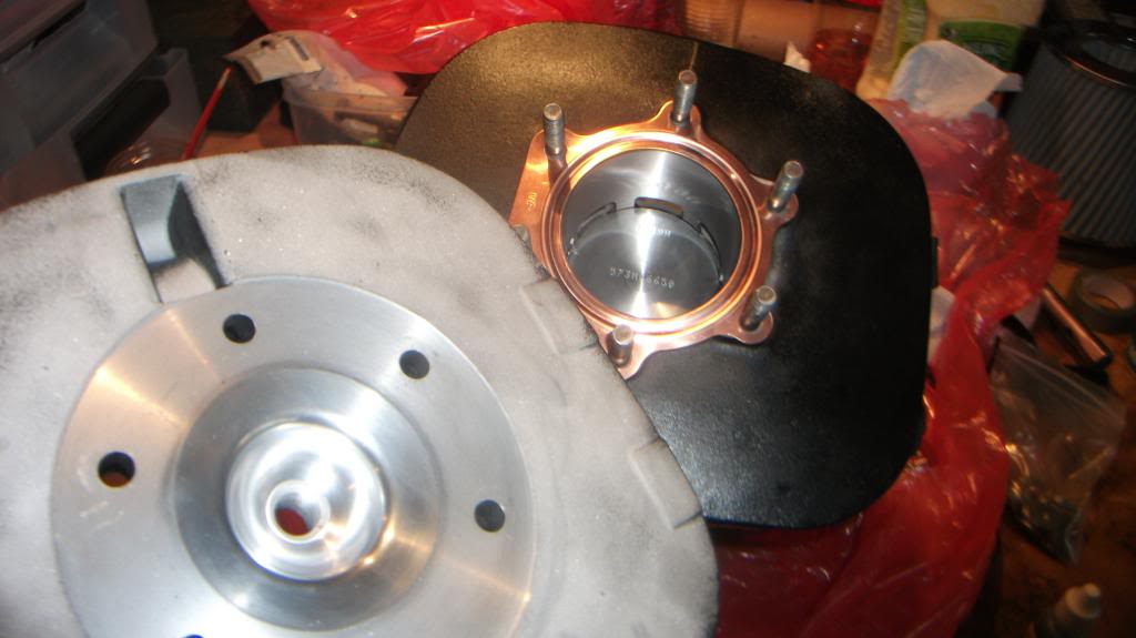

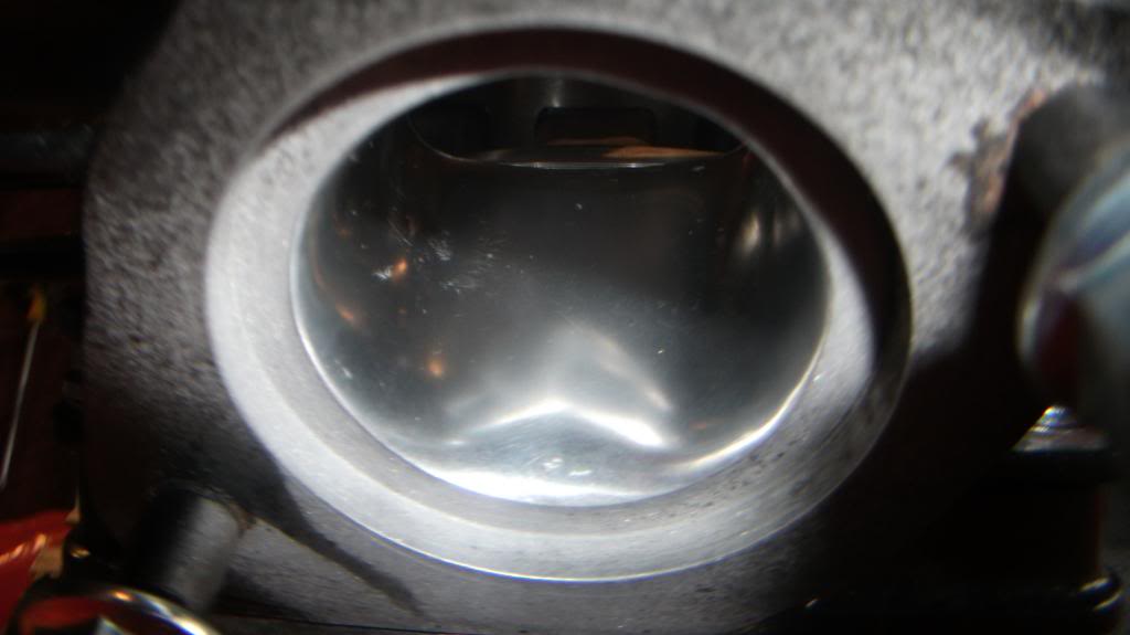

Gonna try and sort the top end tomorrow after I make myself a crows foot to torque the cylinder nuts correctly, peace out ;)

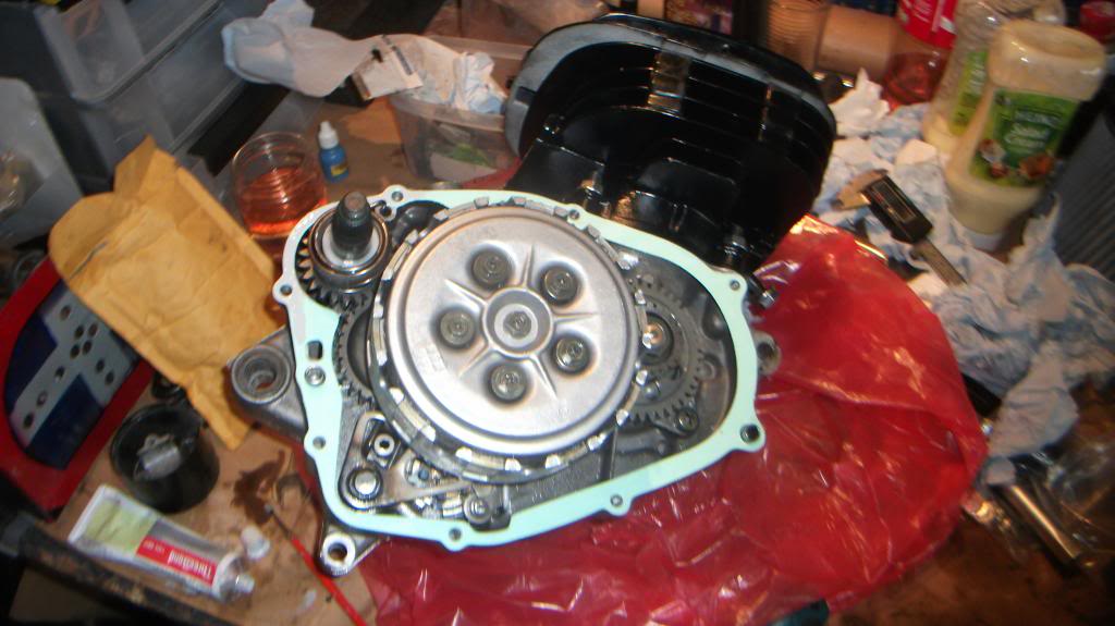

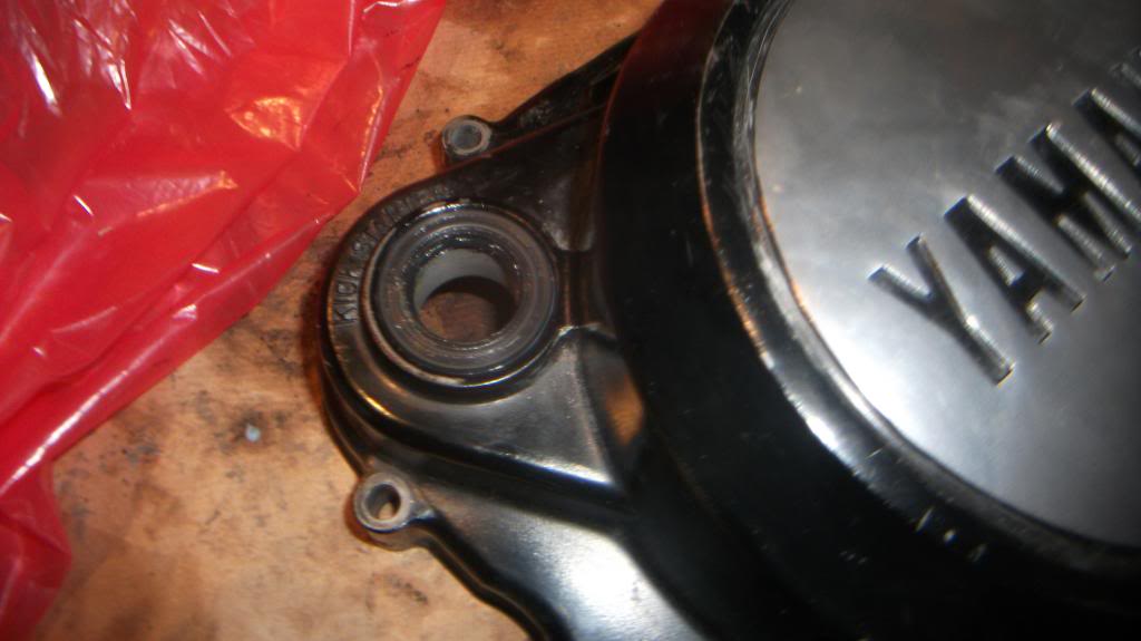

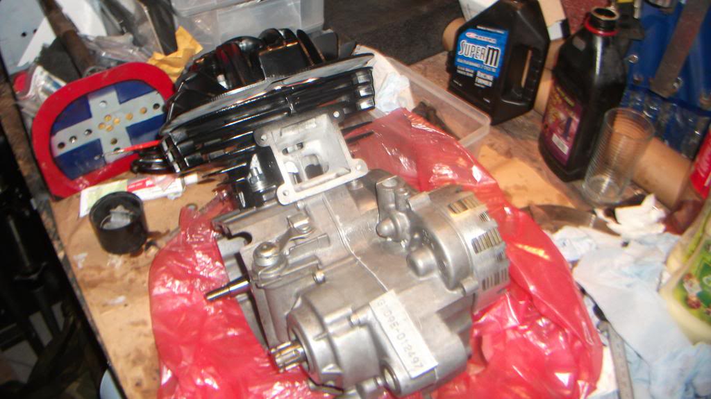

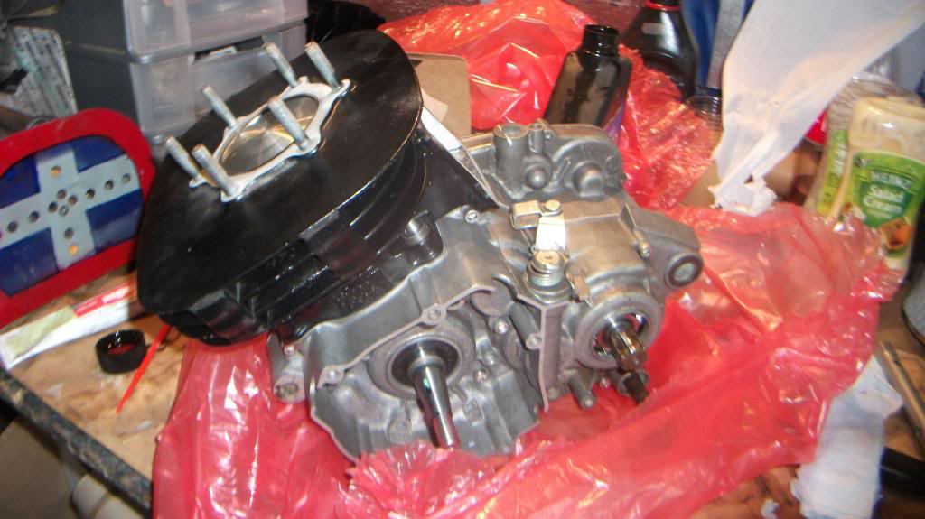

Well, I haven't posted on here in a while so I thought I would add some pics of the progress I have made as I finished the motor re-build today so here they are :
I didn't get a photo of the finished thing but i will get one tomorrow. Peace out !
Good job Phil, that light at the end of the tunnel is now that much brighter!
