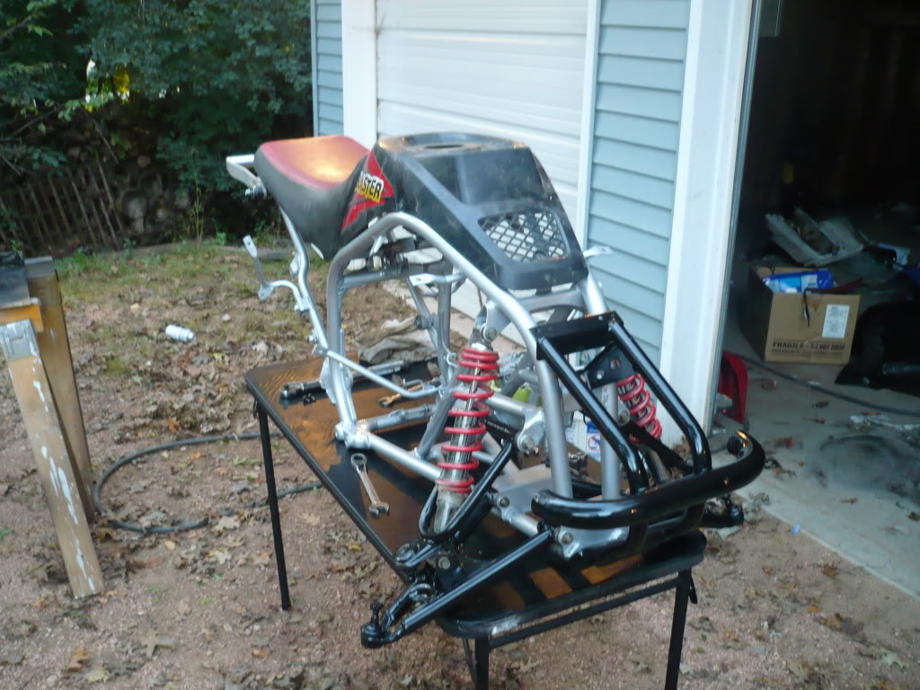

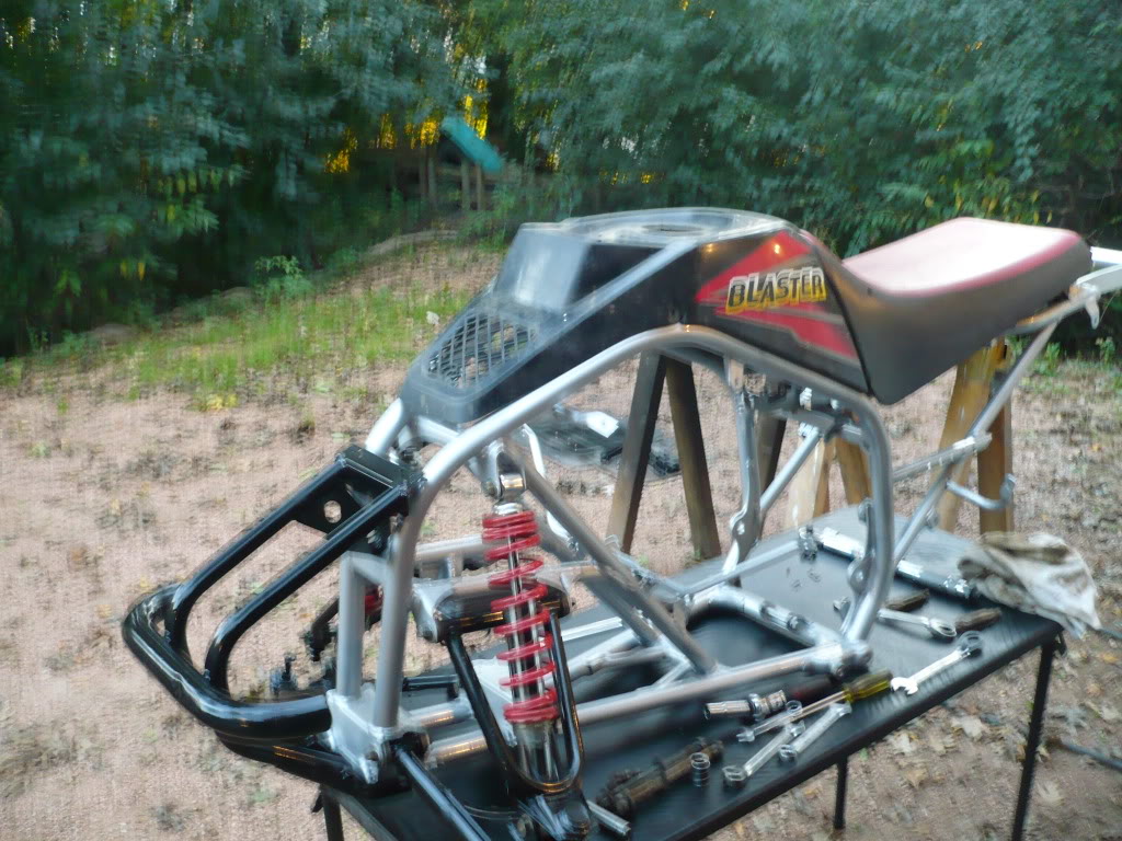

Just another tear down.
Painted the upper A-arms this weekend. Still Cant get the lower's separated from hubs.
More painting today. Hopefully get it all done before snow flies.

Few pics. I am getting there its just been so damn cold and flooding like mad lately.
