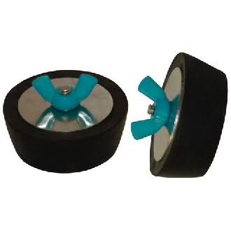

It loses because its leaking at my exhaust block. I sprayed it down with soap and there are no external leaks. I can't rule out the seals. I ordered new ones.
Ohhhh. I use a cometic exhaust gasket over my piece of inner tube, seals great, I have found that the innertube will leak if you do not use something betwen that and the flange!
i've found this style of pipe plug works better and simpler than the flange/rubber for sealing the exhaust for leakdown tests.....
Shop Oatey 1.5"Dia. PVC Pipe Plug Fitting at Lowes.com=
i think the 1 1/2" is what fit ?? measure to be sure
I pulled the needle out today and its a DGK needle. Should I get a CEL needle? Its carb parts warehouse the best place to get one?
I still cant get the exhaust side to seal. I'm going to get one of those pipe plugs for a hardware store

But leak test it before you run it please.
