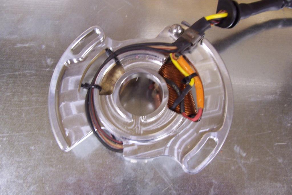

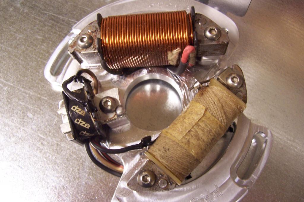

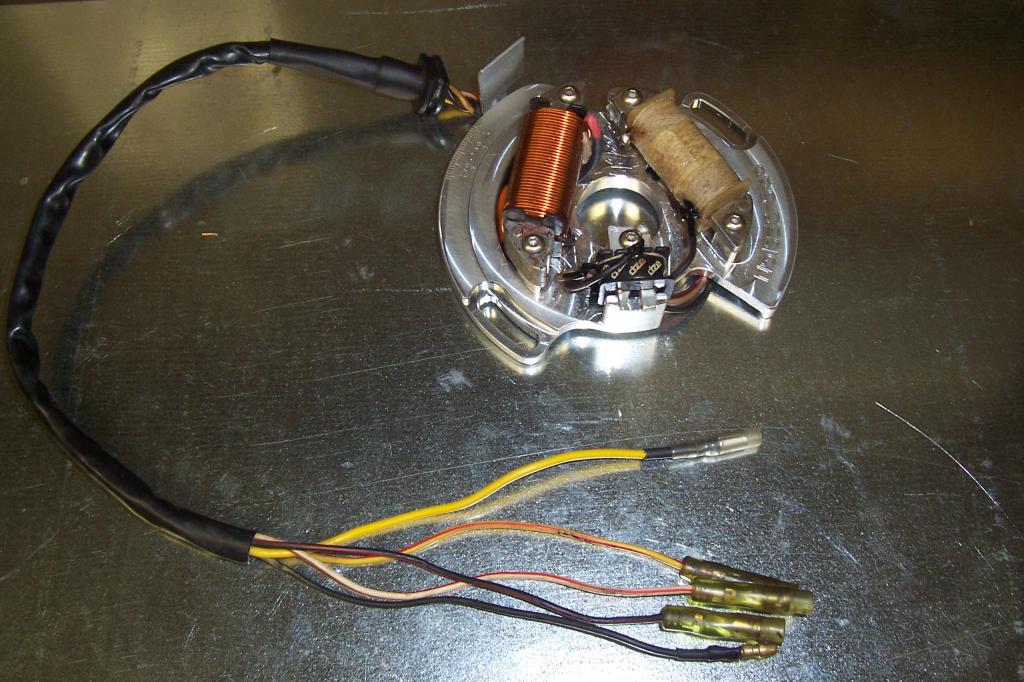

This is my stator, and in the pic you can see that the lighting coil ground is disconnect from the stator plate and ran under the coil. I also covered the wire with heat shrink.
The new yellow wire on the back.
