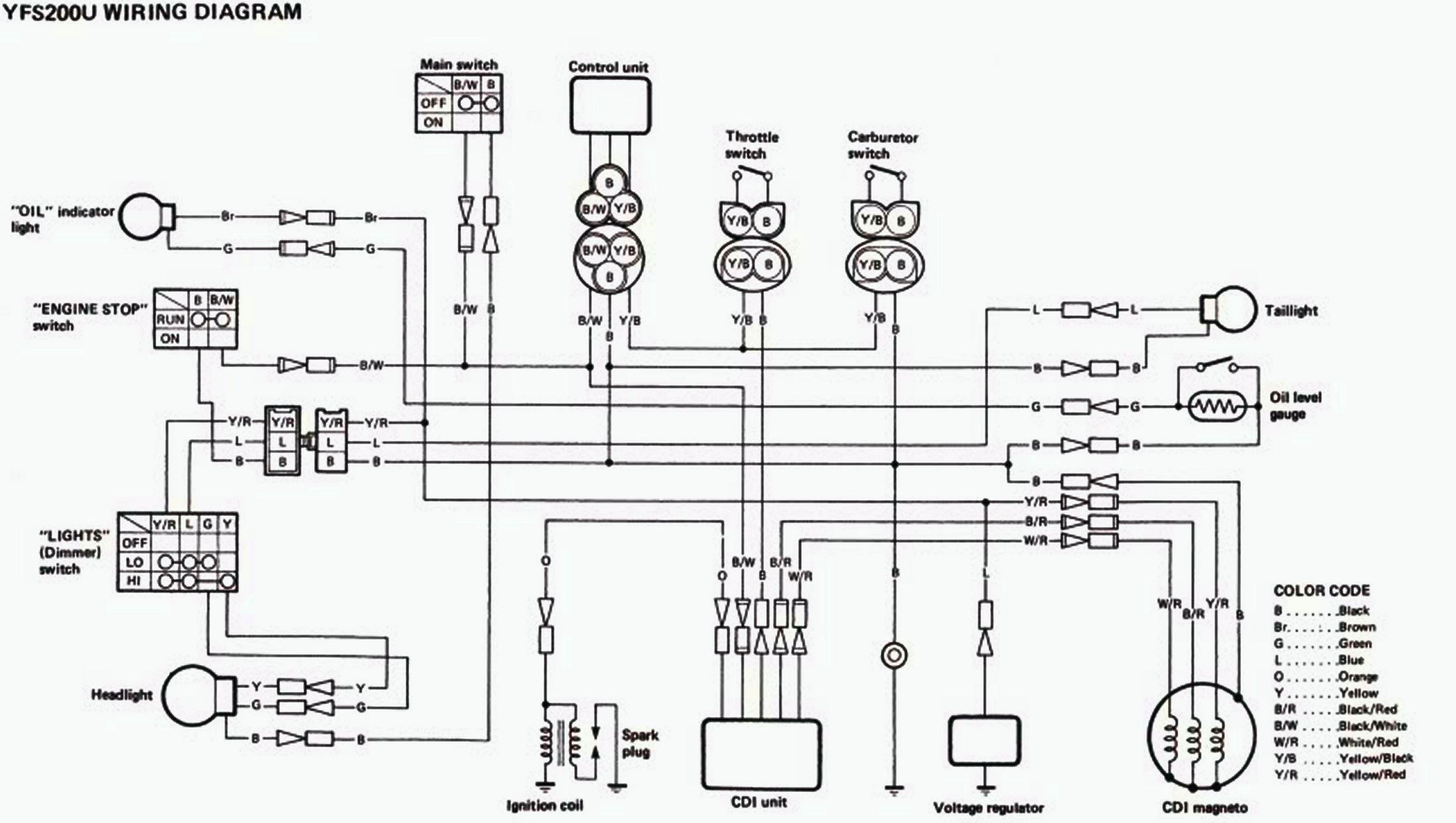

Hey, so I'm a bit confused. I have a blaster that has the harness all chopped up and the red coupler from the switch is no longer there nor is the oil injection system or the tors nor a tail light. If i want to connect the headlight, and I have the green yellow and black coming from the back of the light, and the green and yellow from the switch, i connect the greens and the yellows, connect the yellow and red to the other yellow and red, and then just connect the blacks and it should work yeah?
88-02 stock wiring diagram, 03+ is also available here...
https://www.blasterforum.com/threads/stock-wiring-diagrams.51842/
clipboard03-jpg.13688
bare minimum diy wiring with all the junk removed
