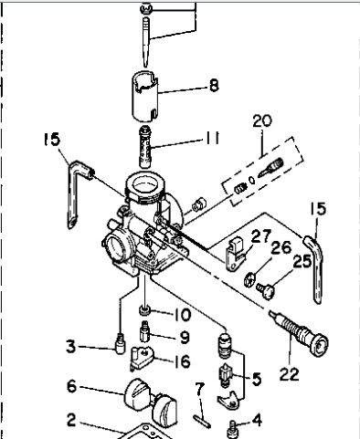

and be sure to put the brass washer back under the main jet, then slide the white plastic splash gaurd down over it
I will need to see pics of that, I have no idea what you're talking about with the washer and the splash guard....could it be my carb just didn't have them?
not sure all carbs have the brass washer under the main jet, you will have jetting nightmares if that is called for but missing !
the stock 26mm mikuni on blasters do, part #10 ................
diagram found here...........
2001 Yamaha Blaster 200 YFS200N Parts, 2001 Yamaha Blaster 200 YFS200N OEM Parts - BikeBandit.com
find your carb here, and look at the exploded veiw to verify.....
