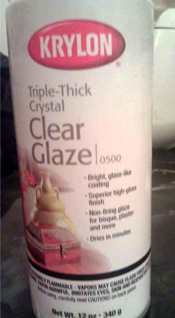

Anyways, that Krylon stuff looks like a cheap effective solution to faded plastics.

That triple thick glaze worked good for me. But if gas gets on it its gonna like melt off. Lol happened to me on the gas tank area. I haven't tried the heat gun thing yet but I will. And if u do the triple glaze, let it dry and hit it with another coat. Then when thats dried wipe rain x on it after every wash. It'll keep mud off and dirt so t stick to plastics as much
