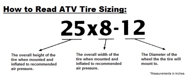

What Do All Those Numbers Mean?
Along the rim of an ATV tires lies a bunch of numbers similar to what's on a regular car tire. Knowing what the numbers mean is crucial to optimum performance and finding the right set of wheels which we'll get into for the next section.

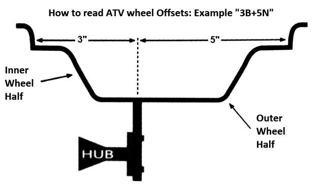

Wheel Offset
If your ATV handles stiff or perhaps too loose and you want to change how your 4-wheeler handles then Offset comes into play. Offset allows you to change the width of the front and/or rear end to make the AT handle to your liking. Check out the diagram for reading ATV wheel offsets.

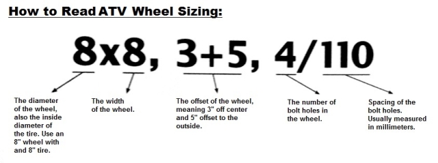

How to Read Wheel Sizing
Like ATV tires, wheels offer a bunch of numbers imprinted on the rim to help you find the right size. Larger wheels offer more power, smaller wheels give more speed. Depending on your ATV you may be limited in what size wheel is usable but you should be able to go larger or smaller depending on need. Of course, we'll mention what does not need mentioning but just in case - you'll need the same size tire as your wheel.

Wheel Offset
