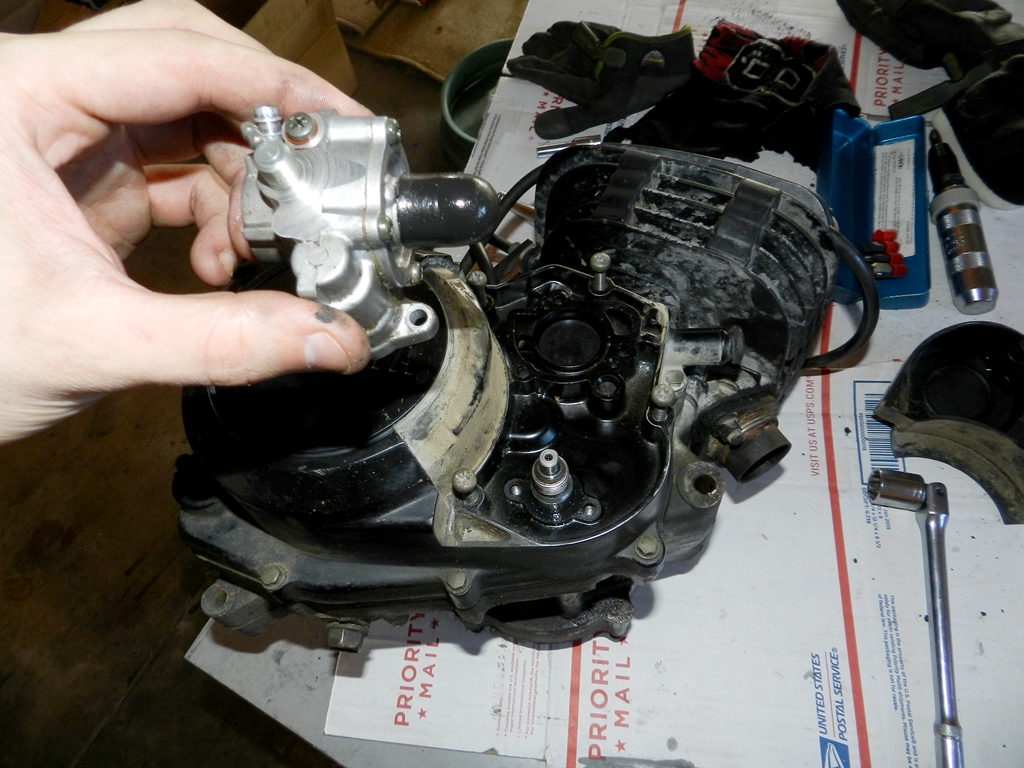

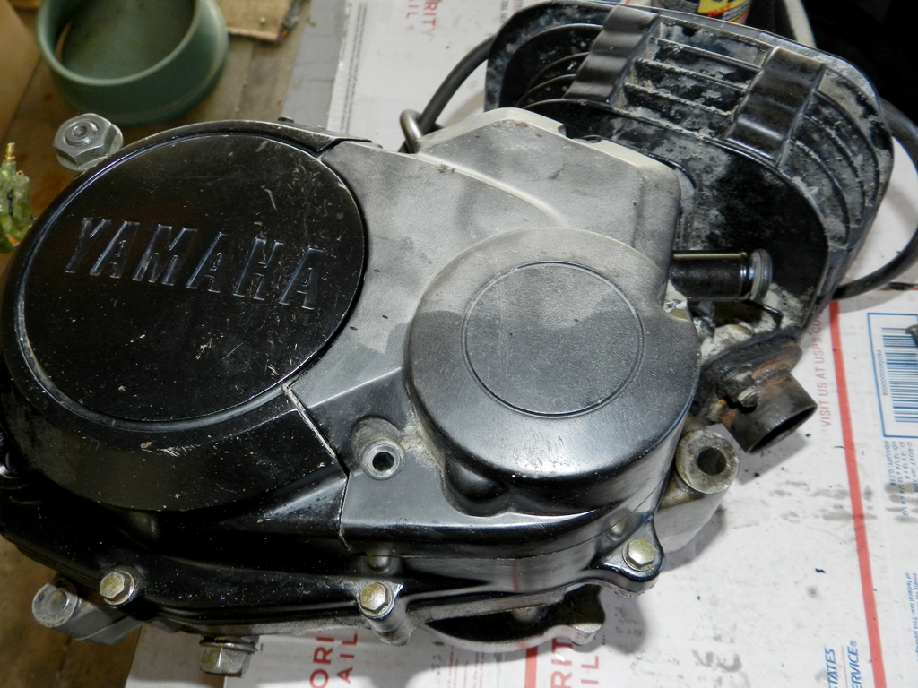

Done the oil injector delete today. Some photos.
Remove oil injector cover. 4 bolts.

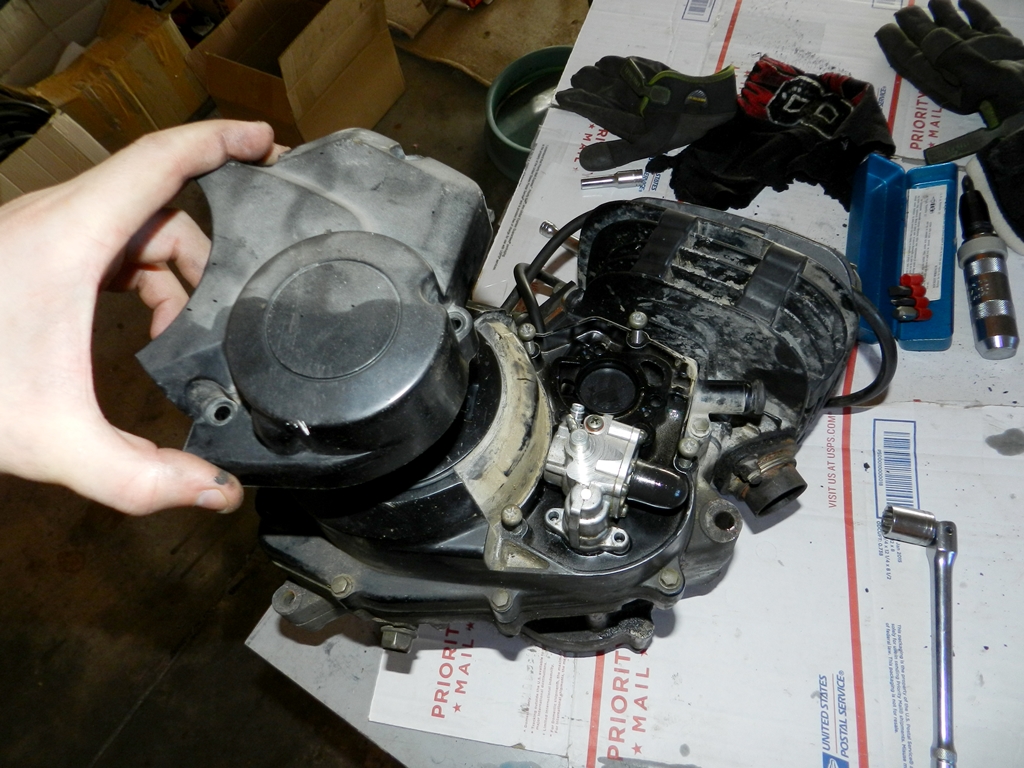

Remove the pump and the 2 hoses going to it. 2 bolts.

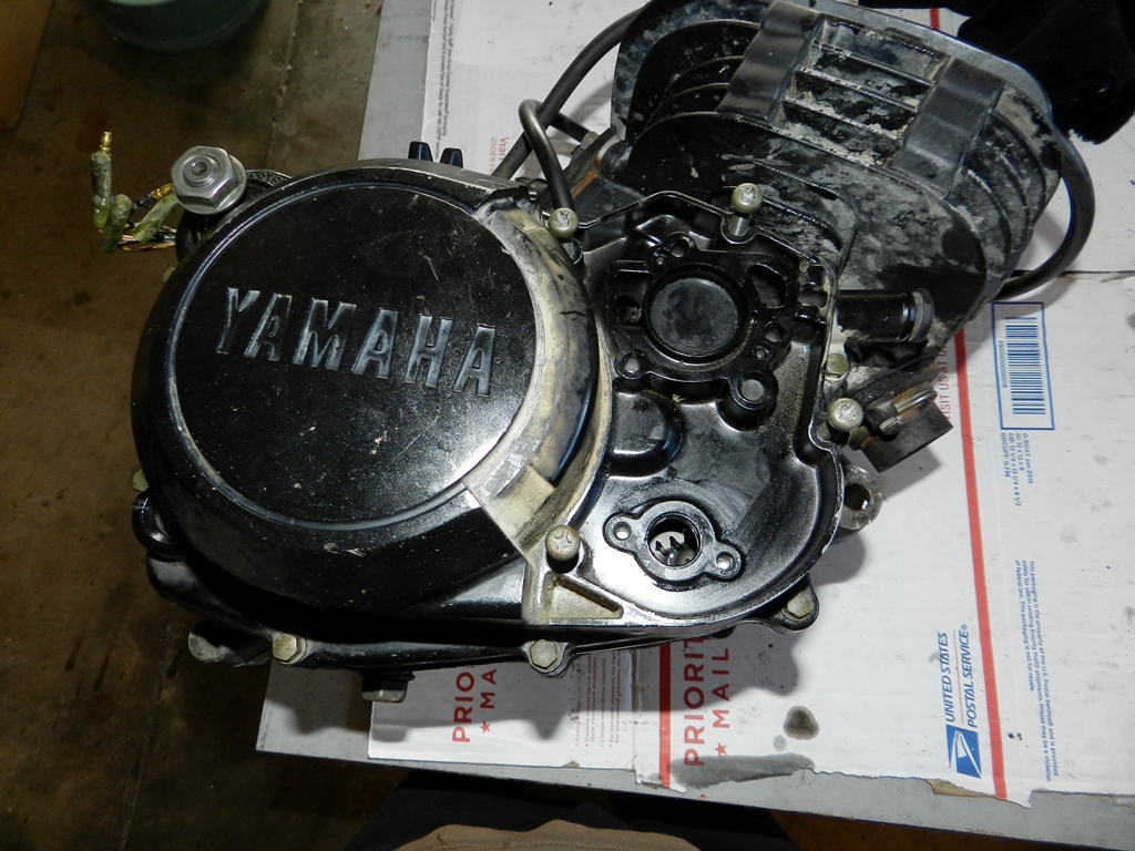

Remove the kick starter. 1 nut.

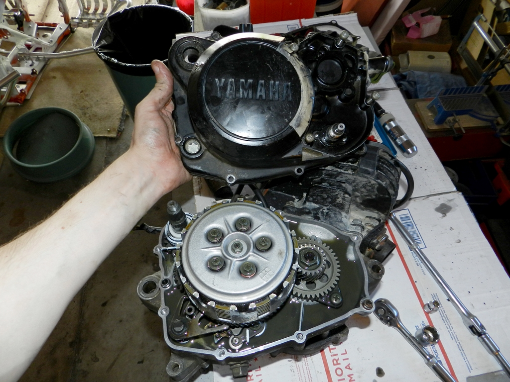

Remove the engine cover. 8 bolts. Watch out for the kick starter spring it may pop out of its hole, Is easy to put it back.

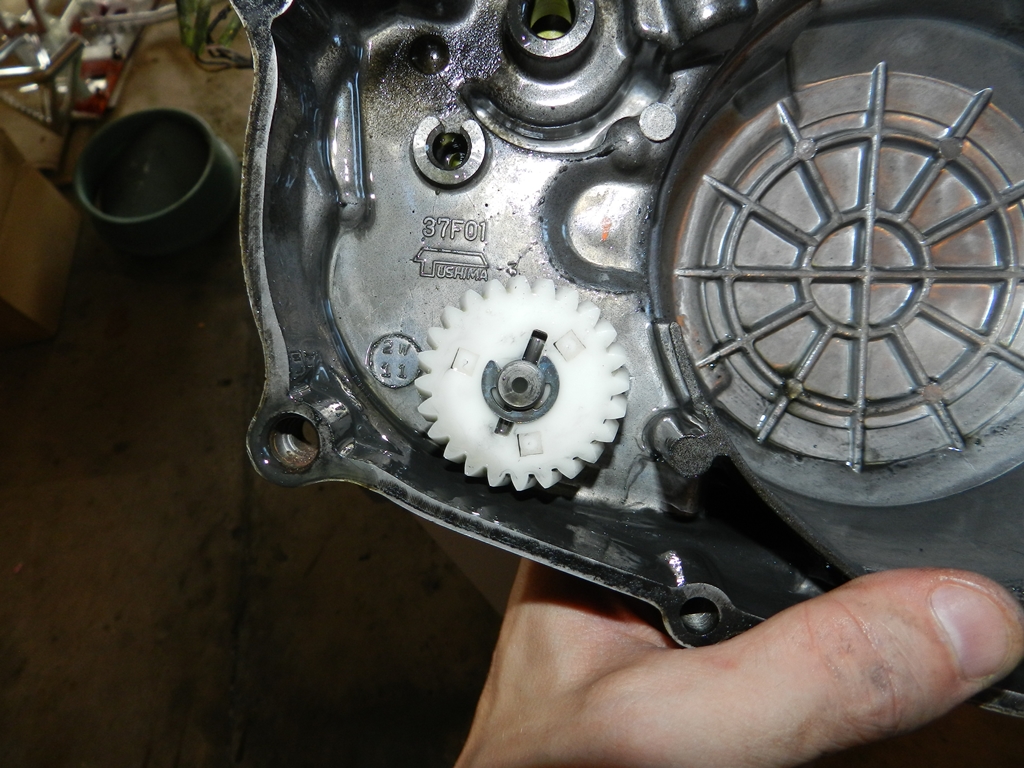

Remove the C-clip, white gear, steel pin, C-clip, shaft, seal and the gasket.
All removed.

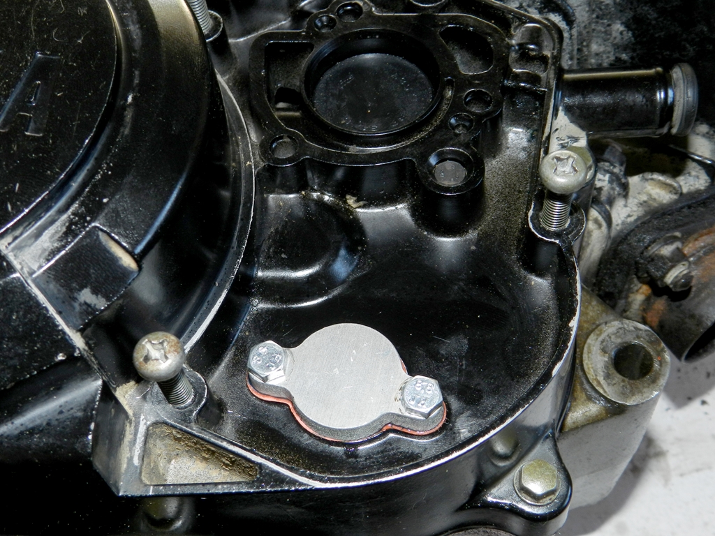

Install the engine cover back on. New gasket.
Install oil block off using new gasket and bolts. Use loctite on the 2 bolts.
Install the oil injector cover back on and put new oil in your engine. I didn't bolt it as I'm waiting on my aluminum cover to replace the plastic one.
