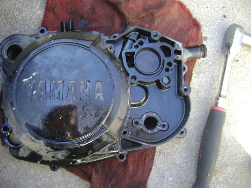

Pics for reference:

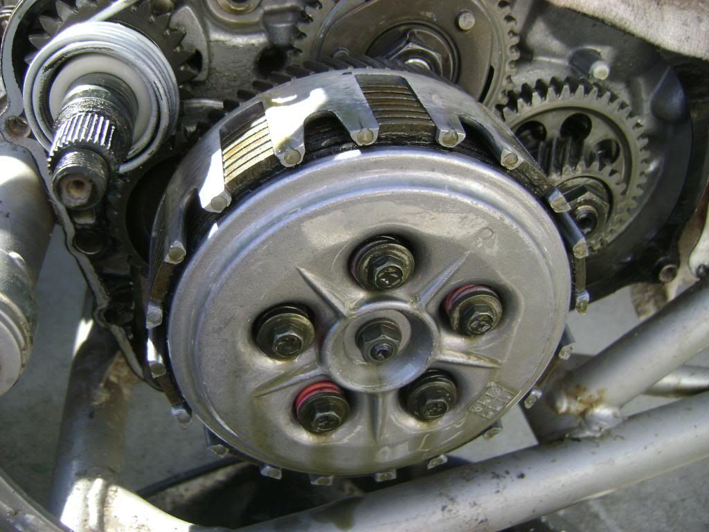

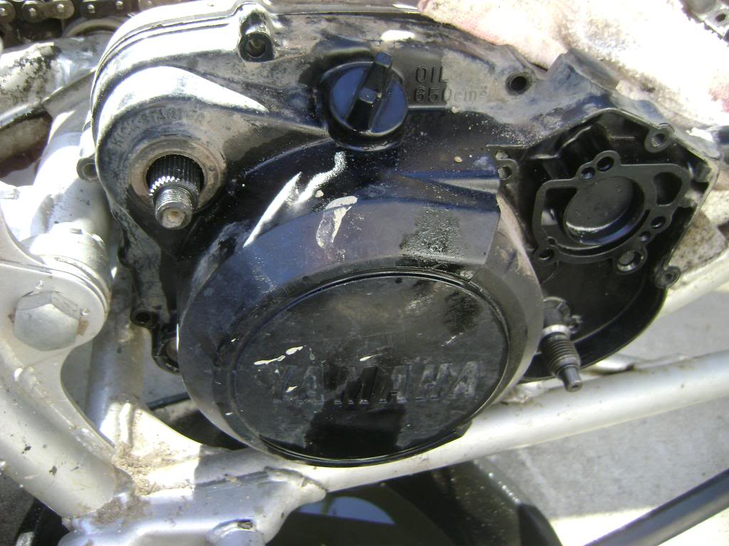

Remove kickstarter oil pump cover and oilpump.
Then remove the 8-10 little bolts holding the cover on. I used a 5/16 socket but it may be 6-8mm

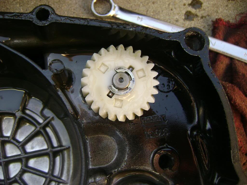

While in there you can inspect the internals for wear
Plastic gear
After removing E-clip tap with a punch or screwdriver outward from the inside of the cover and the shaft will pop out. Be sure to get rid of the seal. You dont want that to fall inside the case.

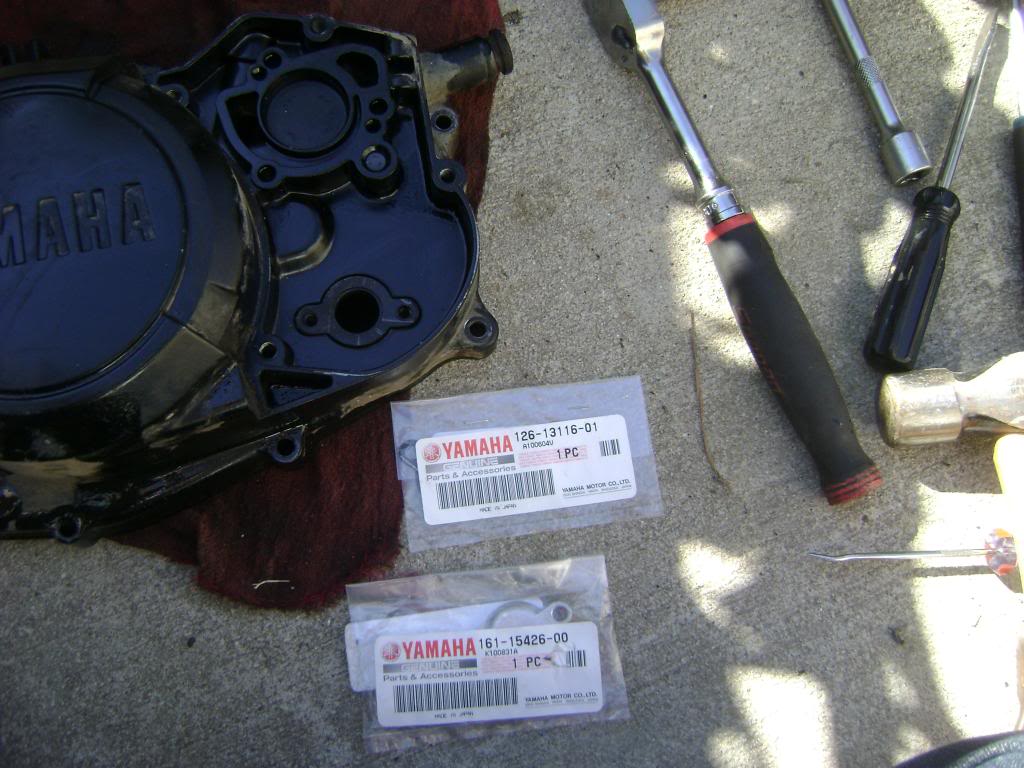

Part numbers for reference be sure to replace case gasket

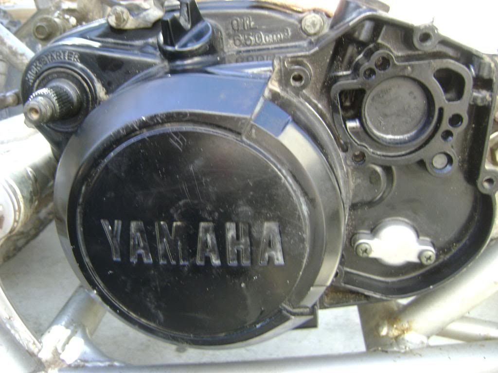

Reinstall in reverse order. Dont forget fluid..

GOOD JOB ON THE PICS. GOOD EXPLANATION. AND HOW IN THE WORLD DID YOU FIND THE PART NUMBER FOR THE FACTORY BLOCK OFF PLATE?
Get the part numbers from the bags in the pic there, then go to a local quad/bike shop and ask them to order them. Mine cost about £15. Or vitos in the USA are pretty speedy and decent priced
That seems like a lot of work & waste of money... Thanks for the info though! But I'm just gonna stick with the 2nd option and just remove the gear and plug the tube to the carb, it's cheaper, easier, faster, and just as effective
