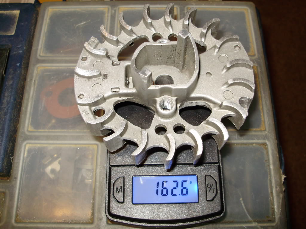

Here's a pic of a stock CY 23cc flywheel:
Here's a thinking outside the box extreme lightened one:
What effect did it have? Bad idle- had to raise it.
Uncontrolled wheelspin- could be a + or a - haha
wheelies, 60mph on stock gears (among the fastest on the planet), and a rpm counted verified 22,000 rpms (among the highest ever achieved) :)

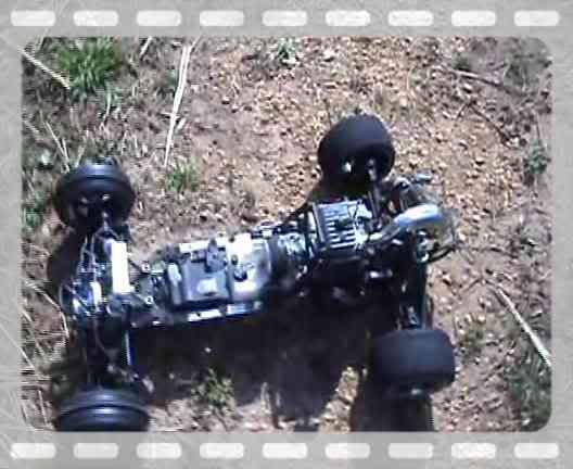

hahahaha that is AWESOME paulie!! how 'bout a vid of that lil bastard going up the road??
I also lightened the cutch, clutch arm, and piston.

OMG PAULIE THAT IS AWESOME!!!!! how fast does it go? im guessing like 70-80?
About 60 in the vid with the stocker gears (17/57's)
I also have 19/55's and 20/54's- which would prolly pull 80+
The problem is finding a spot to wind them out and controlling it at that speed.
