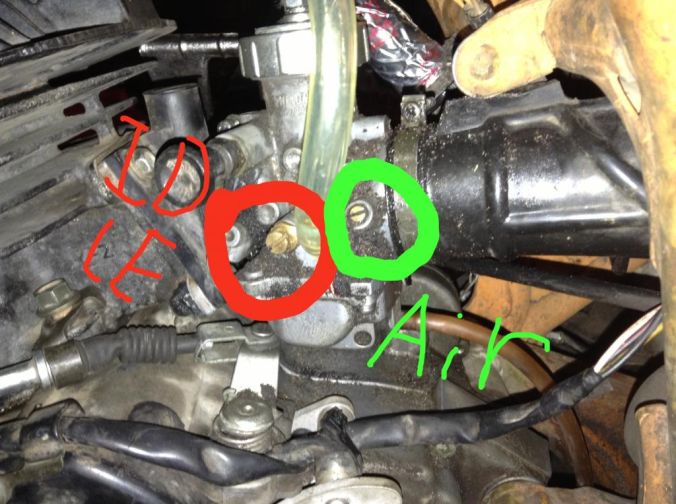

the leak is coming from the drain hose on the bottom of the carb, also is the pilot air screw and the throttle screw the same? SO after I clean it i can get it tuned just right, i know the manual has a certain range but I dont have a Tach, do you just listen by ear? and if so what should sound right? or what am i looking for to be a good idle or mix?
the idle should be slightly on the fast side. and sounds like the o-ring in the carb is worn/comprimised my friend but do a good thouro cleaning with carb cleaner and a throwaway tooth brush also be shure to write down the number markings stamped into the jets for future reference should you wanna change anything about the bike ok :)

Clock wise richens up the idle mix, only the beginning of the needle will notice.
Adjusting the air is no substitute for looking to see what jets are in the carby.
You really should do a leak test.
If you are intent on fiddling with the air screw you should read and follow the following.
Idle adjusting.
Start with air screw 1.5 turns out.
Set idle screw so that it has some sort of idle. With TORS it is the big screw under seat on top of unit. With no TORS is is the brass screw midway down carb body.
Warm up motor and then set idle screw for a faster idle, 2000rpm+
Adjust air screw either way to get the fastest idle.
Adjust air screw a little at a time leaving 10 secs or until the motor to responds.
Re adjust idle screw for desired idle .
