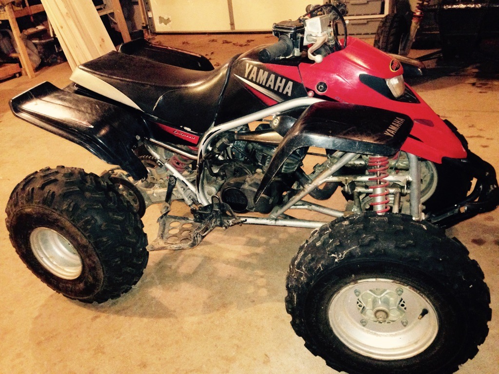

Name's Greyson and I had a 1995 Blaster growing up, blue with yellow wheels. I sold it when I went off to college and missed it ever since. Fast forward to last night, I found a 2003 on Craigslist for $450 so I nabbed it and never looked back. Certainly don't have space in the garage for it so I'm working on that part. I have some experience with older yamaha motors like the enduro series from the 70's, but nothing this new. The TORS system is already annoying.

While you're here...this sound like a TORS problem? Symptom matches what the PO said was wrong with it: I got it fired up today for the first time since I picked it up. I think I certainly have a TORS problem. Quad will fire right up and idle. Piston sounds nice and tight, no slap. If you give it any throttle at all, it bogs and won't throttle up at all. Literally all that happens is it riches up, spits and fouls out. I cleaned the carb well and put in some new fuel and was getting a nice spark before firing. I'll start up a new post for the problem, but it looks like I'll have to sort the TORS sooner than later.
Rock on, so splice the black/yellow under the hood, just disconnect the tors plug at the carb.
I guess this is just temporary to see if the problem. It would be recommended to rid the bike of the tors unit and get a regular replacement carb cap and remove the switch from the throttle housing after?
