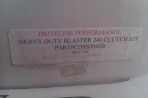

Driveline Performance 240 HD !!

it is confirmed, i did order the hd 240 kit, and did so to allow me to build my motor up as far as i'd ever like to in the future,
but as stated, either driveline product is sufficient
