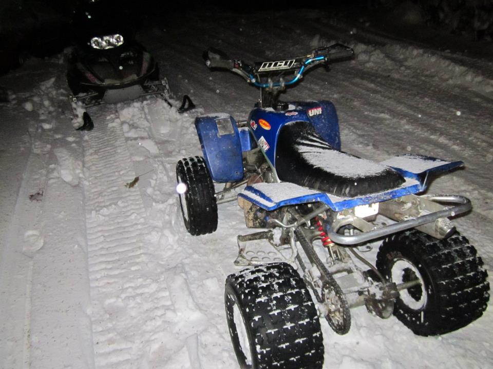

No, but I have run them concurrently:
Yeah, it takes better tires than these and almost NO tire pressure to deal with snow.
At least the Blaster floats on snow better than my old Raptor did.

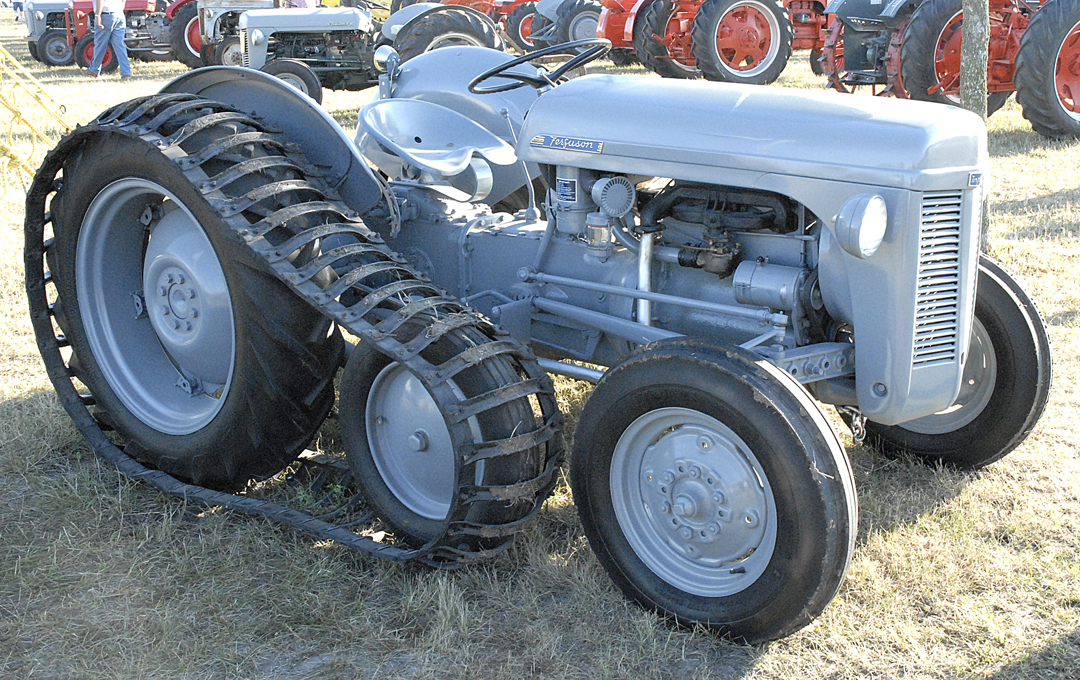

When I was growing up my grandfather had "halftrack" conversions for his tractors like these:
With these tracks my grandfather would go back in the woods with 3-4 feet of snow on and pull out sleds with several tons of wood.

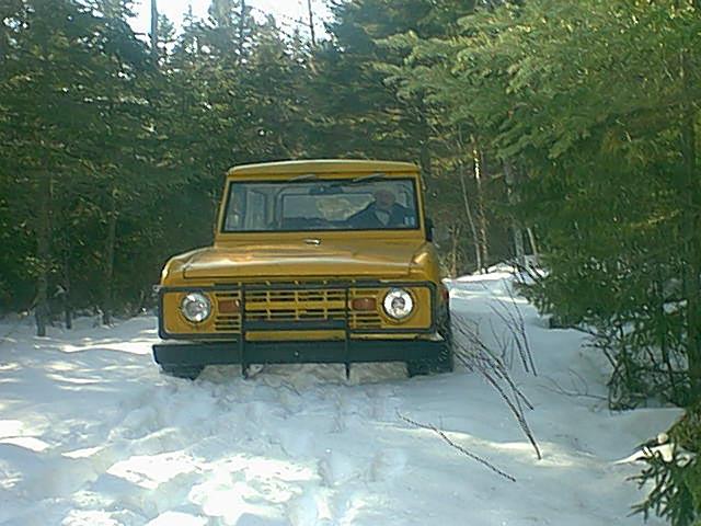

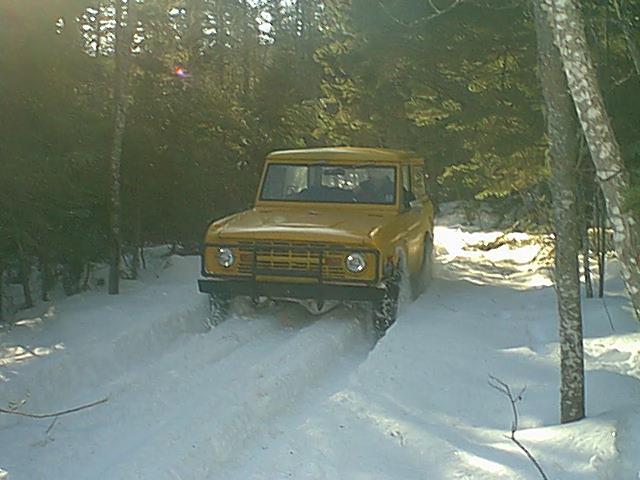

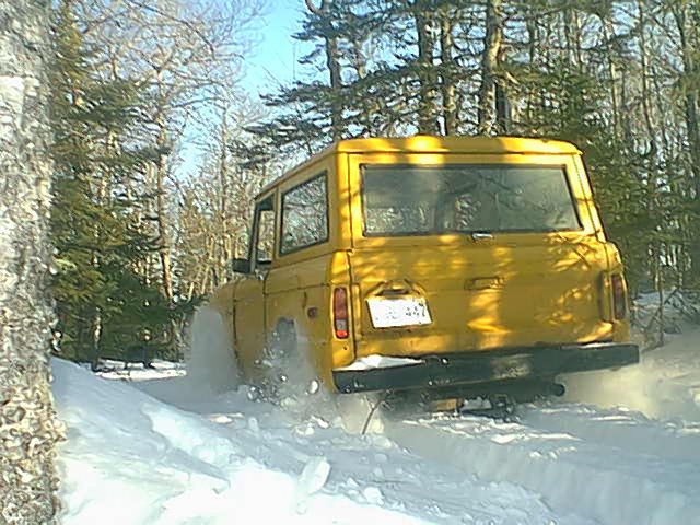

This is my old Bronco making it through over 3 feet of snow.
I am running 33" in tires aired down to about 5psi and chains on all 4 tires:
This snow is so deep I am at least a foot off of the ground.
You go slow and easy because if you spin, you dig and bury.
Faster is better if you can keep control.
Of course when you stop moving you back up and "give it" again!

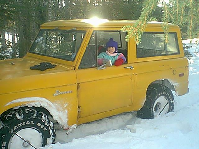

We start them off young here...

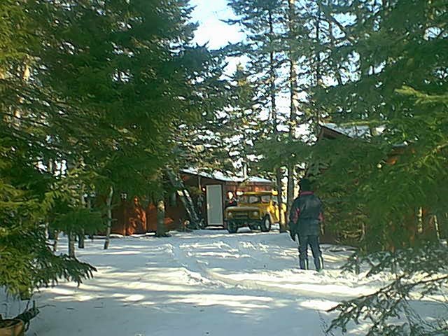

Ahhh, the little cabin by the lake.
It was actually colder inside the cabin than outside.
