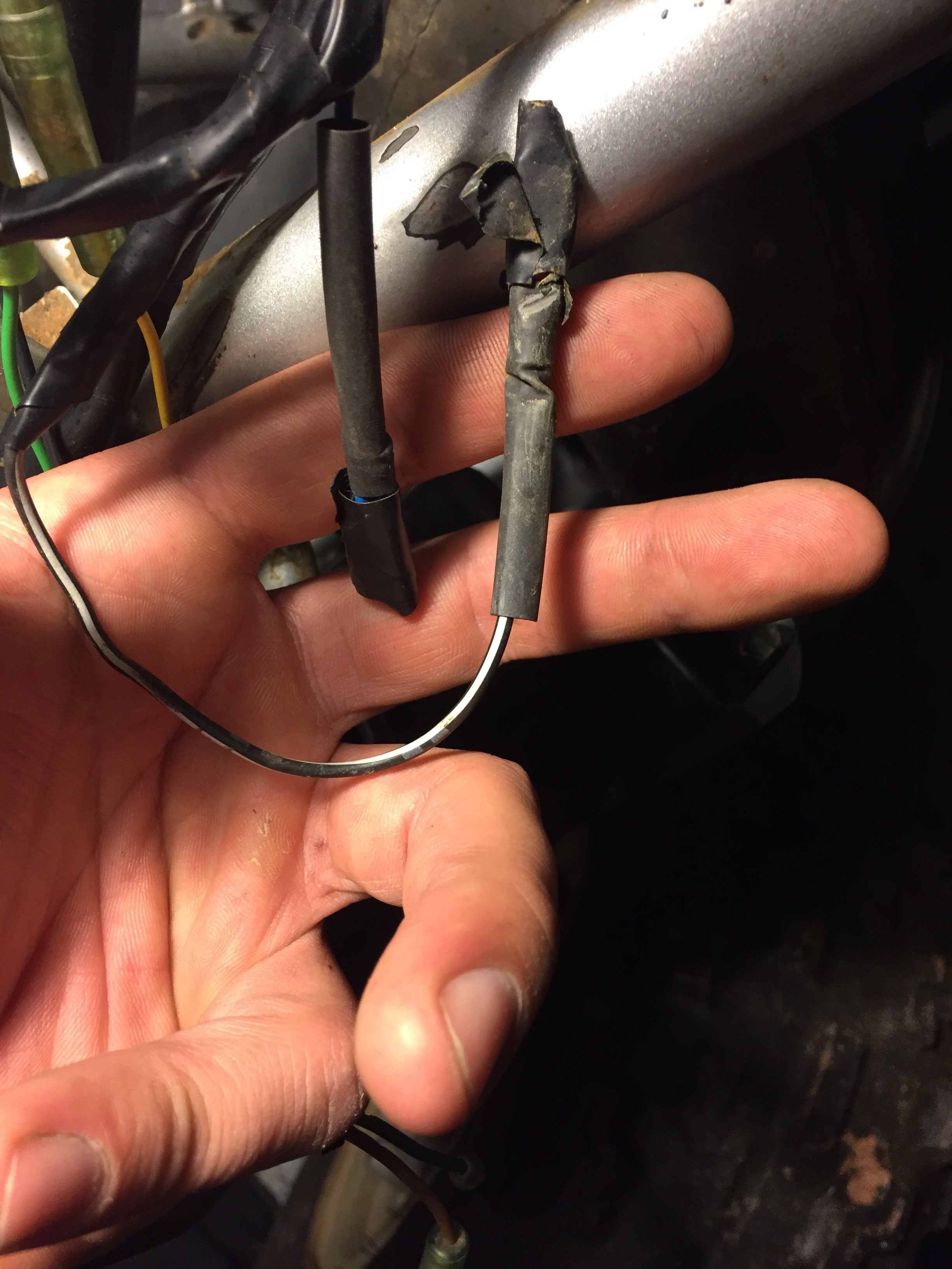

The orange wire I believe is for the brake lights it's with a brown wire there both not going to anything
It has no key either .. So the tors is just supposed to be those two wires off the tors twisted together ?

I've since joined those two wires together ! Is the gap on the slide inside the carb okay ?

not sure what you're showing in this pic below, nor if it has been addressed in this thread ?
but no black/white stripe wire should be connected or touching any solid black wire (ground), or bare frame.
the only place a blk/wht stripe should even be near any solid black is at either of the 2 kill/key switches, and connecting them by closing the switch to off, grounds out the CDI and prevents starting
do not connect that blk/wht wire to anything but a kill/key switch, or tape it off better so it doesn't touch the frame either

So if the cdi box was being grounded out would it still have spark ? I have a nice blue spark 125-130 psi new reeds rebuilt carb fuel spark and compression I thought those were the big things with two strokes

no, it would not have spark if those wires were your problem.

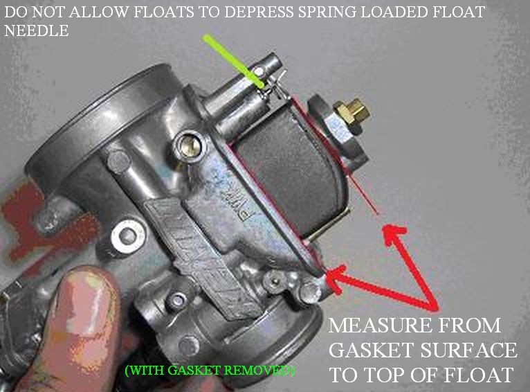

Float level ... How does It look ?
nobody can tell you how the float level looks, especially in that position
float level must be checked as explained and shown in the link above, but i'll post it again.....
http://www.blasterforum.com/threads/float-heights-and-how-to-adjust-them.50565/
measure float height like this......
holding the carb on a slight angle, not allowing the floats to depress the spring loaded center needle, just rest against it, measure the float height, from carb body with gasket removed, to top of float like this...........
