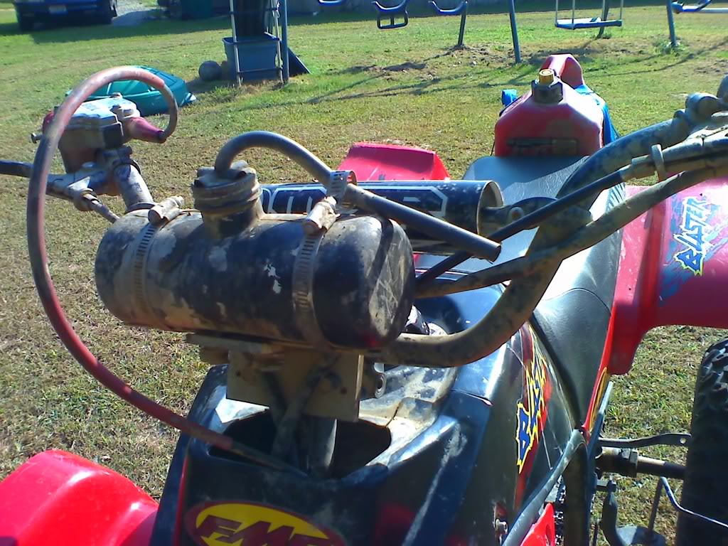

my auxillary gas tank

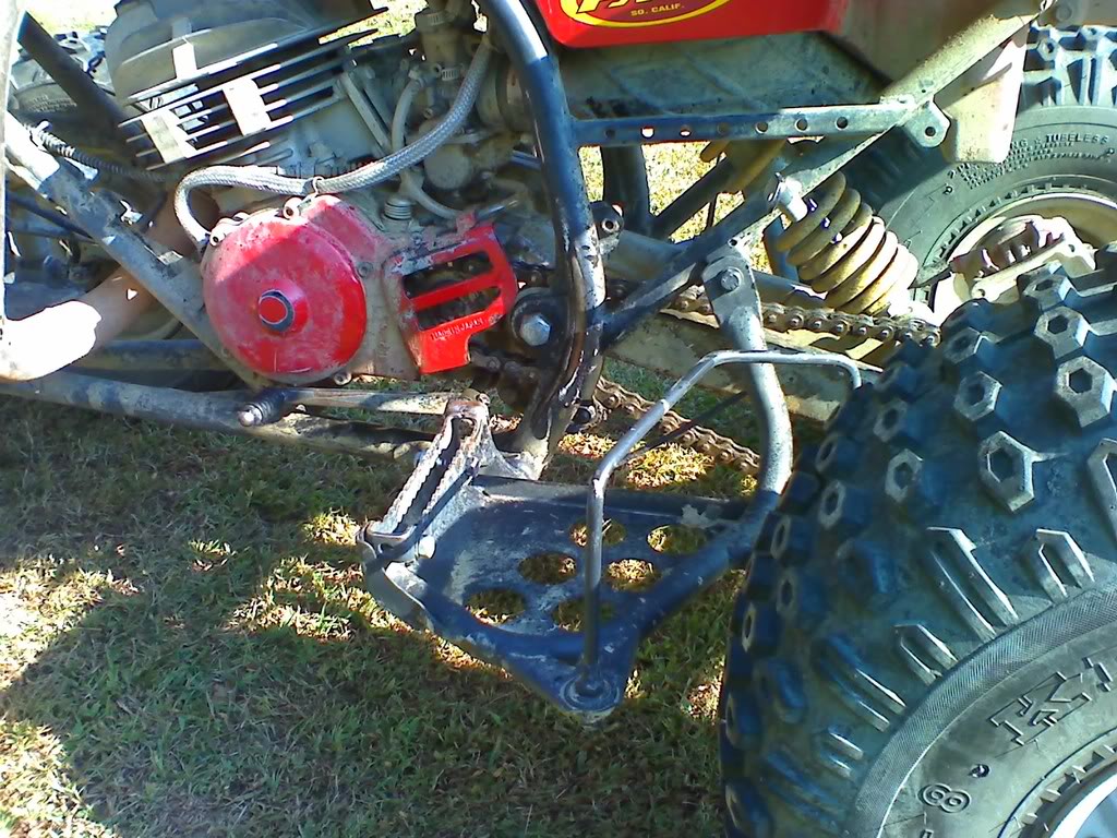

new heal guards and worn paint

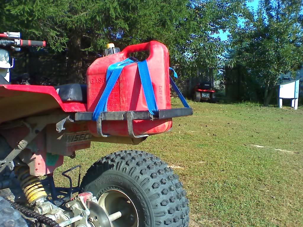

modded my custom grab bar to hold an extra can of gas

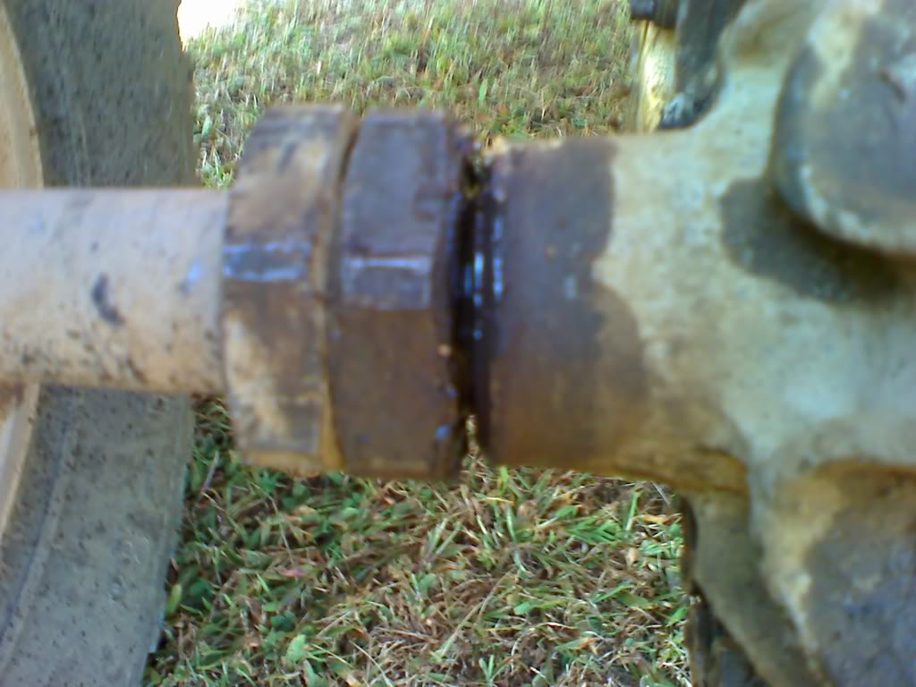

axle nuts backed off

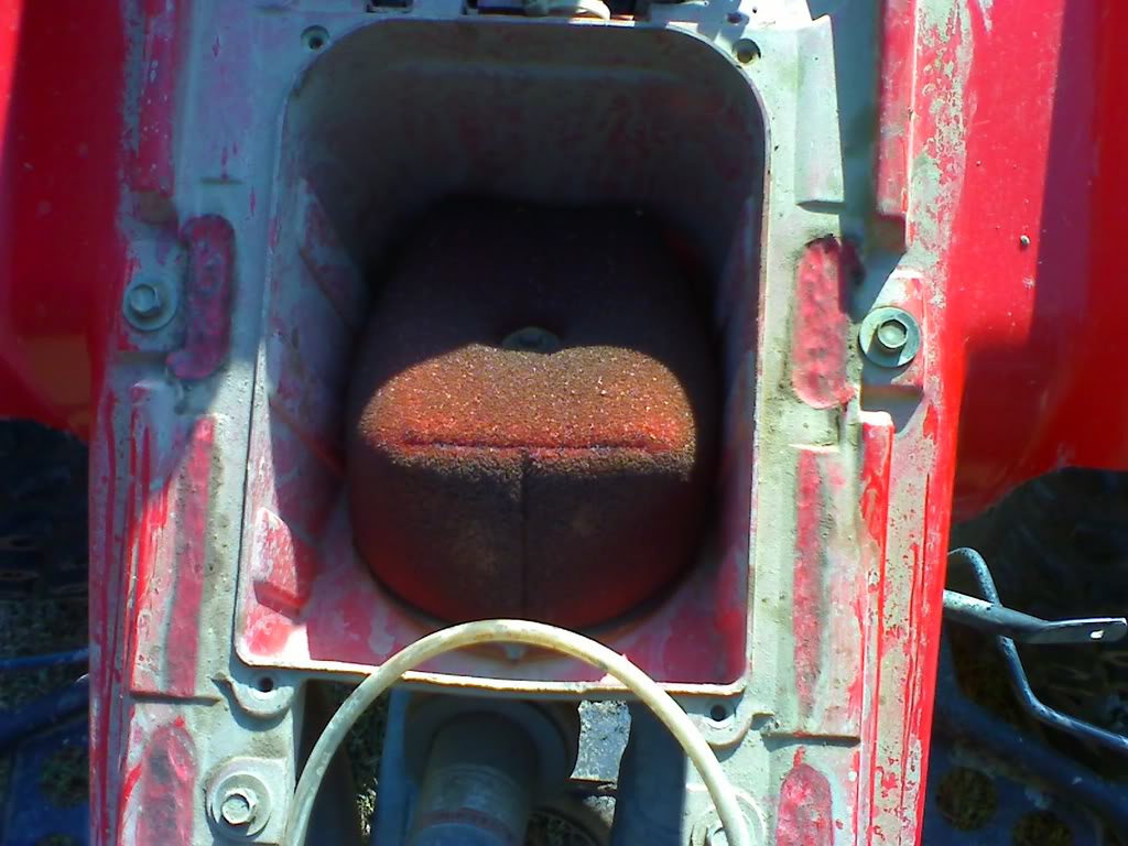

glad I got rid of the K&N and got a foam filter
my next mod =)) hope everybody likes foam
Well I havent ran out yet, but you know that feeling you get when your far from your truck and you have to put it on reserve. I'm trying to avoid that. since I got it ported it uses more gas and I wasent sure yet how much I was going to use. So I just wanted to play it safe, the ride I went on was a 27 mile loop and that could be a long way to push it. Now that I have the engine broke in all the way it is doing alot better on gas than it was while it was still tight. In 27 miles I used all the aux tank and got the normal tank almost down to res. but I havent had to break out my fuel can yet
